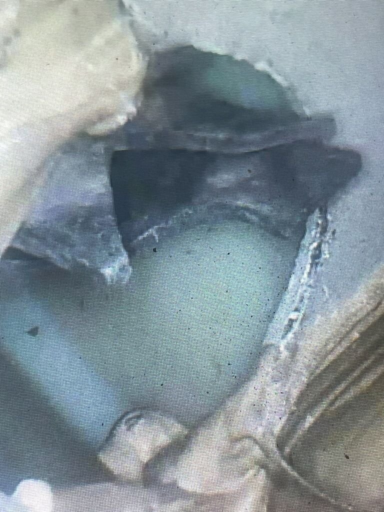

Thanks to the OP, @No Quarter and others who contributed to this thread, my Indy mechanic was able to successfully cut the duckbill in my 2009 XKR. Here's the "after" photo taken by the camera on his endoscope.
I never had AC condensate leak into my passenger compartment, but I did worry about it. Now I have one less thing to worry about.

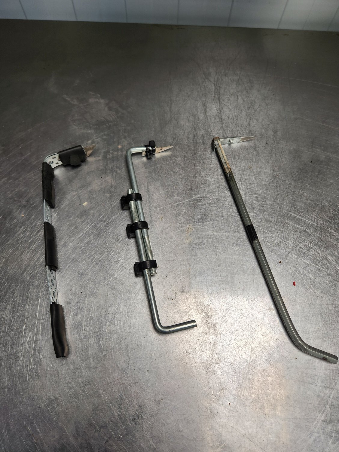

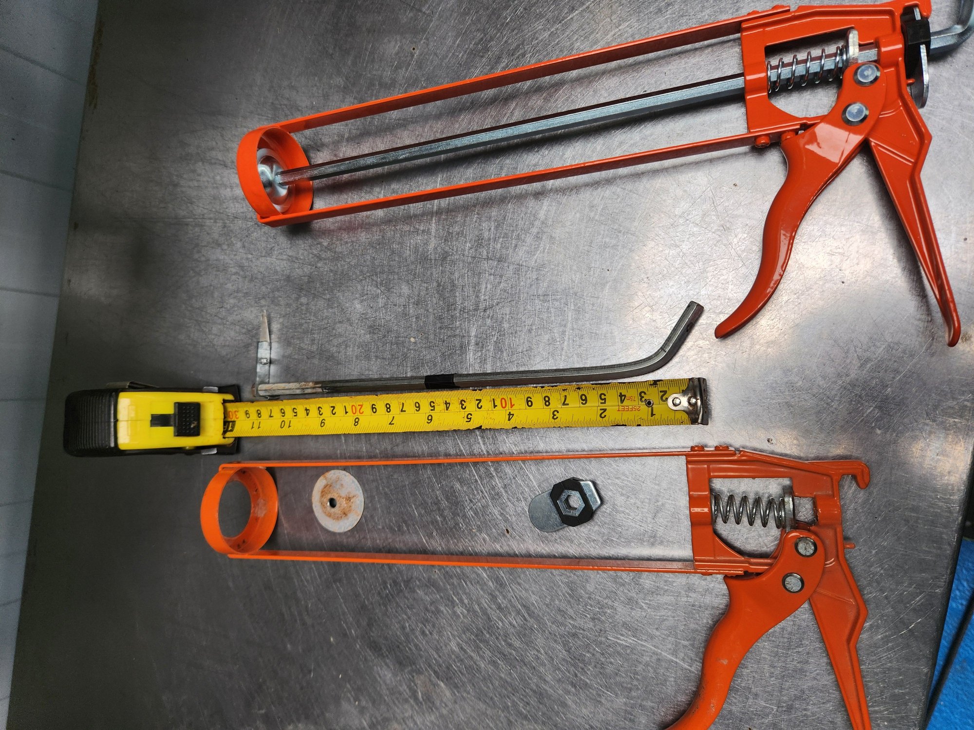

Hi all, 2 questions about the duckbill. After following the threads and expert advice on this forum (which is brilliant by the way), I manufactured a bladed tool to reach the duckbill. I have a 2007 XKR from new, and after 18 yrs have the duckbill/wet footwell problem. I haven't sliced it off, just opened up the slit on the duckbill. My first question is that having run the aircon full blast for 5 mins in the garage and then turned engine off, should there be water on the floor if now draining properly? Or does the a/c need to run longer? I'm in the UK and temp is 20 degs C. Happy to go in and slice the duckbill off now that I can find it easily. As an aside, I had several attempts at making a bladed tool (pic attached) and the one on the right was most successful - repurposed the plunger bar from a sealant gun which has the benefit of a threaded and and nut to hold the blade). My second question relates to a 2013 F-Tyoe 3 litre V6 that I've also had from new - should I expect to have a similar duckbill problem at some point? Thanks for your help.
