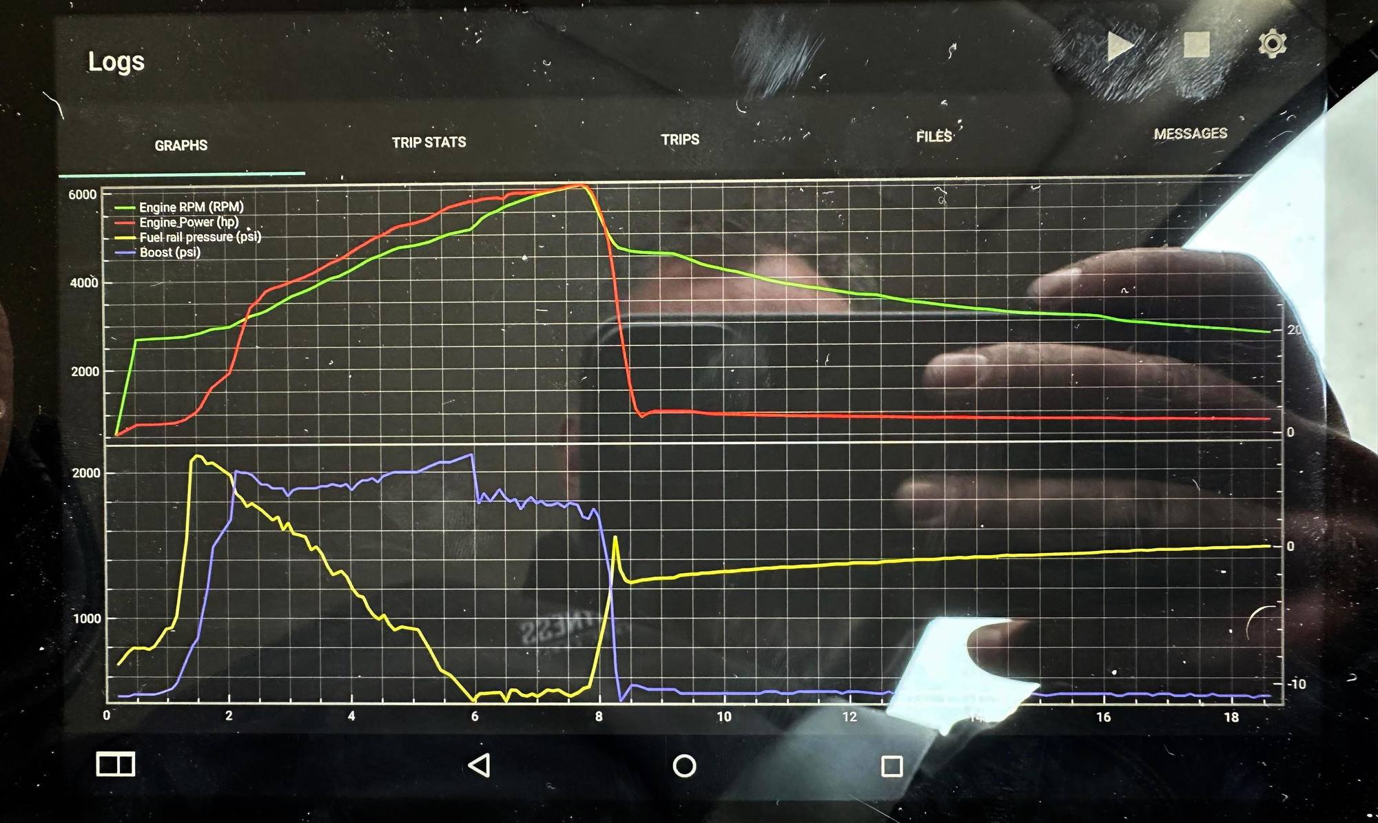

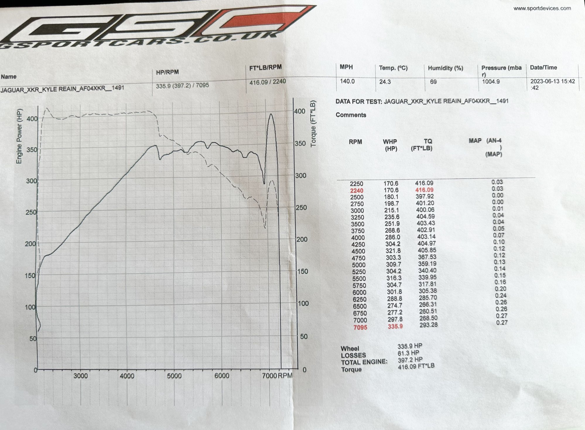

Guys, I could really use some help here, 2012 5.0 XKR Denso - to cut a long story short - Last year towards Christmas I fitted the Powerhouse upper Pulley and had a Powergate 3 Remap done to suit, The mapper is reputable with vast Jag experience - with terrible weather (N.Ireland) it was months until I was able to get it out for a good hard blast,
Car felt great and pulled strong right up the rev range then at 4500Rpm in 3rd it would bog down, cut back, and then pick back up, I told the tuner this and he sent another file though, again... it felt great but again would bog, I Flashed back the ORIGINAL file to the car and ran in 3rd - AGAIN it would bog, the odd time it would pull a p0087 low fuel rail pressure code, -
I have checked the fuel rail pressure on my icarsoft
Engine off LPFP 460kpa (66 PSI)
Idle pressure is 6340Kpa (932 PSI)
Maxes out at 15000Kpa (2175 PSI)
Voltage for the sensors looks good.
This leads me to think there's something else going on... I'm getting no misfire codes, changed all the plugs still ran the same, I Have SDD so reflashed modules as there were some outstanding updates - this seemed to clear it up, however, it seems the issue has come back.
Dyno today to show what's happening 4th gear pull - with the stock tune but with the upper pulley, I hope someone can give me some insight to smooth things out.
Thanks guys! Realizing I didn't cut a long story short at all...

Changing the pulley probably impacted the maximum boost you are running, right? If you are running more boost, then you need more fuel.
Q1. Are you getting proper fuel pressure across the range? You shared only few data points
Q2. Any way you install wideband O2 gauge and monitor A/F? That would tell you if you are running lean.
Sounds like you are running lean and computer pulls back timing. Since you installed the pulley, old A/F mapping is probably not good.

- Yes if I do a live log with my icarsoft it shows the fuel pressure is nice and high right the way throughout and only drops once it pulls back at 4500 under WOT
- What parameters should I be seeing VS not be seeing on the wideband AF Data? I can easily check this if i know what I'm looking for as "Normal under which circumstances"
It certainly feels like it's pulling back, the problem is even with two different tuned modfiles for the pulley it was still pulling back.

Okay great help thank you - I took the car for a run there and checked what I could find related to Lambada and A/F ratio - both were very similar figures throughout the run but nowhere near what you're saying.
attached is one of the 100 data points from idle to third gear WOT - with as much rpm as I could get for the road. when I slacked off the throttle the lambada number increased slightly to 1.3 or so.

Interesting part of the story is related to poor performance on OEM soft (as my 1st hypothesis was related to poor tune). I had upper pulley without a tune on my car. First run on a dyno (before remap) was very good - normal, steeping curve.
BTW changes in boost on upper pulley only is actually small.
So my bet would be that you have a problem with "hardware" (powertrain).
Not sure about fuel (but the code...). Actually OEM fuel supply is good enough for 600+ setups. I'm wondering if supercharger is working well (what boost it generates) and if the wastegate is holding the pressure.

It is interesting, I did originally think it was the fuel pumps until i checked the pressures as it would throw the p0087 but it only did this when it pulled back. - Do you know what I should be seeing on the wastegate actuator data at idle and under load?

Went on a rampage this week, put my Link LX obd reader on and got some new info - at WOT my boost was there, BUT Fuel pressure was dropping from 2100 right down to 430 Psi - this was causing the mess on the graph -
Quick test - there are x2 High Pressure Pumps on the lower left side of the engine (viewed from the front) above the rear undertray.
they are covered in two sponge noise absorbers.
pull the electrical connector off the front pump and start engine - check pressure
(should idle around 650psi when warm)
replace electrical connector and remove the rear one. start and check pressures again,
Mine revealed the front pump was good, the rear one was sitting at 45psi and spluttering - You can actually feel the front one ticking hard and the rear one didn't even feel a tick off it.
