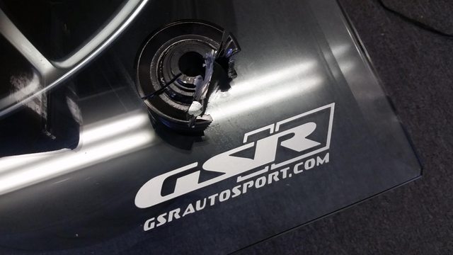

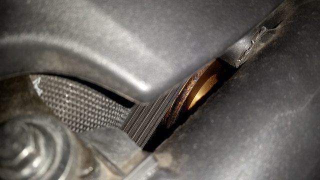

I contacted many shops here in Southern California before I found one that was willing and able to perform the supercharger pulley install. The reason many shops declined the opportunity to install the pulley was due to the fact that one shop had essentially ruined the supercharger on a customer car during the install process.

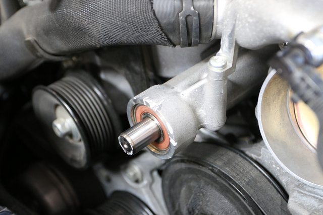

Unless the shop has a proprietary or OEM pulling tool and raises the motor by jacking it up from the bottom end, the pulley cannot be removed easily and must be cut off. This cutting process is a delicate one and the technician must be careful not to mar or damage the shaft on which the pulley sits. Once the factory pulley is removed, you must heat the new pulley and press it onto the shaft before it cools. If the pulley is not seated correctly after the first attempt, it must be removed again. If this happens, you cannot reuse the pulley (if you were able to remove it without having to cut it off again) and must purchase a new one.

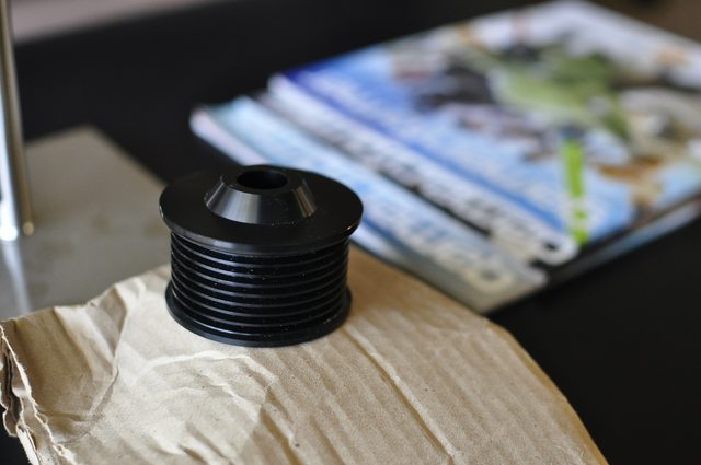

As an interesting note, the Eurocharged pulley I received has turned a gold color after the install.
Here are a few photos of the pulley install:
^ New Eurocharged Pulley
^ Stock Pulley (immediately left of the throttle body)
^ Supercharger Input Shaft with stock pulley removed
^ Stock pulley remains
^ New pulley installed. Now gold in color.

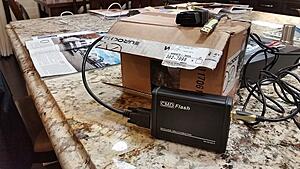

Eurocharged sent me their loaner tool so that I was able to download my stock tuning file and then upload their tuning file after they had configured the original file. The piece of hardware sent to me is a CMD Flash unit made by Flashtec. This box has one side that plugs into your OBD2 port and then then other side plugs into your laptop computer. No instructions came in the box and I spent a little bit of time figuring out how it works.
This loaner tool is not compatible with any of the software found on the Eurocharged website. I was able to download the correct software as offered by Flashtec and I immediately started playing around with it. The Flashtec CMD Flash software looks a little similar to the Eurocharged Euro-Flash software so I was able to figure out how to download my factory file with no issues. I do feel that I am technically inclined due to my background and this process may be difficult for most end users.
After downloading the file, I sent Eurocharged an email. They were under the impression that I had not yet figured everything out and they requested to remote log in into my computer to assist me with the download process. After I realized what was happening, I told the technician I had already installed the software and downloaded the original tune. For those who may use Eurocharged for their tune, the program I used to download my factory file can be found at this link: Flashtec-Setup
Downloading the original tune takes about seven minutes. Flashing the new tune takes about ten minutes. During either of these processes, you will see many error and fault messages on your dashboard. Do not be alarmed as this is completely normal. I also had the program fail during both the download and upload process. The interruption was caused by my anti-virus trying to update as well as Windows trying to update. If you see the program fail, do not be alarmed as redoing the upload or download process fixes everything.
I did receive three tunes from Eurocharged. The first tune felt marginally faster in gear 3 and higher but the first two gears felt the same if not slower. After I sent these comments to Jerry Thornton at Eurocharged (I think he is the owner), he sent me a second tune. This tune felt way stronger than the first; however, my cruise control had been disabled in the process. The third tune fixed my cruise control issue and retained the power of tune number two. Tune number three is the one that was loaded when I had the car run for the final time on the dyno.
Overall, it was easy to download my OEM tune and upload their tune. ECU removal was not necessary for me. Please note that I did wait quite a while to receive their loaner tool as they do send this unit out to their other customers. I do feel it is worth the wait to use this tool rather than removing your ECU.

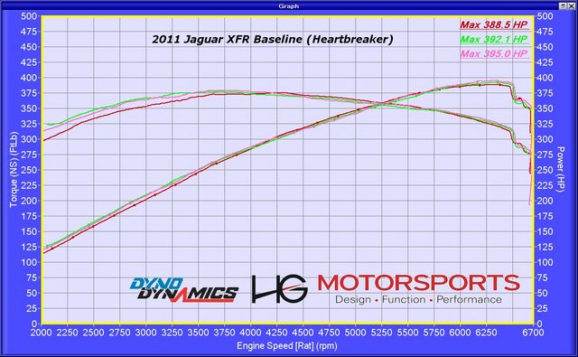

Stock Power
----------</b>
Three pulls were made for my initial baseline.
As you can see, my car made power with each subsequent run. The time between each run was about five minutes and the car was left idling on the dyno during the wait times before the next pull. Air conditioning was left running as well. The large fans in front of the car were also kept running as the car idled.
The reason I decided to run the car in this manner was to test the cooling efficiency of the car. There have been many claims of heat soak after idling for a while and I feel this shows that the car is more than capable of retaining consist power delivery.

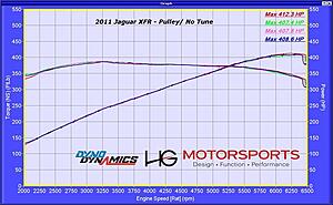

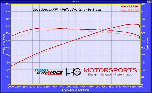

Four pulls were made this time. The car was driven in excess of 250 miles to allow the ECU to adapt to the changes.
The run procedure was a bit different this time. The first three pulls were done back to back allowing no time for the car to cool. The reason for this is to see if the car was still able to retain consistent power delivery having sped up the supercharger spin rate with the new pulley. As the graph shows, the car was within 1.2 horsepower of these back to back runs.
Having done the first three runs back to back, the car was allowed to sit on the dyno idling for about ten minutes time. For the last run, the car made a little bit more power than the first three runs. As with the baseline runs, the air conditioning was left running this entire time.
There have been many suggestions of the TCU (transmission control unit) limiting power in the midrange and it feel this graph does show the limiter working as designed. There were absolutely no gains in the midrange with this pulley. It seems that the supercharger pulley had no ill effects on consistency of power delivery and you can clearly see the large gain in wheel torque at the bottom and top of the rev range as evidenced by this comparison graph. Horsepower did increase at the bottom and top as well.
The Eurocharged supercharger pulley is similar to the ones offered by many other companies and is advertised to produce up to 1.5lbs more boost. In my data logging using the Torque Pro app on my phone, I can verify that I am seeing this increased boost pressure as compared to stock. The highest pressure I saw when stock was 10.3psi as measured by this app and the highest pressure I have seen with the pulley is 11.9psi.
Please note that the aforementioned boost levels are the maximum measured and there are many variables that determine boost including altitude, humidity, speed, etc. On a regular basis, my measured boost pressures are a bit lower than the max numbers I've logged. This is of no fault to the car.

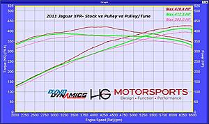

The Overall Picture
----------</b>
The most noticeable difference with this tune is the amount of extra torque the car is now producing. While the tune did help the car gain a bit of peak power, the overall gains in wheel torque are quite staggering. Although my peak horsepower gained was a bit less than they advertise, I blame the 91 octane fuel as their numbers are advertised with the car using 93 octane. My peak torque gain absolutely matched what they advertise.
That being said, there is absolutely no doubts that the pulley and software provided by Eurocharged do indeed work and work well.
The graph directly above this comment shows the best run from each run. The graph below this comment will show the average power generated by each of these runs. This is a better representation of overall power gained.

I am sure you'll agree that estimating power at the engine by using dyno numbers is quite inaccurate. There are too many variables between different types of dyno's and their correction settings. The only way to accurately measure engine power is by physically removing the engine and placing it on an engine dyno. Obviously nobody on this forum, nor any sane individual, will actually ever do this.
I will agree that total power gained is not as high as I hoped nor as high as they've advertised. Please keep in mind that Eurocharged advertise a 55 horsepower gain at the motor and a 65ft lb of torque. I do not know where or why you have the 620 number in mind but Eurocharged definitely do not advertise power at that level. I am, however, satisfied with the amount of torque gained by this setup. You can feel the difference on a day to day basis.
Attached to this response is a dyno chart that HG Motorsports provided for me to simulate numbers that I would achieve on a Dynojet dyno. The conversion factor was achieved by running the same vehicles on a local Dynojet dyno and calculating the desparity. Just by this graph alone, you can understand why all dyno sheets should be used as a reference and nothing more.
Many 5.0L cars have made between 440 and 460 horsepower at the wheels when stock on a Dynojet. As you can see from the attached graph, the Dynojet conversion of my run closely matches this. When tuned, many of these cars see power between 480 and 520 horsepower. My tuned power number falls right in the middle of the average numbers.
Perhaps this may change your mind or you may still be disappointed. Regardless, I hope both yourself and other people reading this response have a better understanding of dyno's, their conversion factors, and the potential massive differences in readings from dyno to dyno. As I mentioned in my linked posted, the purpose of my writeup was not to "dyno race" and try and show off a massive power number. The purpose was to verify advertised power gains. Horsepower was shy, torque was right at the advertised rate.
