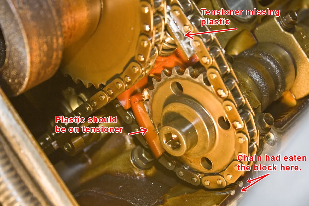

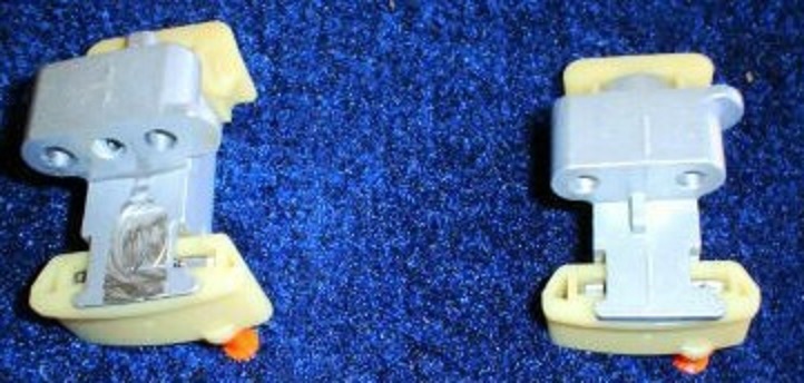

You can check but you need to pull one cam cover.
The new tensioners have a metal body and the plastic should be white.
The old bad ones will be a orange/red color from time and decay.
Are you sure the engine has not jumped time? If you are lucky this will happen before the engine is destroyed. So be sure and inspect them closely!
https://www.jaguarforums.com/forum/a...1&d=1444317996
Have the coils and plugs been changed? If you are lucky again you might just need to replace them if the tensioners are updated.
Attached Thumbnails Rough running,  bucking at part throttle-timing-chain-tensioners2.jpg   Rough running,  bucking at part throttle-lincoln-ls-chain-eating-cylinder-head.jpg

Thanks for the guidance. I will pull a cam cover and see if the tensioners have been upgraded. I have put 24 miles on the car since the issue began and I parked it with the intention of diagnosing prior to restarting the engine.
I thought that tensioner issues caused noise, when I pulled in the driveway and got under the bonnet I noticed no unusual sounds from the front of the engine. Just some shaking from the irregular misfiring. Never occurred to me that this might be the problem. I'll get the cover off this weekend and have a look, and count myself among God's favored if it is bad tensioners and the engine survived. Thanks!!

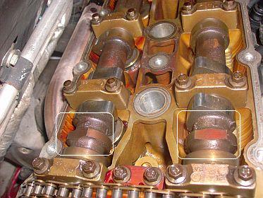

I forgot but do you know how to tell if it's in time or not?
The easy way is to use the factory alignment flats on the cam shafts. You will have the cam cover off anyway so I would check it.
The flats on both cams must be facing the same way and it's easier to check this if they are positioned with the flats on top of the cam.
Here is a picture of them out of time.
https://www.jaguarforums.com/forum/a...1&d=1444423284
Attached Thumbnails Rough running,  bucking at part throttle-3.9l-camshaft-out-position.jpg

Well, the problem was indeed the upper tensioners. One essentially dissolved, and the cam jumped time. Thanking my lucky stars I didn't have to eat a motor. New tensioners installed, running fine again. Left the job to a jag pro, it hurt to write the check but happy it's back in order again.
