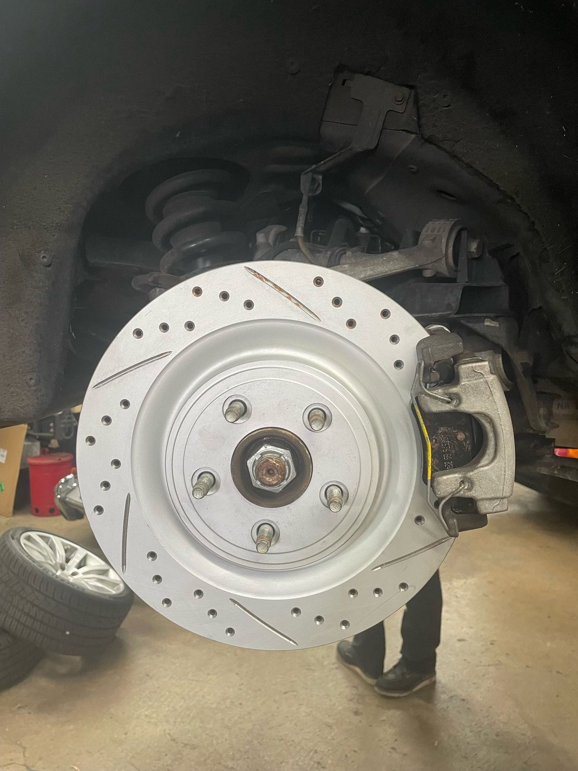

I used EBC pads, and rotors sourced from Summit Racing on my XK rear brakes. If you want drilled/slotted, I used R1 Concepts rotors from Rock Auto with Porterfield pads on my F-Type.

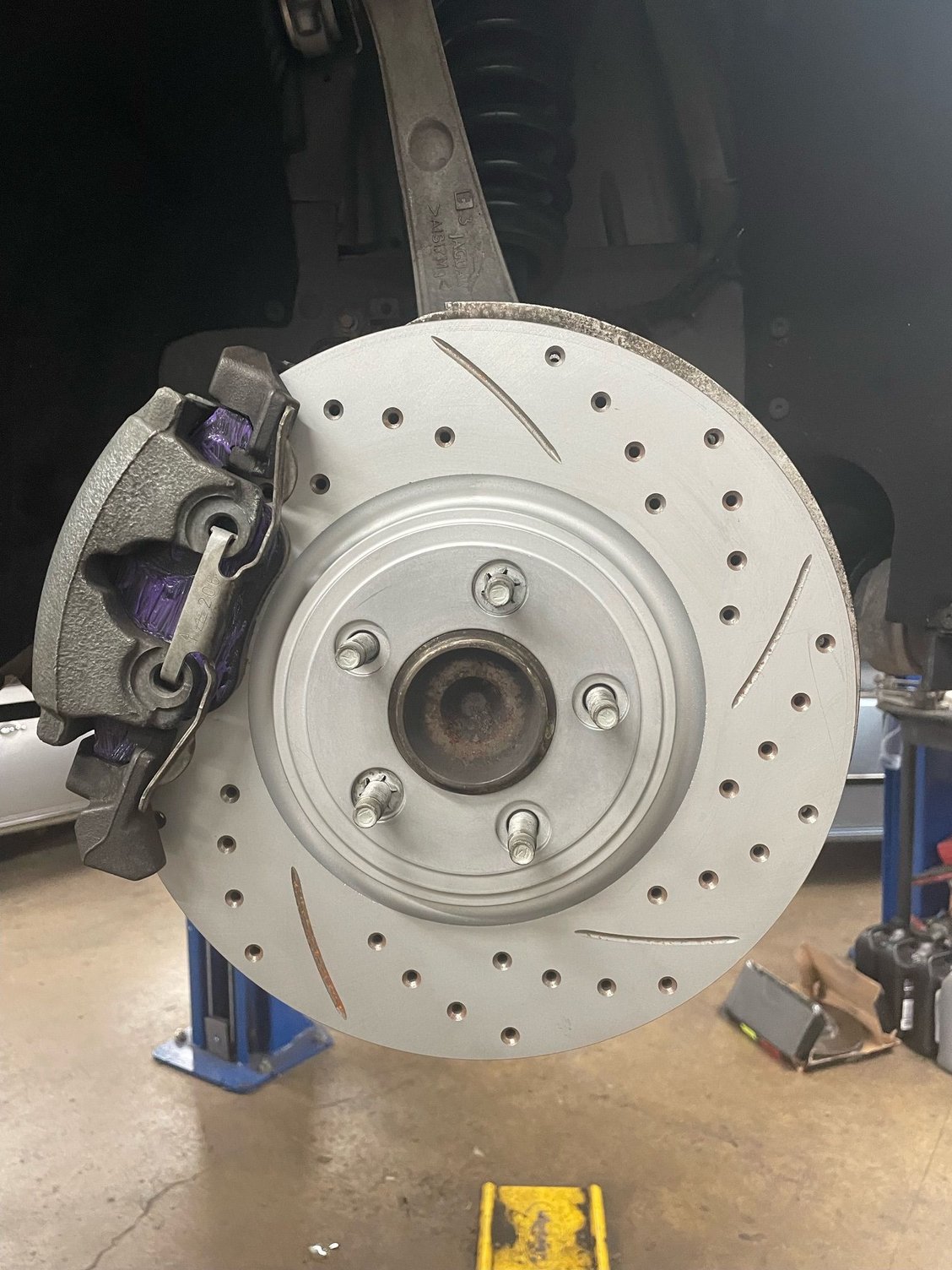

Completed the brake upgrade on the XK. CQuence rotors, Akebono Euro ceramic pads. Now to bed in the pads..........
