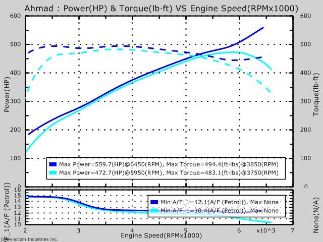

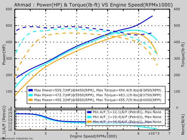

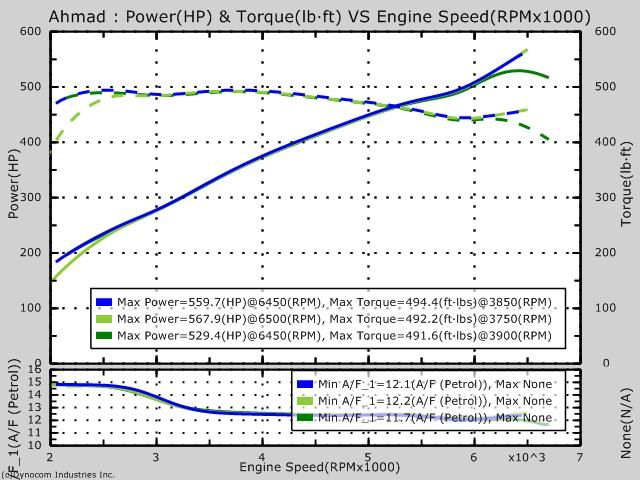

See attached charts:
First is All three (3) final runs overlapping (tune, pulley and exhaust):
Second is all three stages overlapping, Stock vs Stock Tune with Pulley and Exhaust, vs Final Run:
Third is a comparison of Stock Tune with Pulley and Exhaust vs Final Run (to see effect of Tune):
Final is a comparison of Stock vs Final (to see full gains):
5. A brief explanation of your satisfaction level and why
At the moment I am extremely satisfied... It was a rough road for me, but I am extremely happy with the results. I remember saying that our cars make plenty of torque, and when I added the pulley I noticed a drastic improvement in torque and throttle tip-in, which can be seen in the above graphs (all three overlapping). When I added the tune all I had hoped for was to have the boost not bled off resulting in torque drop off and finally resulting in less than ideal power up top.
The tune has further enhanced torque and throttle tip in, and on top of that the boost isn't bled off resulting in torque not fading, and my power just keeps climbing... So where other members have commented that the car just doesn't seem to pull up top... that does not apply in my case, the graph fully captures how this thing pulls on the road.. in fact when I am driving and gunning it the sweep from 5500rpm to 6500rpm is unreal...
I couldn't ask for more...
