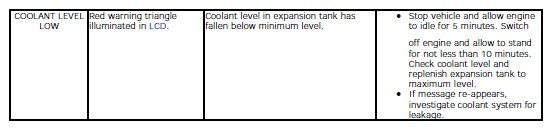

The 4.2 Workshop Manual is very light on information regarding coolant level monitoring. The 5.0 Workshop Manual is more detailed.
The 5.0 Workshop Manual states "If the coolant level in the expansion tank decreases below a predetermined value, the level sensor connects a ground to the instrument cluster, which activates the appropriate warning. For additional information, refer to 413-01 Instrument Cluster." The additional information only describes the displayed warning:

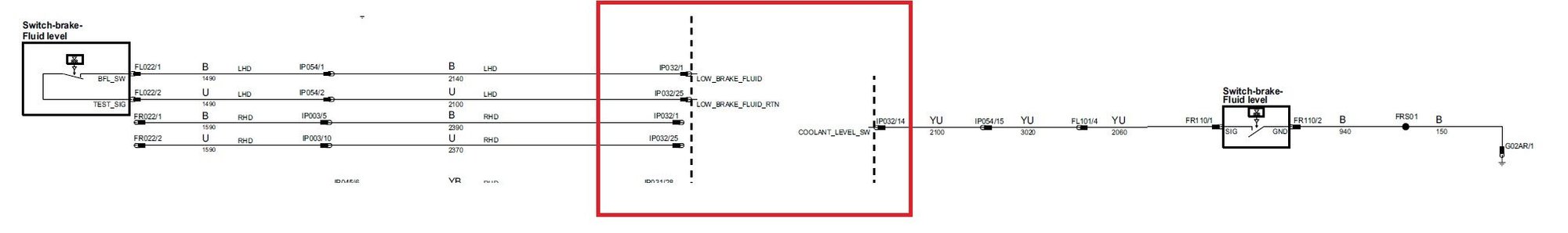

The Electrical Schematic shows the following pinouts to the brake fluid level and coolant level (relevant part of the IP shown boxed in red):
Brake fluid level on the left and coolant level on the right. Brake fluid setup looks as expected but coolant level on the right ..... via Yellow/Blue wire to another Switch-brake-Fluid level. Presumably should read Switch-coolant level but if the harness connector isn't on the sensor, where is it?

This goes back to my theory that the 4.2 does not actually have a level sensor in the coolant tank, at least not a functional one. The manual never mentions anything about the sensor except that it's fitted into the coolant tank. No troubleshooting, diagnosis or anything.
The only way to notify you on low coolant is to put the car in 'restricted performance' mode, as I experienced in my other thread.
If you are not getting any messages or codes and the car is running fine then don't worry about it.
The temp sensor is fitted in the coolant manifold (at least on XKR models).
