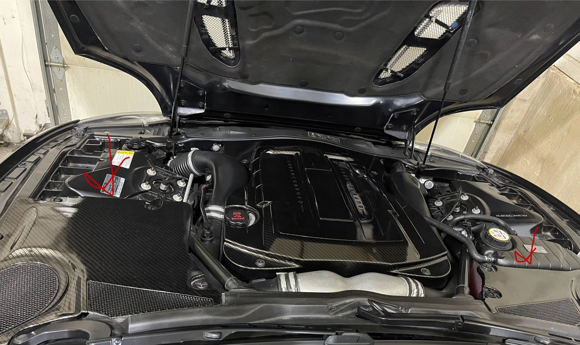

Do you have the Engine Appearance Cover? It helps reduce engine noises a bit.
Yes sir. You and I compared styles, I have all three hydro dipped, but you have the killer red stencil and leaper sticker.
When I get home from a drive and am parked in my garage, I always open the hood (bonnet) to let the heat escape to prolong the longevity of the rubber parts in the engine compartment. I also check the fluid levels in the clear reservoirs to see if there are signs of any leaks.
At least for now, before bed and in the morning I’m checking all accessible levels. And the bonnet stays open most of the time as a reminder before I take her out. Mostly monitoring the the coolant situation which only leaks under pressure from that silly hose/nipple. But also building a habit, kind of like making the bed.
