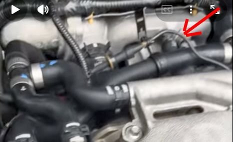

3. Thought I heard some "air like" sounds when I started the car the other day. So I started listening for everything.
Got home from an errand, turn off the car and removed the engine cover. Of course I put the Oil Cap back on and restarted the engine.
Recorded the video below.
Need to lean on the experts here. Hoping the audio is clear enough.
Put my hand on the SC and there is some vibration.
From both sides in the gap where the covers are sounds a bit 'knocky' but that may be normal.
Anyone hear anything out of the ordinary?

Sounds like the air line to the pass side of the supercharger is leaking - there are three tubes (black plastic) that break up. Check all three - the one with the arrow is one of the three.
Had looked at that one before when someone’s had broken.
went out and looked again. Traced it to the split and both runs to the SC and Sensor.
All seems solid.
I may have to fire up a cigar sometime this week and do a smoke test on the system.
