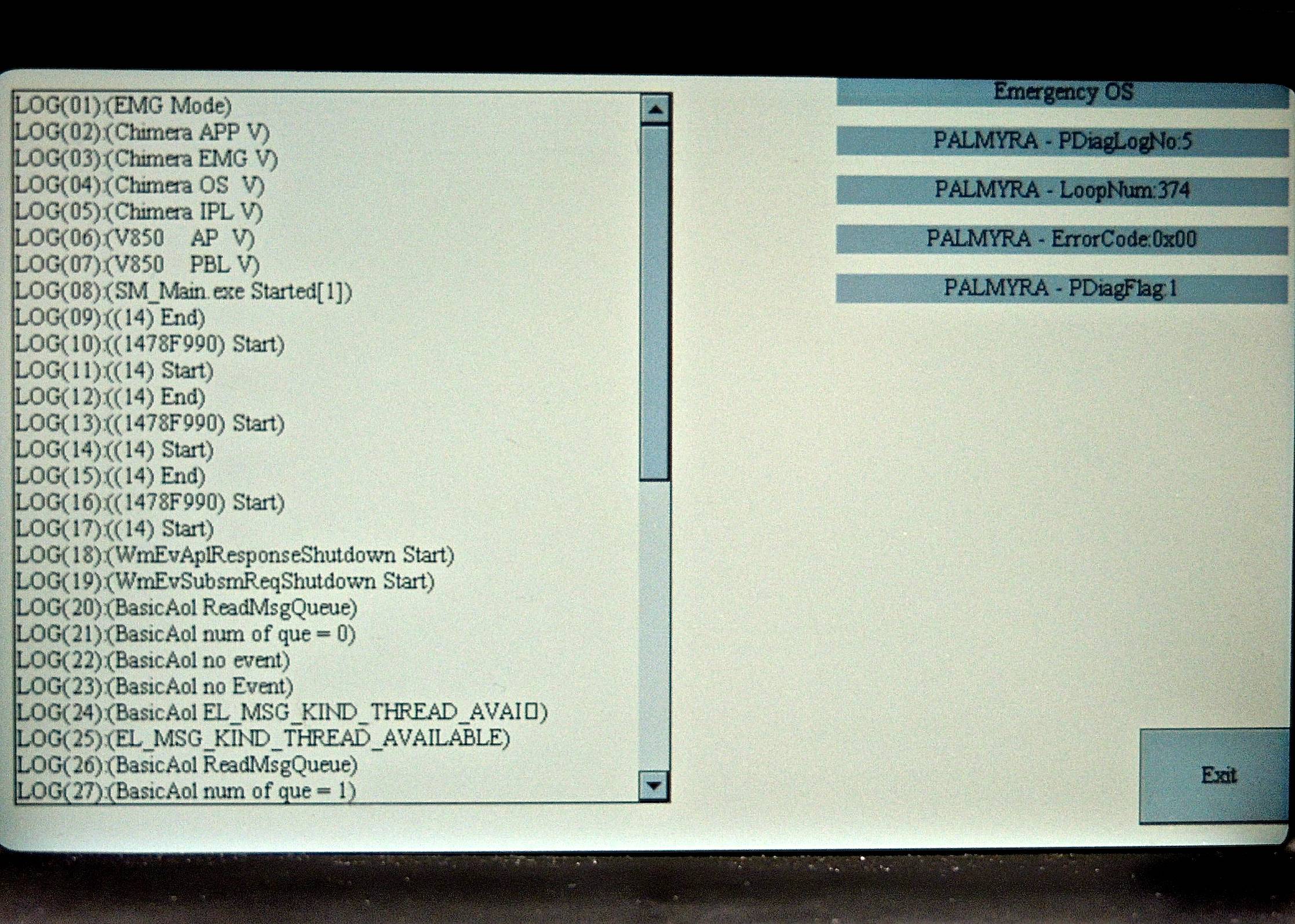

I am getting an intermittent error code on my '08 XK. I was finally able to show it to the Jaguar service department (the day before my warranty ran out). It seems to have the technicians stumped, but they are discussing it with Jaguar. When it appears, the screen becomes unresponsive to scrolling or closing. It also affects other things controlled by the screen, such as the sound system, i.e. no sound when the error screen is on.
Typical scenario when it appears: Drive 5 miles, sit and idle for 5-10 minutes, shut down. Next time I enter the car (open the door), screen is on and stays on when I start and drive the car. When I shut the car down, the screen stays on for about 15 minutes, then goes off. Next time I start the car, usually the next day, no error screen and the car operates normally for awhile. It may appear again the next day, next week, next month. Anybody heard of anything like this? I'm puzzled. So is the dealership, which has had the car for over a week, with no progress to date.

does this screenshot show up on your nav display?

Oops, I missed that part. I never got that screenshot before. So my issue may not be the same as the OP's!

Does anyone know where I can get a list of these error codes? I'm sure it would be helpful to owners, especially when they see an intermittent code and can't duplicate it when it's taken in for service...which is why I finally took a photo of the screen. (To answer a previous question: Yes, it appears on the nav screen.)

The picture you posted originally actually looks like (a portion of) a log file from a software execution dump...
I don't see any ODB compliant codes listed in the picture. I might be missing something in that regard...

I agree that it looks like a log of events. And, with the scroll bar showing on the side, there is more of it that I can't see. Unfortunately, the screen is unresponsive to any touch to scroll or close it. Other functions, such as the radio, don't work when the screen is visible. I haven't checked to see if it affects the heat or a/c functions. That might be interesting.
I'm particularly interested in the messages showing up at the top right of the screen. I never like to see the term, "Emergency."

I spent 25 yrs in IT, and I recognize the general gist of this screen ! it looks some kind of debug display after a fatal error that the system can't handle.
Been there, done that - fortunately usually on someone else's time, and not on this kind of platform....
A quick Google shows 'Chimera' as a peer-to-peer software library, that Jag might be using for communication between the various modules (which are actually individual CPUs). And 'Palmyra' shows as a debug tool for fixing this kind of network. We were never meant to see this screen !
My guess: you have a damaged CPU or connection somewhere that is crashing parts of your cars CANbus network. Its generating an unrecoverable internal error, and the only people who could probably decipher it are the original developers at Jag (or their sub-contractor) !
I doubt the Dealership will know. Jag themselves might give them a clue, but otherwise they'll have to swap modules until it works...
A new. known good, battery would be a good first start - the CPUs on these cars are very sensitive to voltage.
