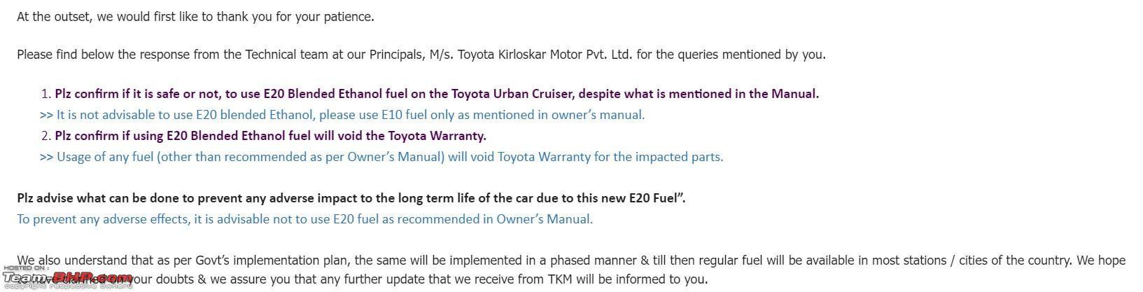

This is the response of TOYOTA INDIA regarding E20 and E10 fuels and their vehicle compatibility.
Man I think there's more to it .
Of course, that's the standard manufacturers get-out clause. If I didn't know more about cars than the manufacturer, I would have thrown in the towel decades ago. 😉
