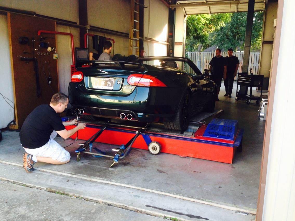

I arrived at Eurocharged right at 4:45 PM and was greeted by the staff. Everyone seemed very polite and professional. One of the guys went to my car with a laptop to (I think) read the original file, and then he pulled the car around back to setup our first dyno run.
Here you can see Jerry strapping down the car.

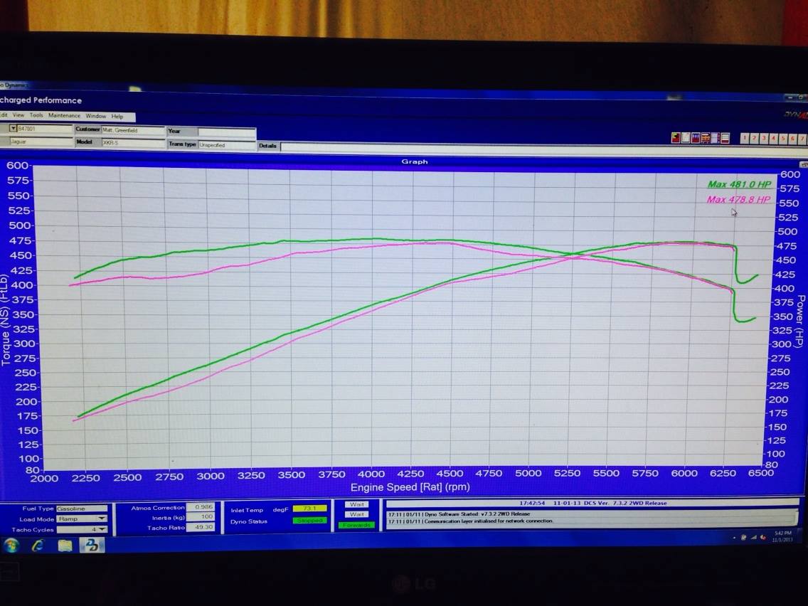

Here are two of my baseline dynos. Not bad! Best one was 481 rwhp. The runs were carefully done in 4th gear. If you floor it too soon, it will downshift to third. I think we actually did three pulls. One was discarded because of a downshift.

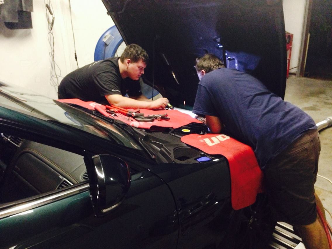

Removing and replacing the new pulley took the most time, by far. There isn't much room at all to access it. The old pulley was carefully cut off and the new pulley was heated up and put on. This took about 2 hours, plus the motor needed to be cooled down a bit before they could even start. The tune was installed while the pulley was being removed. I hung out in the office and chatted it up with Jerry and his staff. From what I gathered, they all love to fish and play with cars all day. Maybe one day I will take an offshore fishing trip with Jerry on his boat.

The Eurocharged Houston location has a Dyno Dynamics dyno, and it seems quite calibrated. I have read these are some of the most accurate dynos.
If my baseline was 481 rwhp and we account 15% for drivetrain losses:
481 x 1.15 = 553.15 hp, and the XKR-S is rated at 550 hp, so this is very close. The only other mod I had on my baseline run is BMC airfilters in the airboxes.
If that is true, and my final number was 539.6 rwhp, then lets add in drivetrain losses (539.6 x 1.15) = an estimated 620.54 HP, which is an estimated gain of 67.39 hp. I say these numbers are an estimation because I don't know for sure if 15% is the exact number for drivetrain loss on this car, but it should be close.

15% is a decent rule of thumb for an automatic, but to be completely correct the math should be RWHP / 0.85. In other words:
481 / 0.85 = 565
539.6 / 0.85 = 634
So either the drive line is very very efficient or Jaguar under rated the XKR-S a wee bit. Either way you cut it, that is a phenomenal amount of power.
