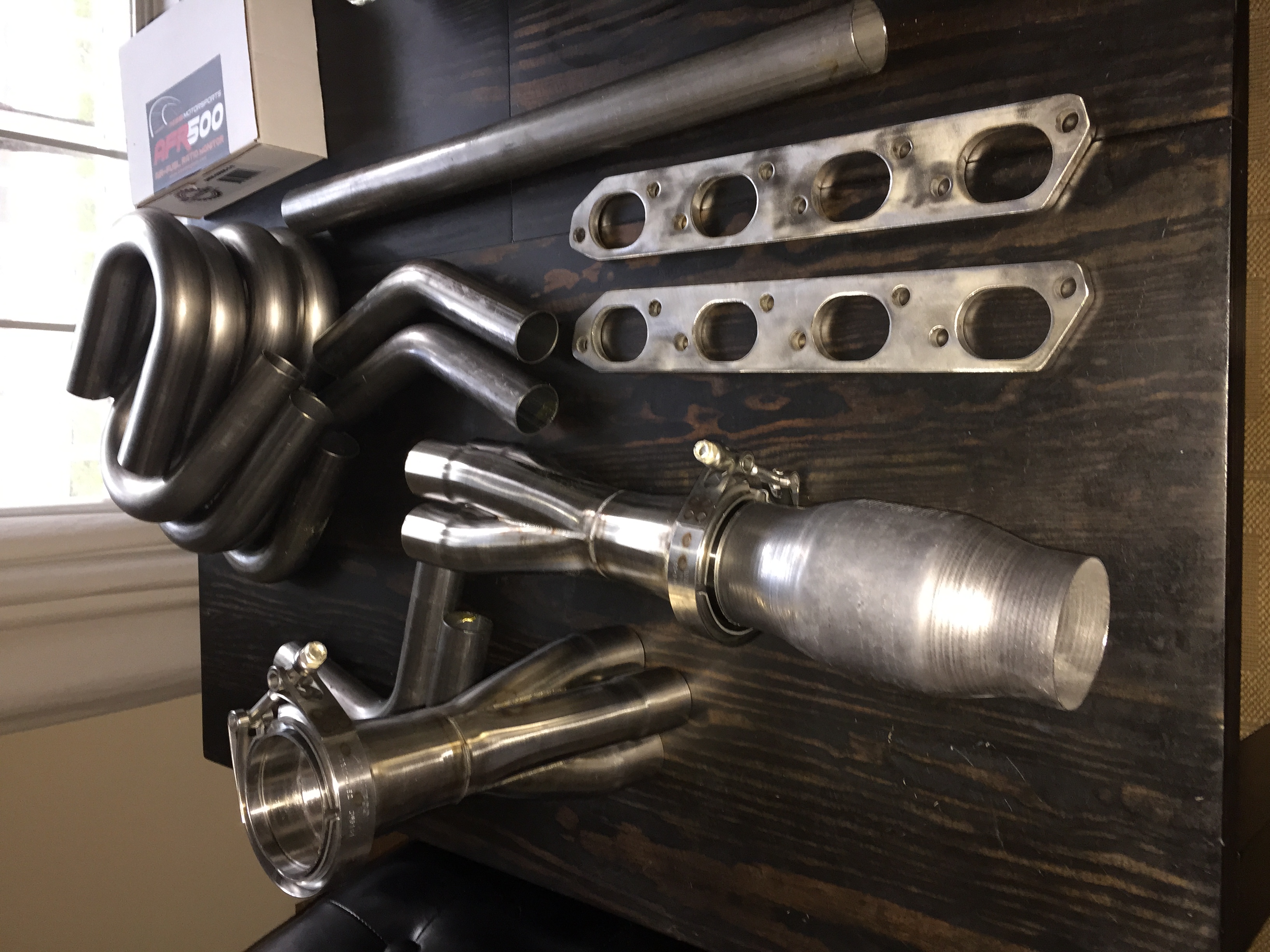

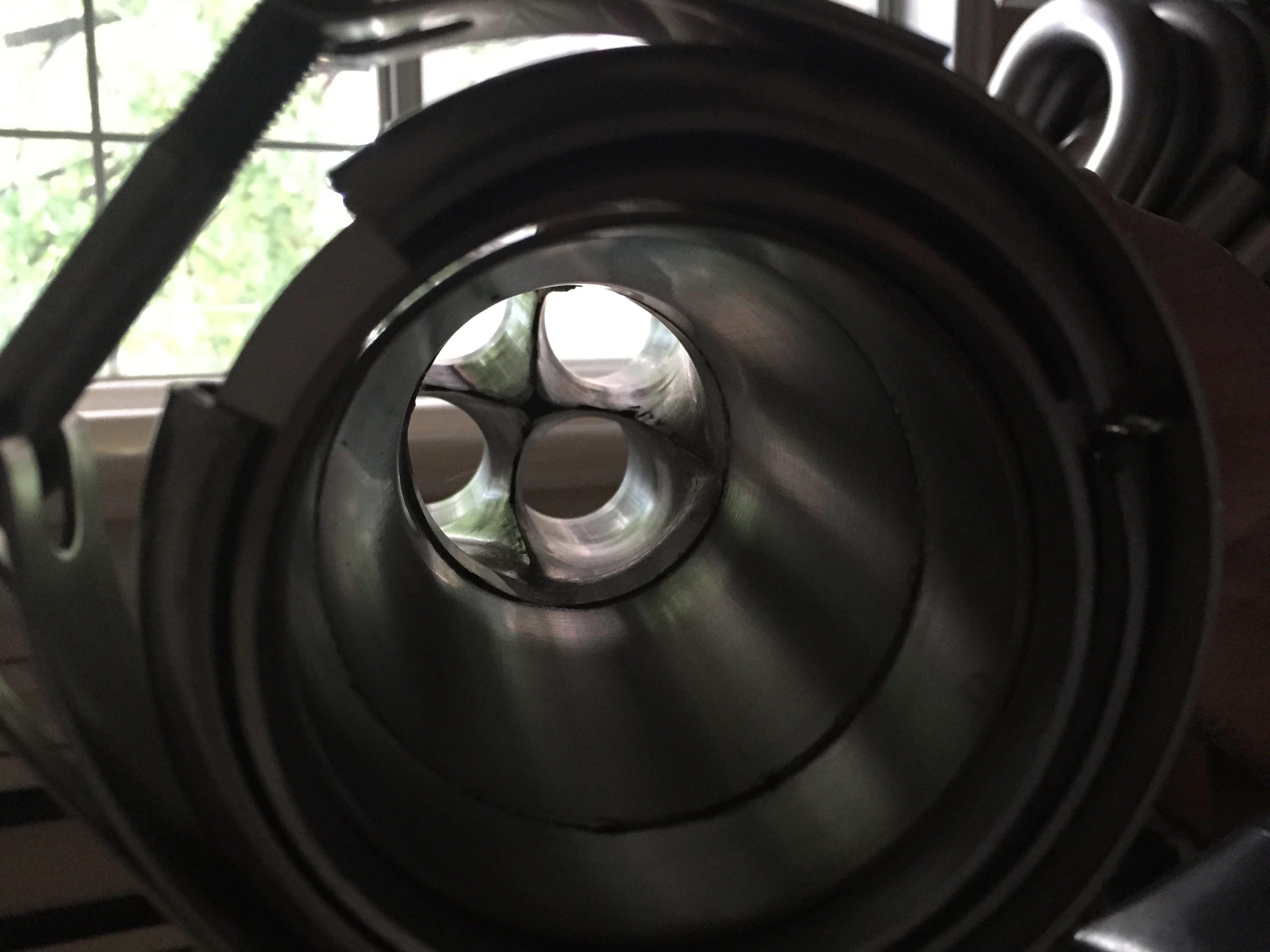

Update on the headers, posted over in the F-type area as well and wanted to add some pics here.
All material is in, I'll start fabbing everything up shortly. The collectors look great and are blended internally for a nice smooth transition. Under boost pressure a 4-1 should be a good start. I'll build a tri-y setup as well.
Flaring the 1.75" tubing to meet the oblong shape port for a smooth transition.
The throat diameter is tuned to 500-600hp, which should be ideal for this setup. I will have an alternate collector for when I bump the boost up with a Whipple upgrade. (I'm working on all the CAD data on this now, Hat and supercharger scanned, just need to do the elbow to throttle).
I've attached some eye candy. I'll get this rolling possibly this weekend.
Xpipe and Cat fixtures are in the works, I'll be able to provide factory replacements in the next few weeks. With and without cats 200 cell or 400 cell, Mid-pipe will be x-pipe (or H-pipe) if one desires.
On my to do list is a rear muffler design, one thing at a time though. I'll have 06-09 split plenum induction in carbon fiber shortly as well. Proto will be highlighted in another thread.
