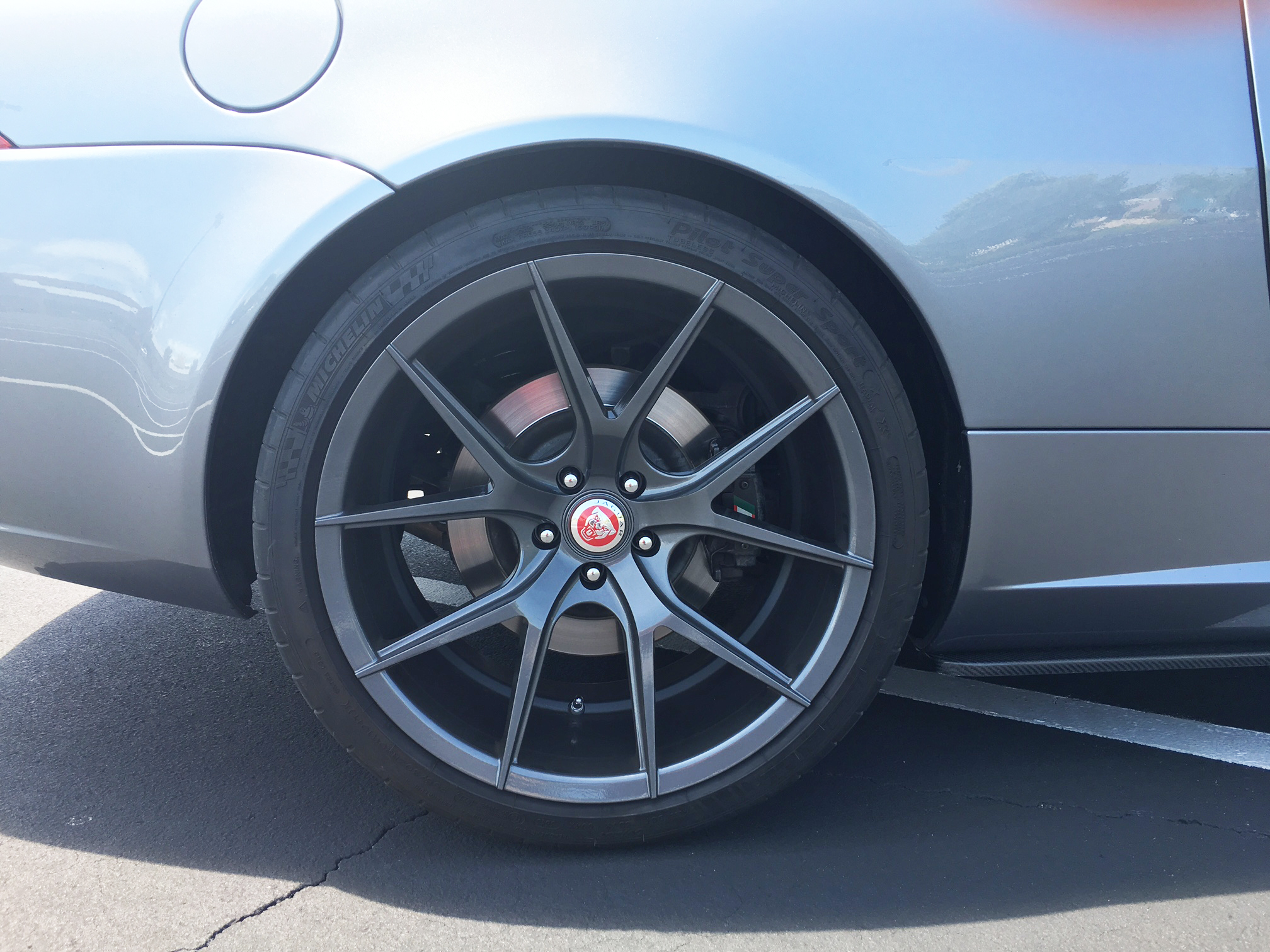

Finally got them installed yesterday and had an alignment done.
As you will see by the pics below, the wheels/tires are now perfectly centered in the arch, just like BMW, and there is still enough gap remaining that the car looks OEM and not slammed at all. The current drop is actually about 10mm, like the XKR-S, but will probably settle another 5mm.
The alignment results are also perfect, as you can see in the pic below. Many members here have noted that after lowering, the rear camber was a bit more negative than the factory spec, well mine is in spec at -1.2 degrees.
First impressions are the car feels lower and a lot stiffer. Marketing materials for lowering springs indicate there is no loss in the quality of the Jaguar ride, but in this case, that is not true. The car is more sure footed, firmer & less bouncy, steers/handles better and takes hard cornering with less body roll. Reminds me a bit of a Cayman S. Probably not for everyone but I am very pleased with the results.
Attached Thumbnails Finally lowered the XKR with Eibach & it is perfect in every way-img_9004.jpg   Finally lowered the XKR with Eibach & it is perfect in every way-img_8974.jpg   Finally lowered the XKR with Eibach & it is perfect in every way-img_9001.jpg   Finally lowered the XKR with Eibach & it is perfect in every way-img_8998.jpg   Finally lowered the XKR with Eibach & it is perfect in every way-img_8997.jpg

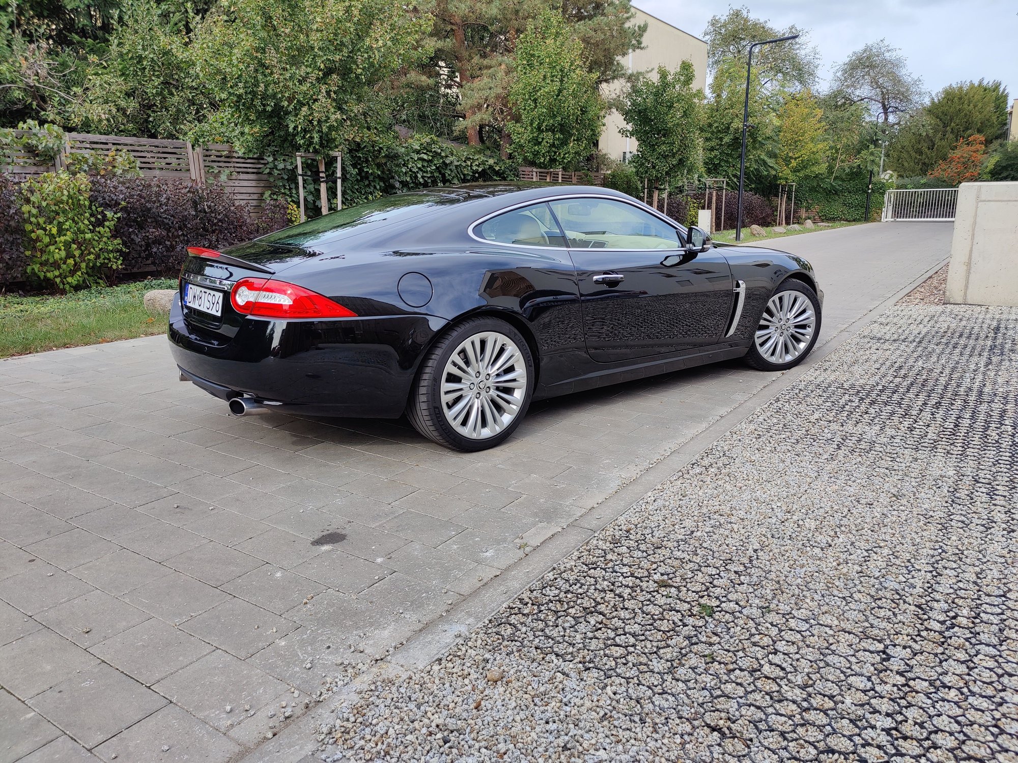

I pulled the trigger on those Spires Eibachs and I'm happy to confirm that they are the golden optimum.
The ride is sure but still comfortable, feels like my Jag got his *** of the sofa and did a HIIT training for a month, entirely different experience (in a good way).
The height is perfect to stay practical, any lower and they'd be a pain on less than perfect roads.
As a bonus it turned out that it was the OEM springs that were the source of some annoying sounds which are now gone.
They were quite pricey (springs 650 GBP, installation ~280 GBP), but around 35% of the cost was shipping, tax and customs (I had them shipped to Poland).
Still, I'd say the result is worth the price!
One thing that's making me wonder are my geometry specs which seem to be a lot different from yours @Jahummer
I've got 20mm front, 15mm rear H&R spacers, can this be the cause?

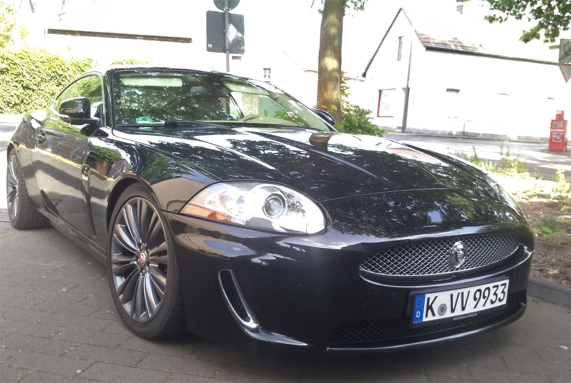

Thanks again for the info on the Spires springs. I have in my XK 5.0 (from 2010) the H&R springs, which are too low and also a bit too stiff for me. I am in contact with Spires, who confirmed in an email that the offered Eibach springs fit the XK/XKR and the XFR (!). It is well known that Eibach springs are not offered anywhere else on the market for the XK.
But: I noticed that my H&R springs with code number 29117 also fit the Jaguar XF (among others type CC9) - this is stated in the H&R certificate. Eibach offers lowering springs also for XF (type CC9) - then these Eibach springs should also fit the XK (because H&R offers the same springs for both models)? Here are two offers with the matching cars (XK and XF):
https://www.ebay.com/itm/36296352254...3ABFBM3O39uuhi
https://www.ebay.com/itm/22445614944...Bk9SR8r8iLvoYg
If my assumption is correct, one could save the expensive shipping from UK with customs etc. and buy the XF Eibach springs for the XK (of course then without documents for testing/approval/correction of documents). Or do I not understand something correctly?
Thanks in advance, bernd
