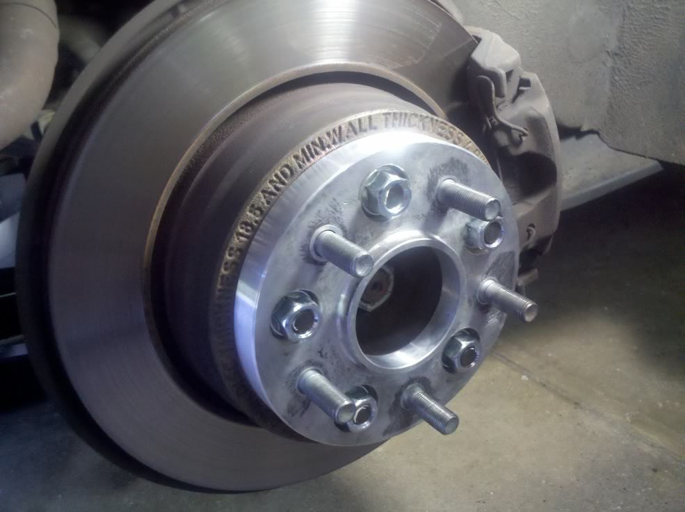

What thickness did you use?

Received 369 Likes on 228 Posts
I installed 20mm spacers, rear only. Here's a pic:
Attached Thumbnails Rear lowering springs only.-wheelspacerinstalled20mmrightrear9-11-2011.jpg
