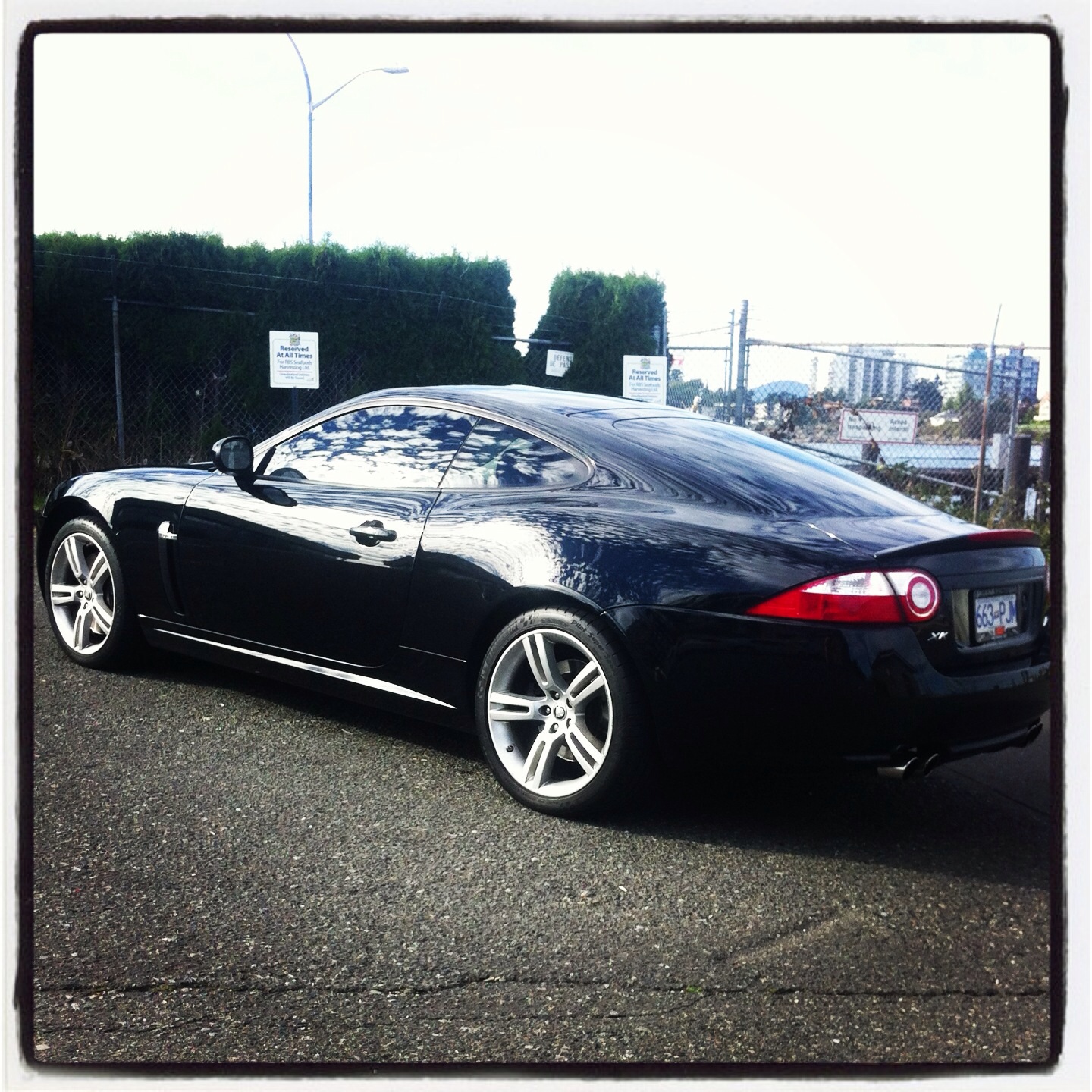

Hi guys I thought I spend some time and ask some questions regarding my newly modded xkr.
I have the 08 4.2 xkr and I removed the fuse 19 and was pleasantly surprised at the difference at lower rpm when accelerating as it had a bit more roar but still was subdued compared to a Aston or other high end sports cars yet at wot it was great. As stated in my other post I was hooked up with a quicksilver exhaust that I just put on today.
Fit and finish is impeccable as expected as it's one of the more $$$ exhausts for our cars. My guys at the shop said it fit perfect and was a breeze to put on.
Ok so the good parts push the start button and right away it's clear this beast has been upgraded as it is much louder. The first roar is impressive then it gets quite to a low faint rumble . I then hit the gas and at WOT this thing screams I mean compared to stock well it just isn't in the same league . I love it , it's well sublime... Now the parts I need a little advice on , at certain rpm 's it is insane loud in the cabin with a drone.. 2k-2.5k it is way to loud so every time I take of from a light it seems louder than it is at WOT ...
If you want people to not look then keep the stock as everyone looks as it is loud. I am curious if people can confirm or tell me from experience if there is a way to get the lower rpm quiter as man it is a big leap from stock that perhaps even me 33yrs old and a car nut might not want so loud. I can definitely understand why a more mature clientele would prefer stock as that is why the silver xkr at my dealership took some time to sell until they put the stock back on.
Anyhow I am giving it a few days to see as I love certain parts but also could pass on certain parts.. It's a love hate.... I just find the drone around 2-3rpm it gets so loud then at idle quite and at high rpm loud but a different sound. Any insight would be great and if you want a loud exhaust or a sweet sweet sound at wot quicksilver is great. Oh ya the throttle response is noticeably quicker , power I can't say yes or no as it's not crazy noticeable but the noise makes it feel quicker that's for sure lol
