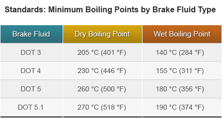

Since brake fluid is hygroscopic and does absorb moisture over the years, it can be tested for water content with one of the commercially available testers that check the boiling point.

Brake fluid is considered 'wet' at just a 3% water concentration and the boiling point is seriously decreased. I'm REALLY liking the new Castrol DOT4! Also, there is a brake fluid tester you can get off eBay for under $5. Buy one for your friend.

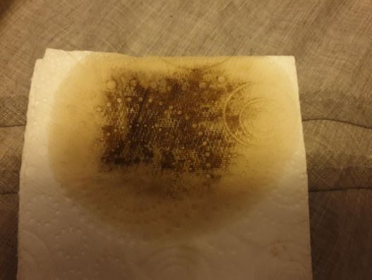

yes… and thats precisely the problem. one look at the drained fluid from the power steering rack or the gunk covering the filter in the reservoir will have you thinking about changing it.
After three (maybe four?) half-changes, mine's nice and pink and pretty.
