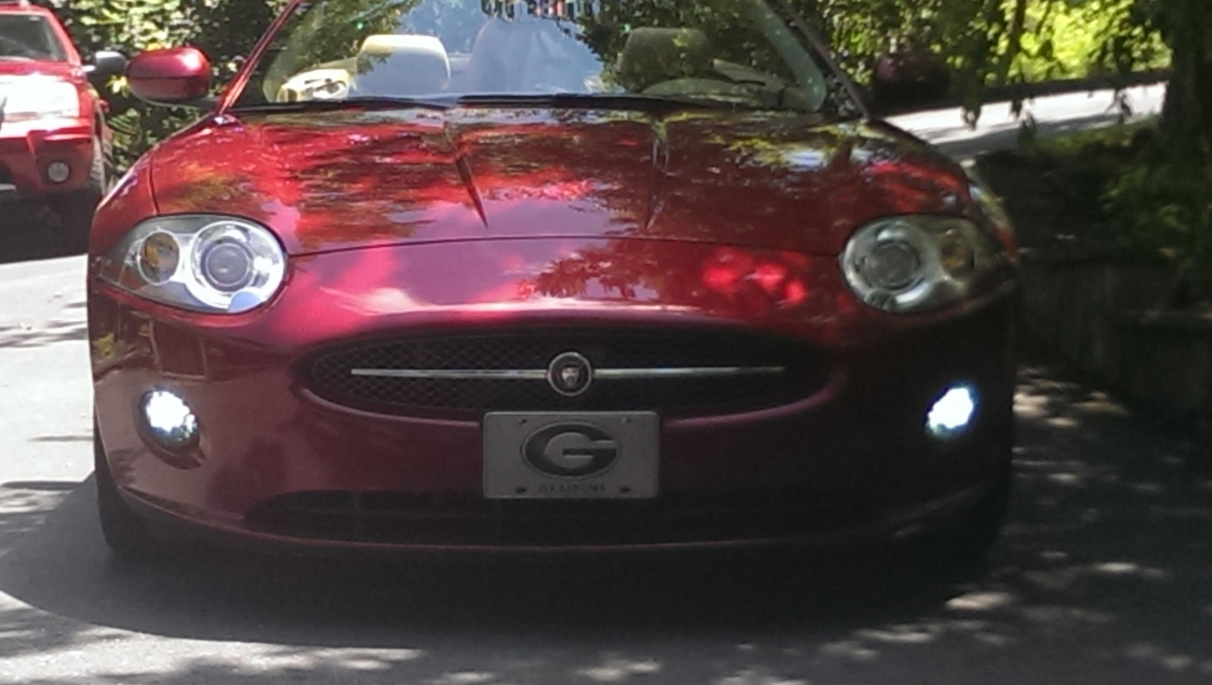

Sorry, I forgot the different bumper guard on the R vs Base XK. Mine is just the simple bullet holes. See pic.
I agree with Gray XK that you can do it without removing the wheels, I just found it easier to get my head and hands where I could see what I was doing. Maybe I just have a big head
Guess you are "stuck" with a beautiful car where you can only change the fog light bulbs.
