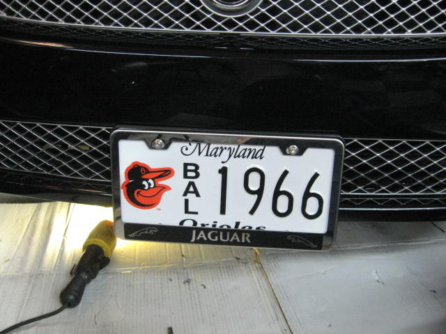

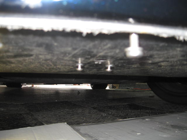

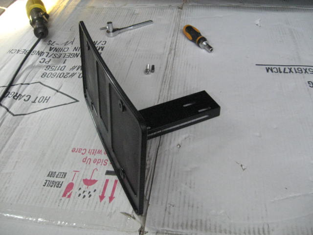

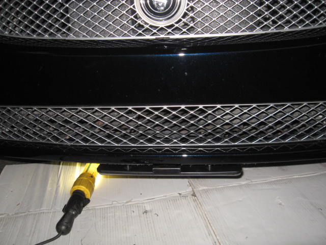

I too have the "show 'n Go" bracket. Installs easily, had to drill one 5/16" hole in the belly pan. It stows away (folds under the pan) if you chose to go commando. Ha, Ha, Ha..
I chose the center since the oil coolers are on either side of the middle.
Has worked like a champ for me...

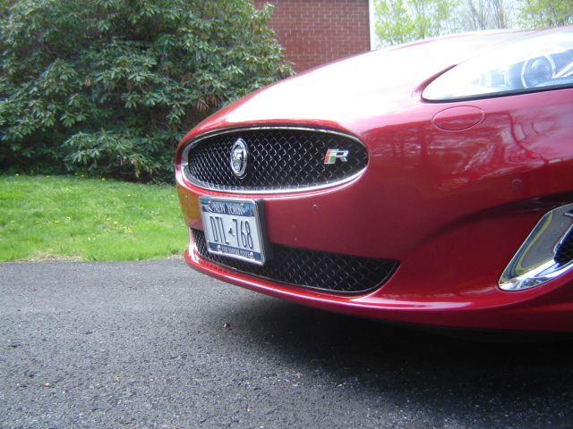

The easy way to mount the Jaguar bracket is to get a piece of aluminum angle at a hardware store. Cut it the size of the plate holder. Drill 2 holes UNDER ( without the plate mount you can't see these holes) the center section of the bumper cover. Screw the angle UNDER the cover. Drill 2 holes in the aluminum angle to fit the plate holder . Put a piece of double sided foam tape on the back of the plate holder. Mount the holder and mount the plate and frame. Done and you saved the front bumper cover for the next owner.
