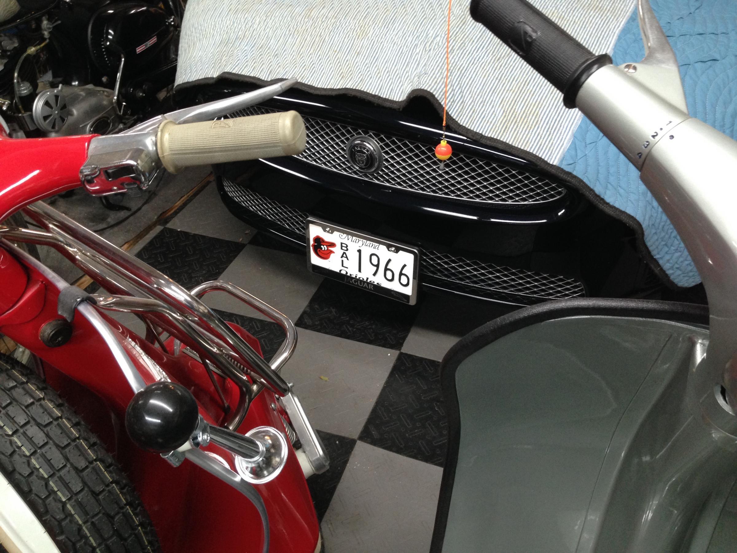

I managed to mount my front plate without drilling holes with J bolts and some creative bolt-and-washer use. It was a long thread, I think I even posted pictures... If you can't find it I'll take a look myself and if worst case it can't be found, I'll take pictures.
This was my previous XKR, which came to a premature end by way of accident. But the grill with the plate attached popped off and I kept it. It is currently hanging off the wall in the basement, so taking a photo or two shouldn't be too tough.

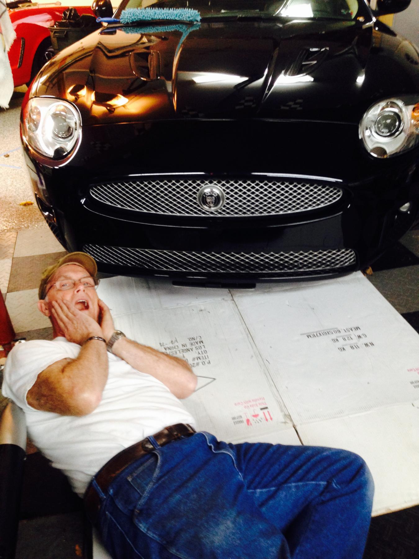

Hi,
Not sure you are referring to my post, but, I'll answer in my case, I don't have front sensors. I was more concerned with blocking air-flo to the coolers located behind the grill on either side of the tag.
If I did have front sensors, I could always fold the tag out of site before parking. But then, that would be a PITA. LOL!
Attached Thumbnails Front License plate-front-tag-installed.jpg   Front License plate-my-tag-disappeared.jpg

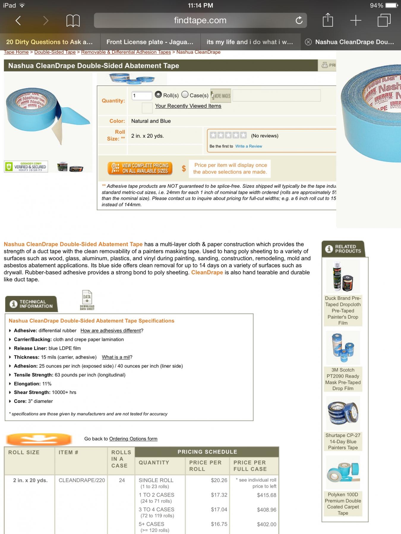

Default Double-sided blue tape
Seriously, this db sided tape stuff has worked wonders for me...I only use it when on Texas highways. Hold perfectly @ high speeds and leaves little residue when removed. once I get back in the city I just simply remove apply some glue gone presto looks right back to normal. Rather drive around with no plates but that's not a choice on the Texas highways.
Try it out sometime

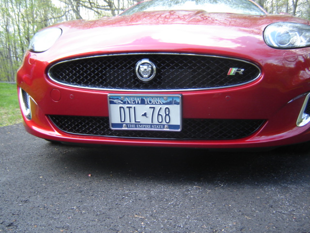

GR if you don't want to drill into the front of the bumper cover here is an easy way to do it using the OEM plate holder. Go to Home Depot or a hardware store and buy a piece of 1"x1" aluminum angle. Cut it to the length of the plate holder. Drill 2 holes on the underside of the bumper cover in the middle of the cover. Screw the angle to the cover. Put a couple of double sided foam tape stripes on the back of the plate holder. Screw the bottom of the plate holder to the aluminum angle and press the holder to the cover. Mount the plate. The next owner can remove it and there are no holes in the front to fill.

I also use the double sided tape, was worked fine for a couple of years now. I refused to drill holes, and while I worked out the process I would use, I too was pulled over in MD.
