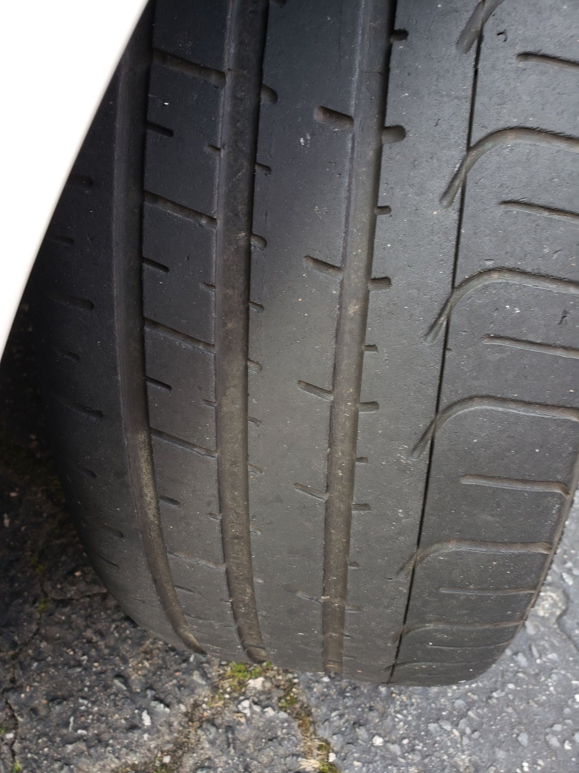

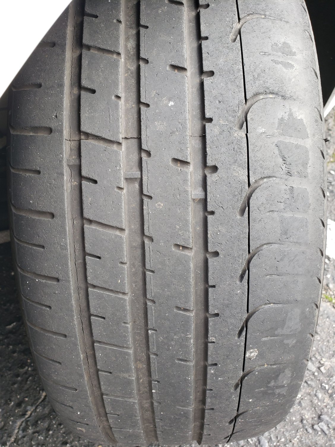

can someone please help in identifying the problem with tire wear on the driver's side front, the passenger side front is ok , see photos.2013 xk base has 51,000 miles at this time
Is the cause a bent rim, bad bushings etc. ? I have had the alignment checked

What sort of alignment was done and what were the results of the alignment?
That wear pattern initially suggests that the rear alignment is wrong pushing the car one way and you steering against it to counteract. Is the inner edge of the passenger side tyre also somewhat more worn/rounded off?

It could be either a bent rim or an alignment problem where the toe may have been altered due to hitting a pot hole. I would go to someone who knows how to do a 4 wheel alignment and ask for a read out of the alignment which should compare spec. to final alignment. Also have the rim checked for run out when they are going to mount a new tire.

Thanks for the input, The passenger front tire is fine (see other photo), I had an alignment done by the local tire shop, they said everything checked out ok ???

both of these photos are taken from standing in front of the tire, at different tire rotation positions? and it's just that one visible length of the circumference of the tire that's damaged? that's scalloped, or cupping, there's probably suspension damage or maybe some kind of periodic vibration from something loose. a toe/camber issue alone would wear evenly around the entire circumference of the tire.

ah, nevermind, you're saying the second photo is of a perfectly good tire.

Yes the other photo is the passenger front which looks fine, so only the driver side front is the problem, sorry for the confusion

Both tires look very worn to me. And it doesn’t seem a proper 4 wheel alignment was done as that should expose a worn suspension issue.
If the wheel is bent, that should expose itself very quickly on a wheel balancing.

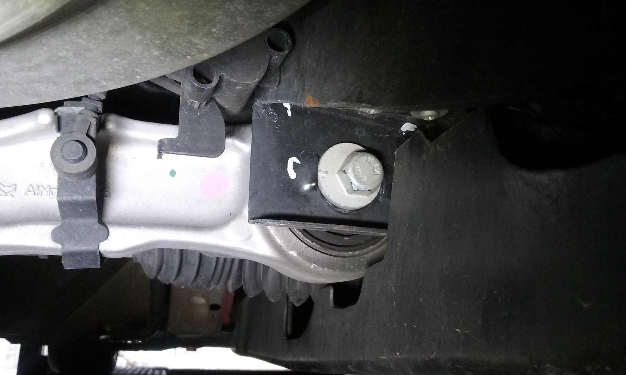

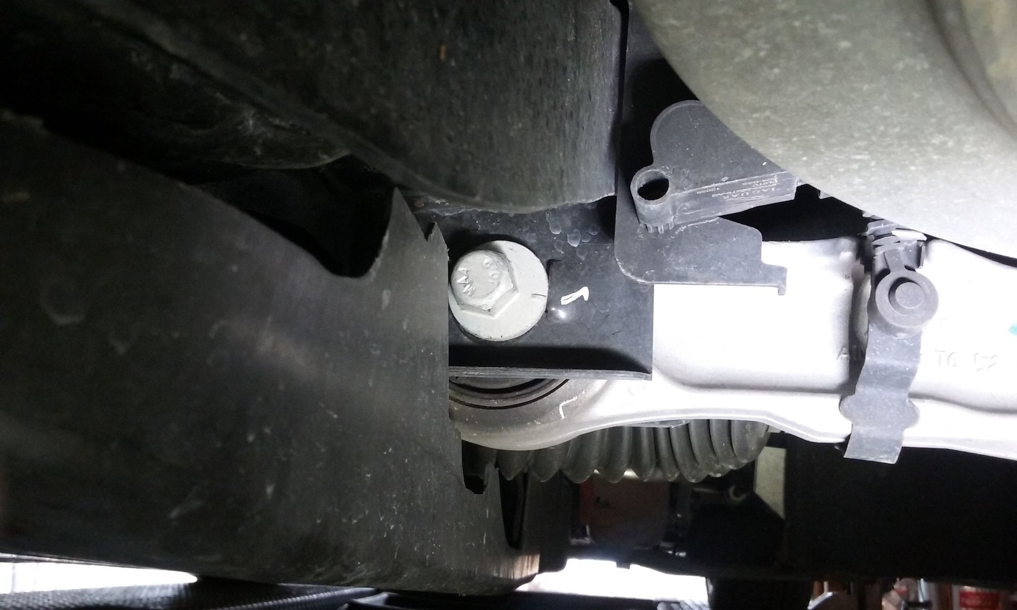

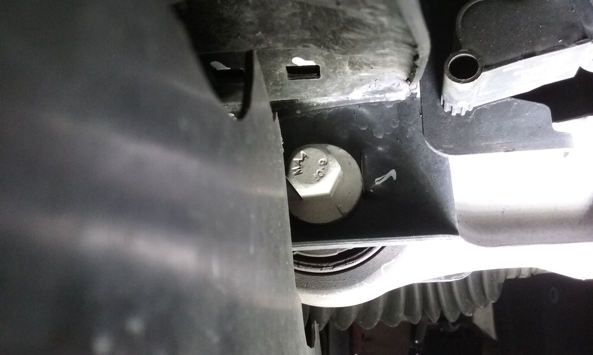

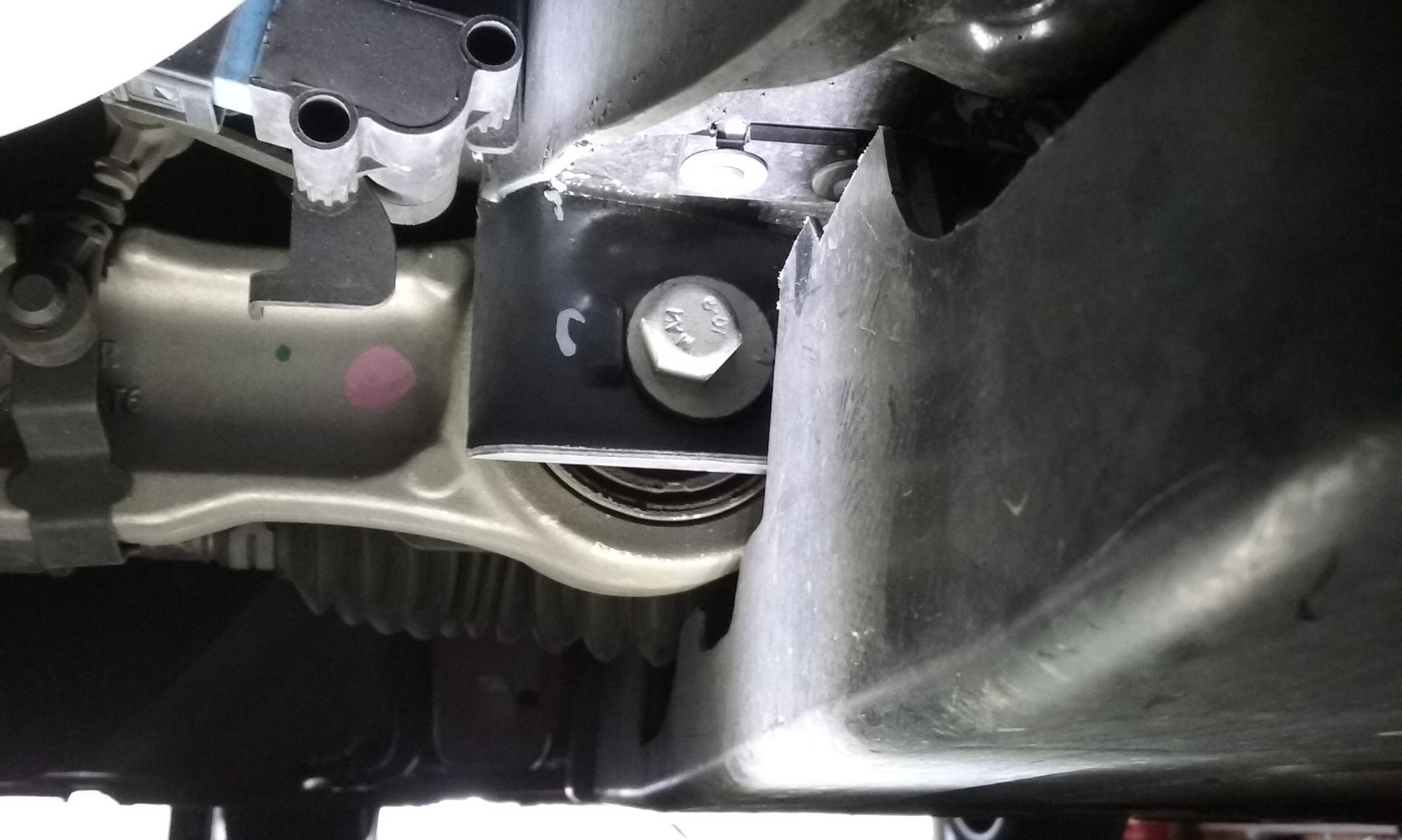

When I had my alignment done here is what the data sheet looked like from the aligner. 1012 XKR conv.

looks like camber wear to me. Check struts, tie rod ends, ball joints, control arm bushings. Less likely, check the front wheel bearing.

At the time I was not to pleased but as you know the caster adjustment is more time consuming so being within spec was OK. Buy the way this is the 2nd time I had them do the alignment as there were other parameters that were to close to the max. I looked at his 1st data sheet and had to escalate to the service manager to have him redo it. Funny thing was most of the adjustment lined up with the orign. factory marks. The 1st 2 pics are before and the 2nd 2 are after.
