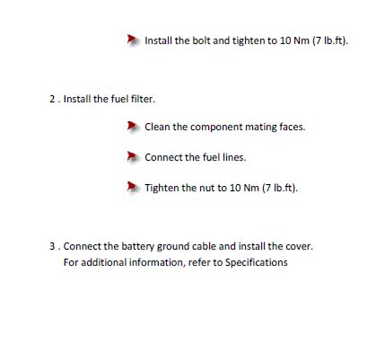

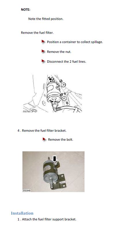

It doesn't look hard.
I snipped off the first few steps, which are basically disconnect the battery and don't smoke or wear static-ky sweaters when doing this.
Attached Thumbnails Fuel  filter replacement.-fuelfilter1.jpg   Fuel  filter replacement.-fuelfilter2.jpg

Thumbs up
Thanks, but I already had this info from my Alldata and X150 CD.........
just wanted confirmation that the arrows mean 'press the buttons'.
Cheers, Adrian

It would appear so. But wear eye protection!
From the looks of it, you'd want something the same dimensions as OEM since you are reusing the bracket.
