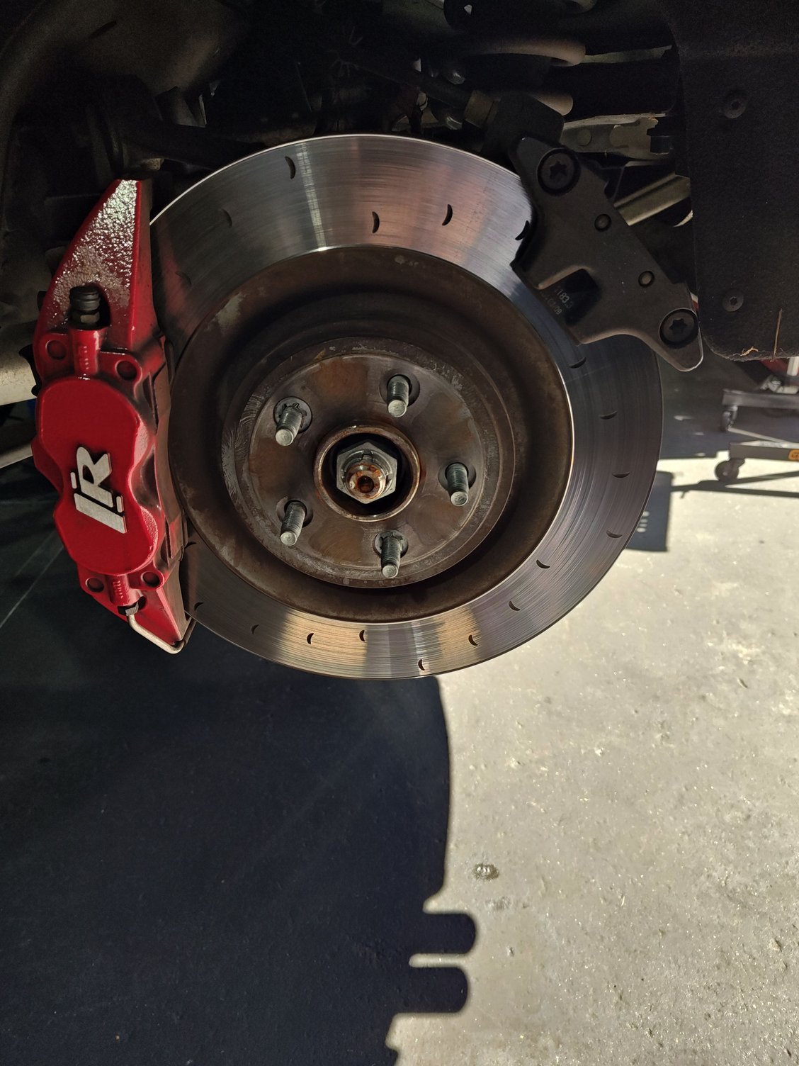

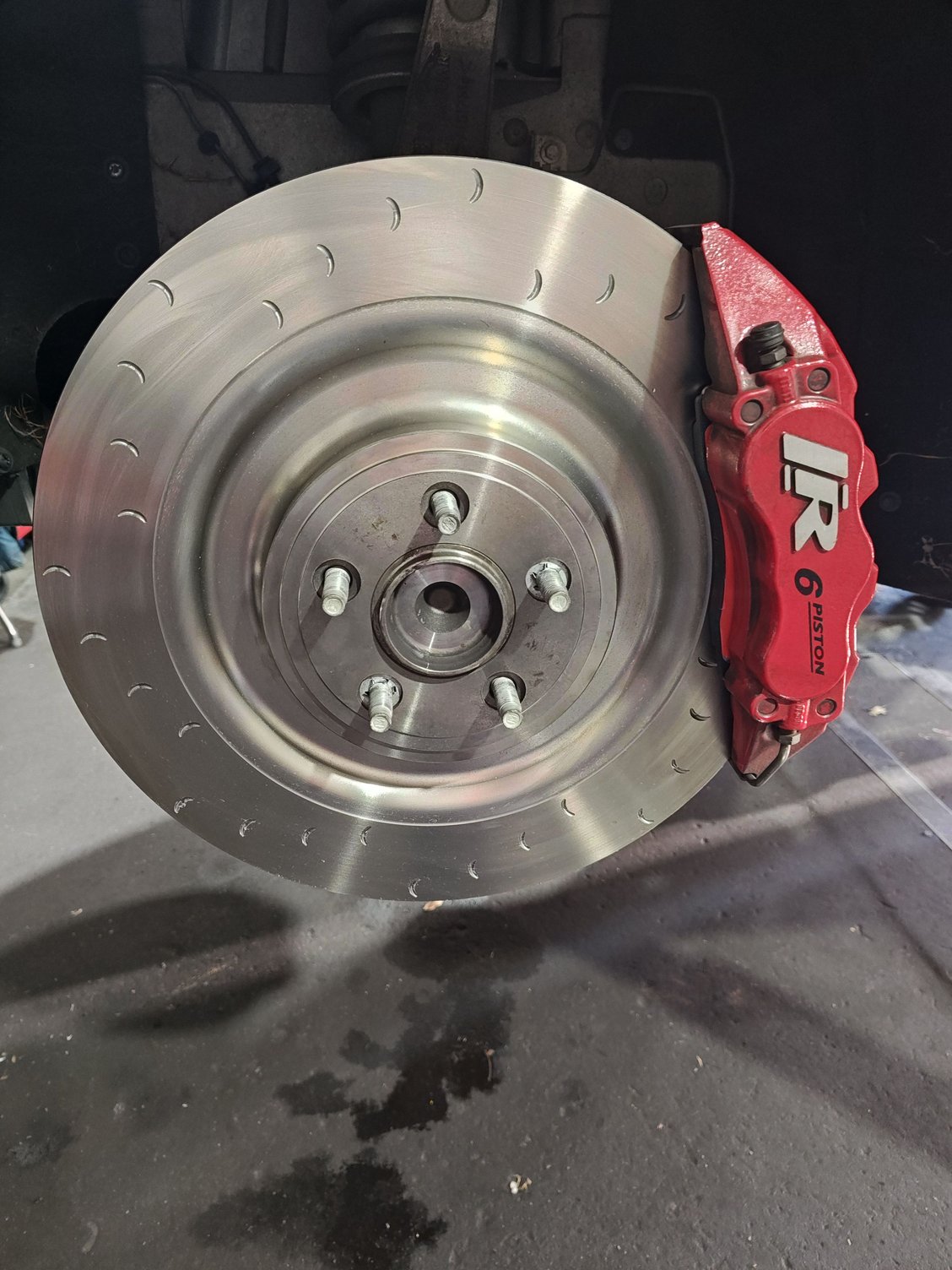

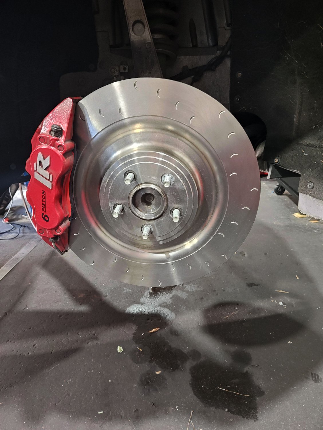

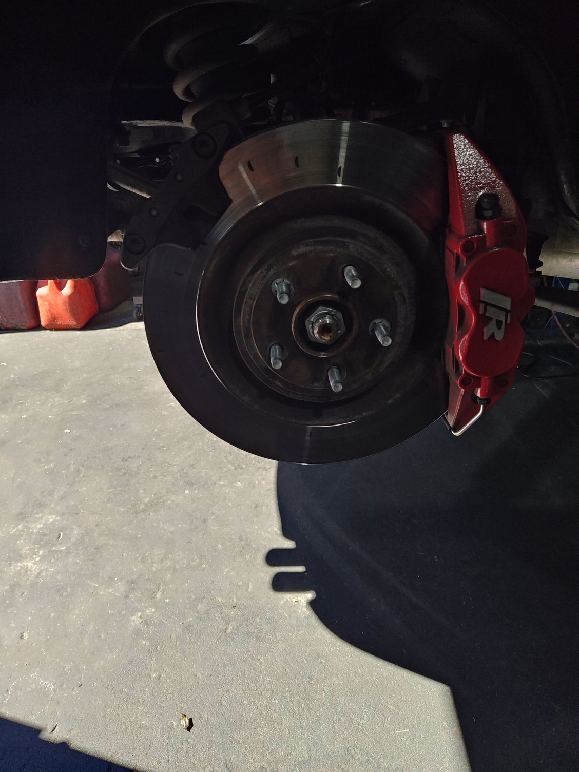

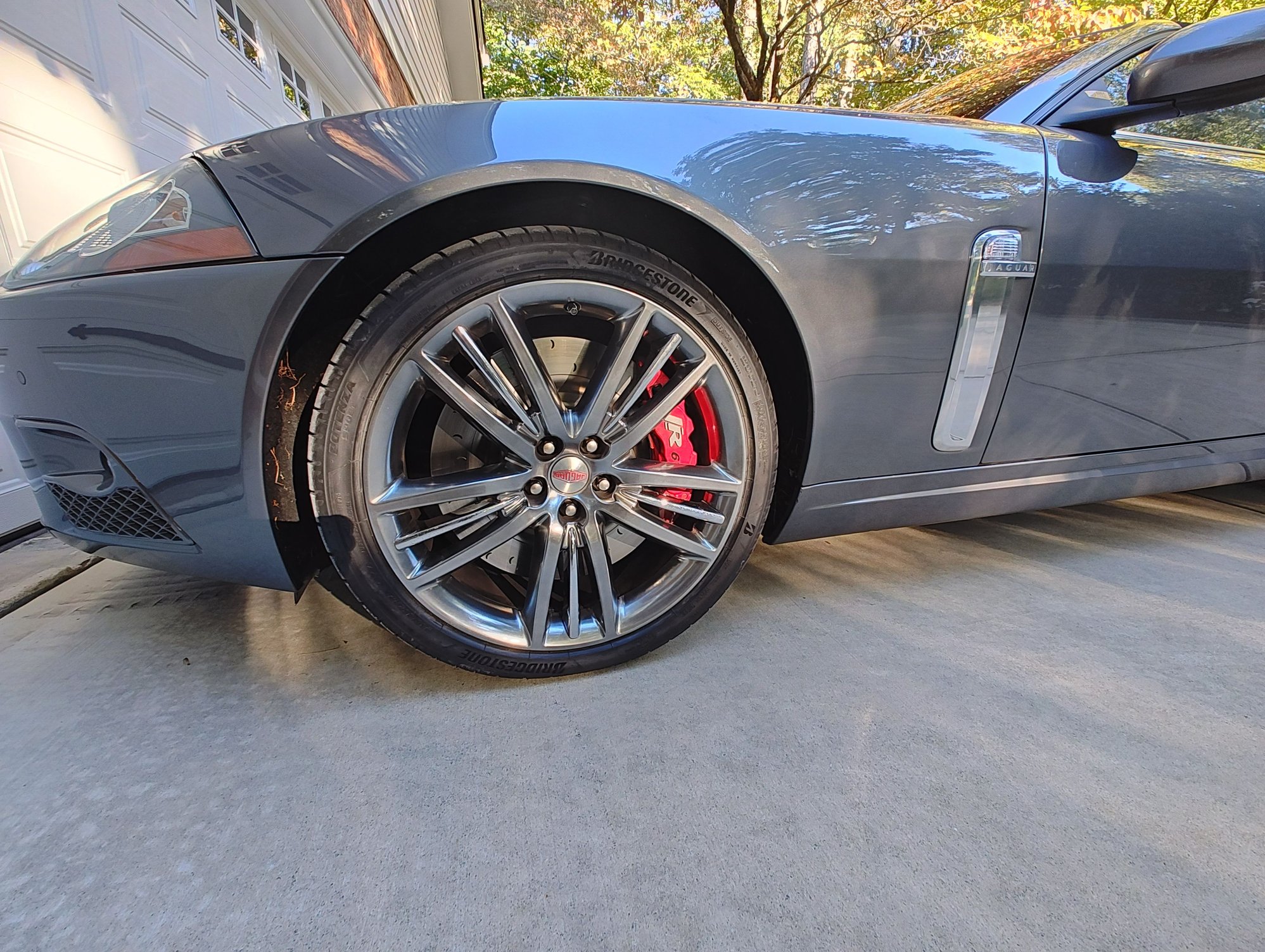

I resurrected this old thread to report that I had my original front and rear Alcon rotors replaced today with the bargain-priced Centric/Alcon rotors. To eliminate the excessive black brake dust produced by the OEM pads, I decided to use Brembo ceramic pads. My indie technician had no problems, and I carefully bedded in the new pads to transfer some of the ceramic pad material onto the rotors. Braking is quiet, smooth and straight but it's still too soon to brake hard and activate the anti-lock brake system.
Attached are several photos of the installation - before and after. My original front rotors were deeply scored and worn so thin that the crescent shaped grooves were barely visible.
OLD ROTORS
Rear Left
Rear Right
Rear Right
NEW ROTORS
​​​​​Front Left
Front Right
Left Side
Left Front Closeup
Total labor, including shop supplies, was very reasonable at $421.20. PM me for my indie technician's contact information in Sandy Springs, GA.
