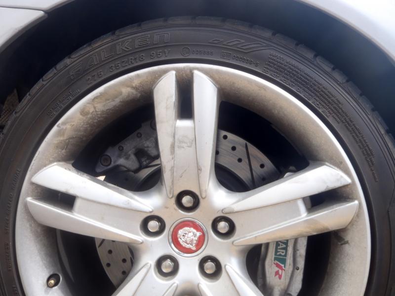

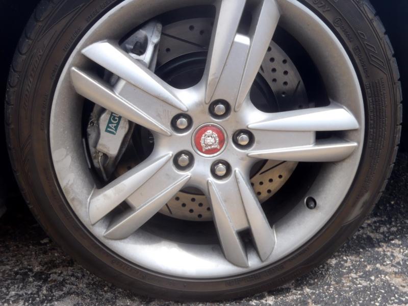

The front rotors appear to be centric. I know they may be put on backwards but it doesn't really make a difference...Also, I know my wheels need a cleaning...

It was always my understanding that drilled and slotted rotors are directional.

You're 100% correct; the question is, if you put them on backwards how much of a difference will it make? There isn't an one size fits all answer as each application is different. Technically the internal fins direction trumps the holes/slots direction as far as cooling is concerned. I checked out my buddy's M Z4 that came with OEM drilled rotors that he's never changed and surprisingly his rotors matched the direction of mine...Just looks backwards to me...

Installed them a year ago on my 3.0 S-Type along with pads from R1 concept. Definitely much better than original brakes. Your installation is fine, and yes they may look backwards.
