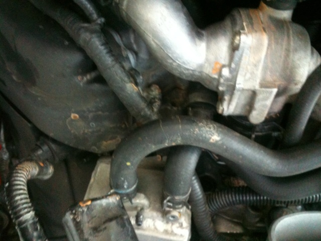

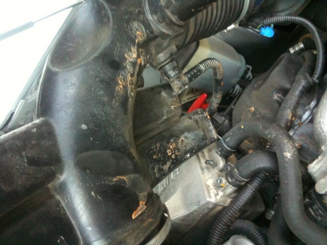

Here's some pics of the dried coolant which gives you an idea of the area....

Thanks for the pictures. Your car looks almost exactly like mine did. I bet with the pressure tester you will find it in 10 minutes. Keep the intake tube off like you have it. I hope it is a hose and not something with a gasket or a pinhole in the Aluminum somewhere.

looks like a tear in the T-stat gasket!

that would be my offical E-diagnosis on the coolant leak, if you can snap more pictures around the T-stat housing we can confirm that.
Thats the good thing about orange coolant, its not shy to let you know where its coming from, our engine bays are jsut too cramped to get a good look.
