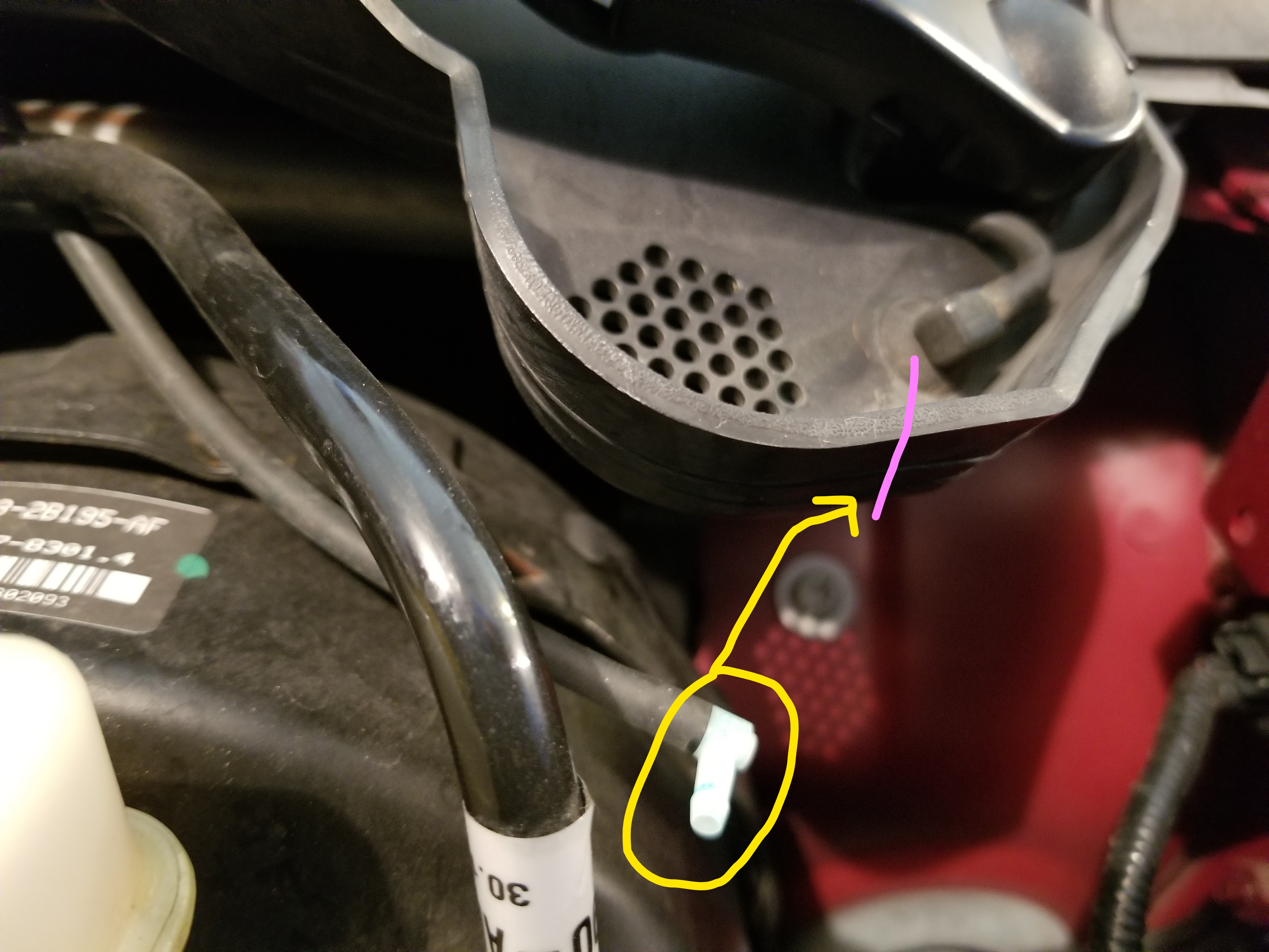

My driver side windshield washer spritzer stopped, well, spritzing, while the passenger side was fine.
The fault was the connector under the drivers arm being disconnected from the hose attached to the arm. See attachment: the yellow circled white piece (connector) goes into a rubber coupler under the arm marked by the purple line I've drawn.
All is good.
I have a suspicion that when I purchased the car used with 4 months of warranty, I had my local Jag dealer index (take the drivers wiper arm off the spindle) because it would bang the bottom. I presume he stretched the hose, and it took a couple of years to works its way out. Considering I hardly use the wipers, I can understand why it took so long to happen.
Other info is that I stupidly thought the nozzle was clogged. I could not figure out how to remove the nozzle. Turning it does not unscrew it, but rather allows one to direct the spray. It is powerful, at one position it went right over the roof and wet the hatchback window.

Had a similar problem when I first got my car. Found the driver's side washer hose disconnected at a tee near the center of the car, under the cowling below the windshield.
Put a small plastic hose clamp on it (leftover from the wife's hanging pot irrigation system) to make sure it doesn't slip off again.

Does anyone know what to ask for when looking for a replacement rubber grommet for the washer hose through the cowl? Mine disintegrated and I need to replace it. It's below the square plastic elbow in the diagram, and also shown in the above comment photo.

The only way to get a replacement grommet is to order the entire cowl.... Mine was in rough shape anyways, so that's what i did.

It's not a standard grommet... It's a high pressure rubber elbow that the plastic connectors for the washer line fit into.
