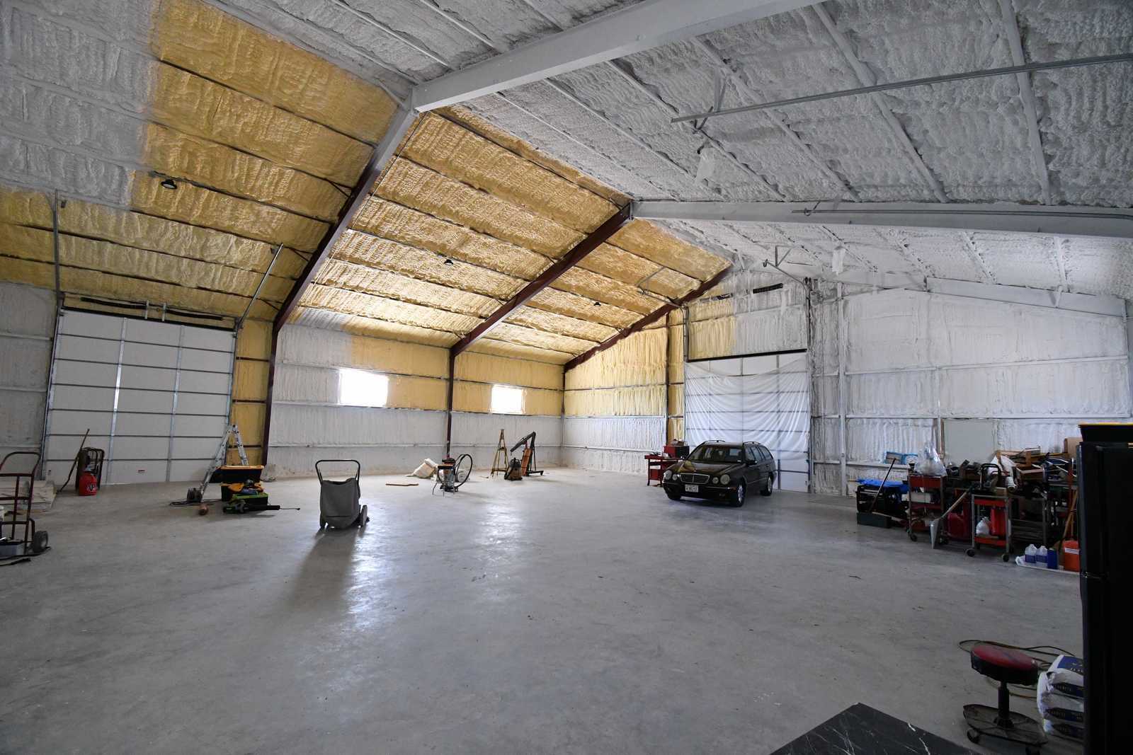

an old friend of mine has retired and if finishing up his new home and 'shop'. Not roll up doors but this spring afair also works well.
wj
wj
Nice and clean install there. Sadly traditional openers won't work on those either without drastic rework on the connection apparatus. I guess the pitched one would with the opener pitched. Not a fit for my install though.
That’s one heck of a ‘shop’! He could put basketball courts, tennis courts, hockey rink, football field, airplanes, or any number of things in that monster!
Old Dec 21, 2023 | 07:56 PM
  #40
wymjym's Avatar
Joined: Oct 2016
Posts: 1,764
Likes: 1,238
From: near Austin
Yep two lifts are going in, he has several cars he wants to tinker with
WJ
