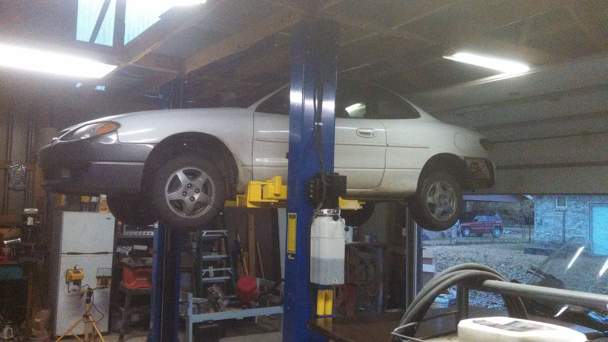

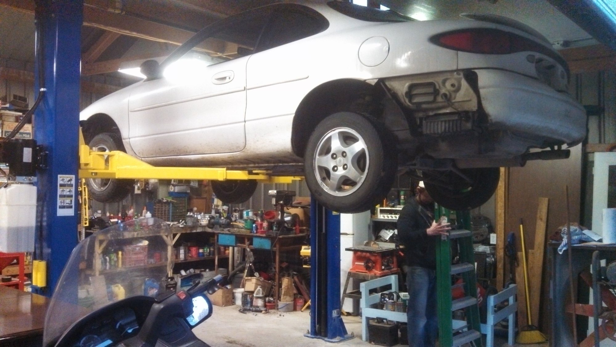

Have had 2 foreign made 2 post Lifts . 1st one was standard 7000 lb lift. Worked OK no Issues.
But , was a floor plate. traps trash
2nd one was / is a 9000 Assemetric Lift , Overhead Beam Much Better . Lifts my F350 with no problem. Will post pic later
$1800 deliverd to a cargo station , they loaded it on my trailer need 2 people to install and a GOOD Concrete Drill and bit. More later

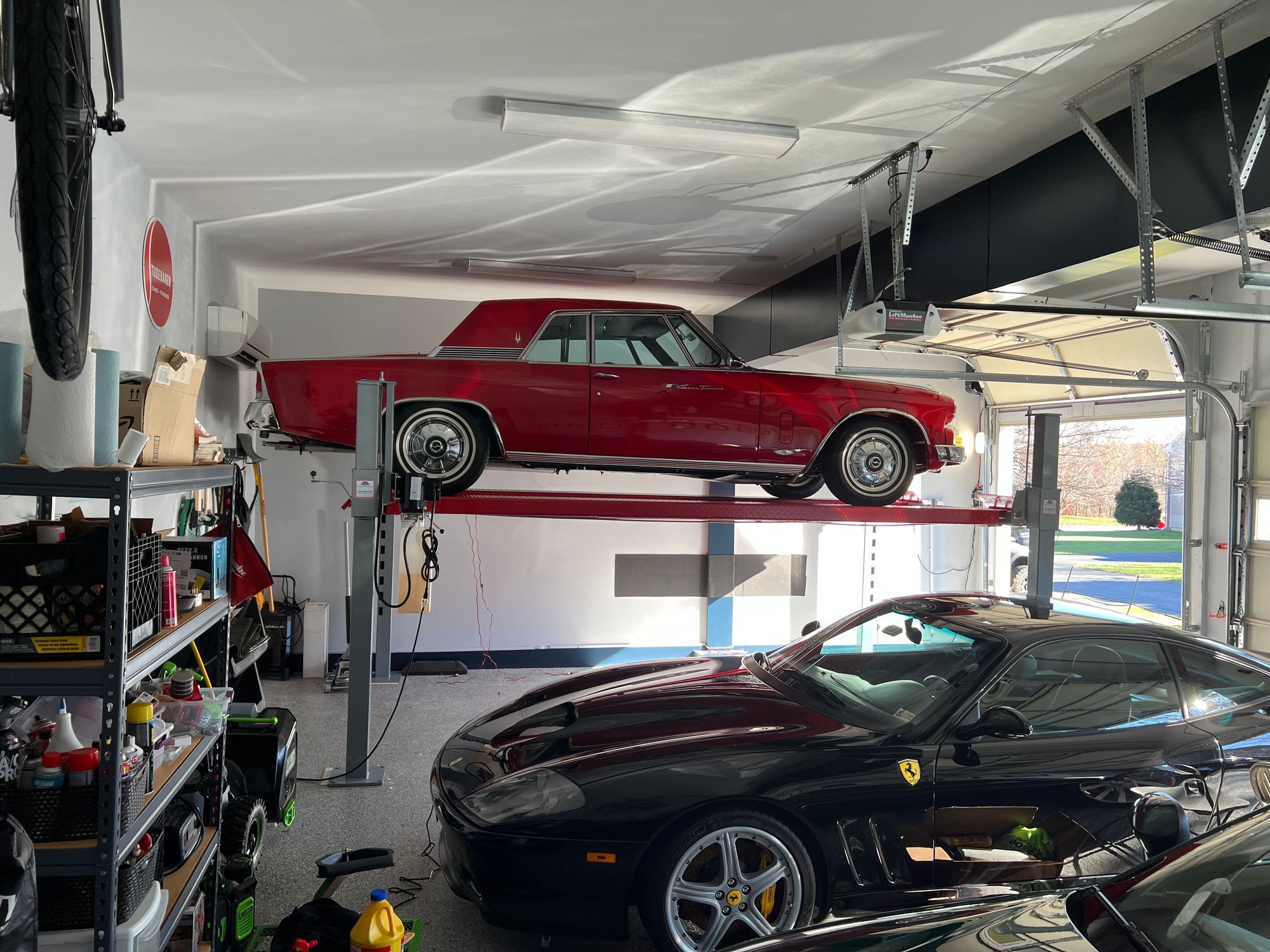

I have a Tuxedo 4 post, seems to be of good quality, would buy it again. (I know you’re not looking for a 4 post, just offering some brand feedback.)

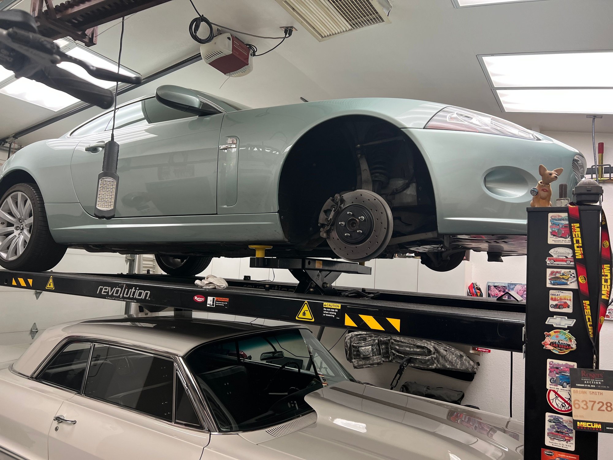

I have an Advantage 4 post lift with a low clearance ceiling. They made it easy.
https://www.advantagelifts.com/produ...antage-dx-9000
