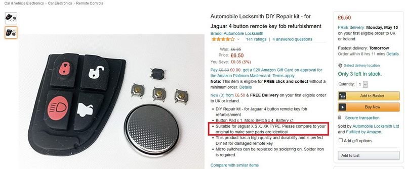

We get a lot of reports of failing fob microswitches on earlier models but I can't recall seeing any for X150 yet. However, plenty of listings for microswitches on ebay UK and Amazon so clearly much in demand.
