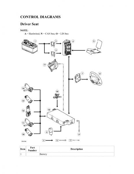

Old Jan 21, 2013 | 10:28 PM
CleverName's Avatar
Posts: 3,453
Likes: 882
From: Pacific Northwest
But still, that's not something that should need replacing regardless of who's paying.
I kinda have to agree... I can see one heating pad going out, but three?
However they are controlled by the CJB (Central Junction Box), which has been replaced via several other odd areas in our cars. Mine was because the dash steering wheel lights were out.
It (the CJB -item 4 in this diagram) seems to have its fingers in just about everything.
Vince
