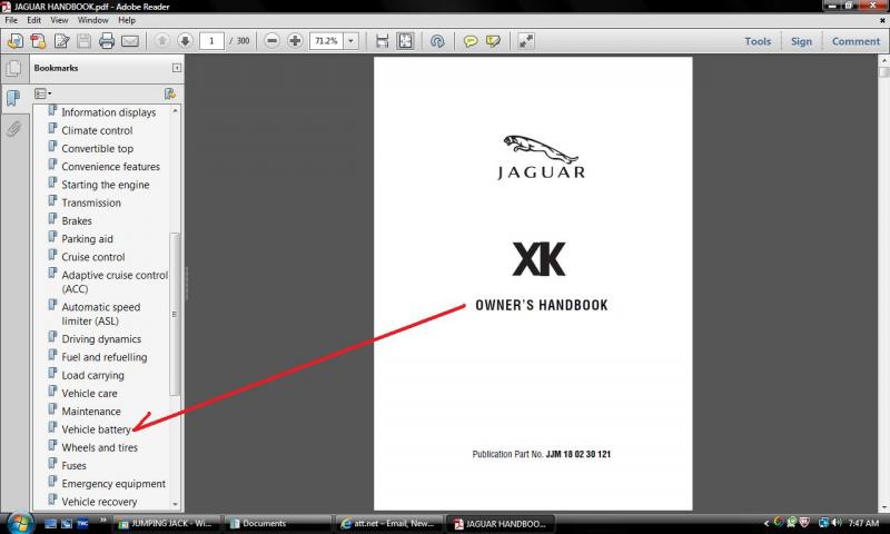

Here is a jpg or two of the remote jump start terminal on a 2007 XK. I've seen this terminal inside the car on the left side just behind the 'vent' in the left hand cover in the trunk area but never look below the car as is insinuated in a post above.
It is item #7 in the jpgs.
I believe if you look in the owners handbook you'll see this location somewhere. The negative post is also there but under the cover that hides the spare tire.
EDIT: The last two jpg are out of the Owners Handbook
Attached Thumbnails Help!  Battery dead, can't open the trunk!-jumping-jack.jpg   Help!  Battery dead, can't open the trunk!-jumping-jack-two.jpg   Help!  Battery dead, can't open the trunk!-trim-panel.jpg   Help!  Battery dead, can't open the trunk!-remove-trim-panel.jpg
