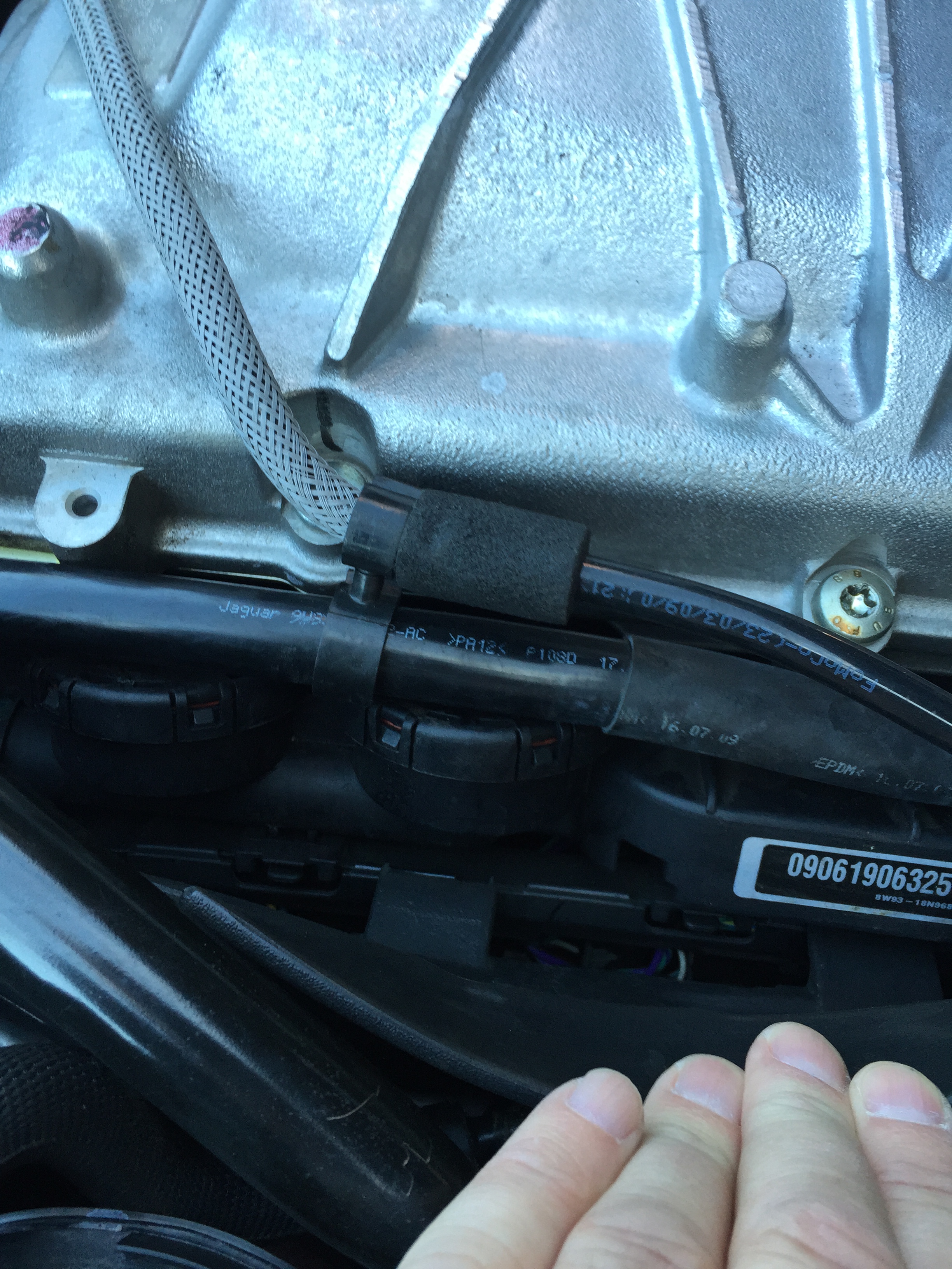

Mu XKR 2010 model have an issue when warm (100 km +) - it will not accellerate as it normally will
I have change air flow meters - I have had technical assist from Jag
We have tried to find any
Now my new mechanics suggest these vacuum "pumps" sound bad (noisy) and suggest I change them - see picture
Thanks in advance
Kren

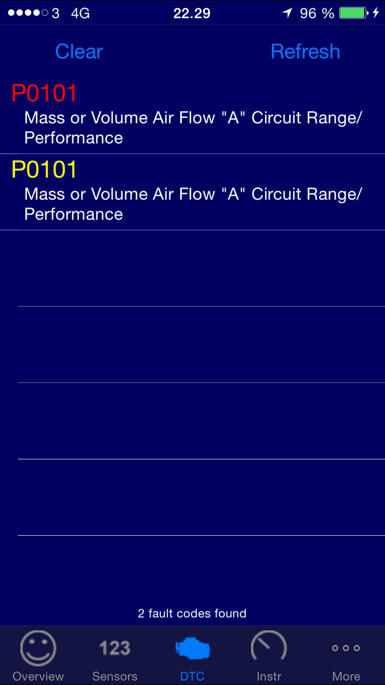

I have received diagnostic codes from my OBDII reader as well as the mechanics and actually also from a technical assist from Jaguar - we have tried and changed a lot and need new ideas - false air was not the solution
You can find the code from my private reader
Kren

From the workshop manual, possible causes for that code are:
  • Intake air distribution and filtering components incorrectly installed
  • Leakage from intake air system
  • Blocked air cleaner element(s)
  • Blocked engine breather
  • Blockage in intake air system
  • Mass air flow sensor seal failure
  • Connector is disconnected, connector terminal is backed out, connector terminal corrosion
  • Mass air flow sensor circuit, short circuit to ground, short circuit to power, open circuit, high resistance
  • Carbon build-up on throttle blade
  • Blocked injectors
  • Blocked catalysts
  • Mass air flow sensor failure
Test procedure to carry out:
  • Using the manufacturer-approved smoke tester, check intake air distribution and filtering components for leakage and correct installation
  • Check air cleaner element is free from restriction and in serviceable condition
  • Ensure the engine breather system is correctly installed and in serviceable condition
  • Check for mass air flow sensor seal integrity and correct installation
  • Inspect connectors for signs of water ingress, and pins for damage and/or corrosion
  • Refer to the electrical circuit diagrams and check mass air flow sensor circuit for short circuit to ground, short circuit to power, open circuit, high resistance
  • Make sure throttle blade is clean of carbon
  • Check for blocked injectors
  • Check for blocked catalysts
  • Clear the DTC and retest
  • Reset fuelling adaptions and carry out Powertrain Control Module (PCM) Long Drive Cycle Self- Test
  • Check and install new mass air flow sensor as required
Sorry, I've never had to troubleshoot a problem like this, so I can't give you any suggestions. But maybe the list above will give you some ideas.
