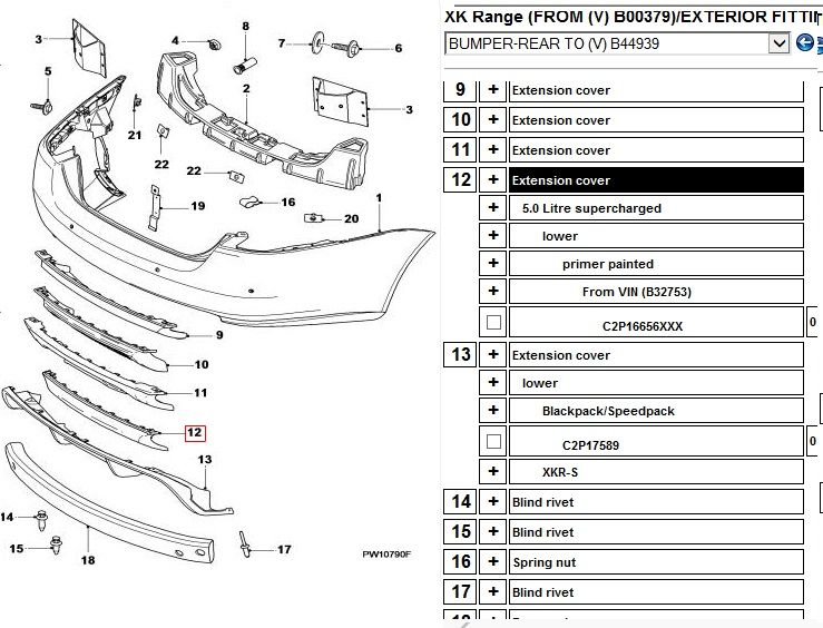

Does anyone have the Jaguar part number for the Late model XKR lower rear bumper valance? This part is shorter than the 2010, and later, XK valance panel allowing the exit of four exhaust tips. I am upgrading to 4 outlet stainless exhaust on my XK, and need to order one.

There are a couple of options:

Get in touch with Kris at Mina Galleries in the valley. He probably has some in stock. Check out the Mina Gallery website first. Also, I think it is actually called a diffuser.
As you can see in the parts list above, they try to confuse us simple folk, by calling it an ‘extension cover’. Wondered if I’d get the right thing when I ordered mine, but I did.
Exactly what the ‘extension’ is that’s getting covered, is beyond me.

Thanks to all. The parts diagram and comments are very much appreciated.
