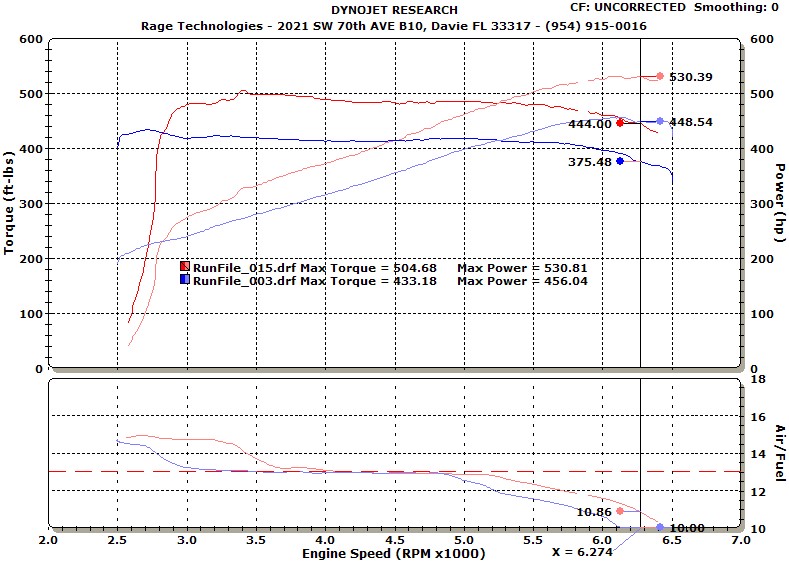

You absolutely have to have a tune as the stock pulley is capable of 9.5LBS but will get quickly cut back to a max of 9LBS. With a tune you will see 11LBS of max boost and a power curve that doesn't fall off over 5k.
Look at my pre and post dyno results, they are both with the same pulley.
Attached Thumbnails HELP: Substantially decreased MPG after pulley install-2013-xk-r-tuned-vs-untuned.jpg

The AFR readings are definitely too fat, without the tune. dialing that back nearer the high 12s, low 13s should greatly improve your response and fuel mileage.

This is how I felt after the pulley swap and faux tune. The car felt very strong down low as it should have but up top it was the same... Its just that when you already have 510HP of course it feel fast. When you get the tune look out!
