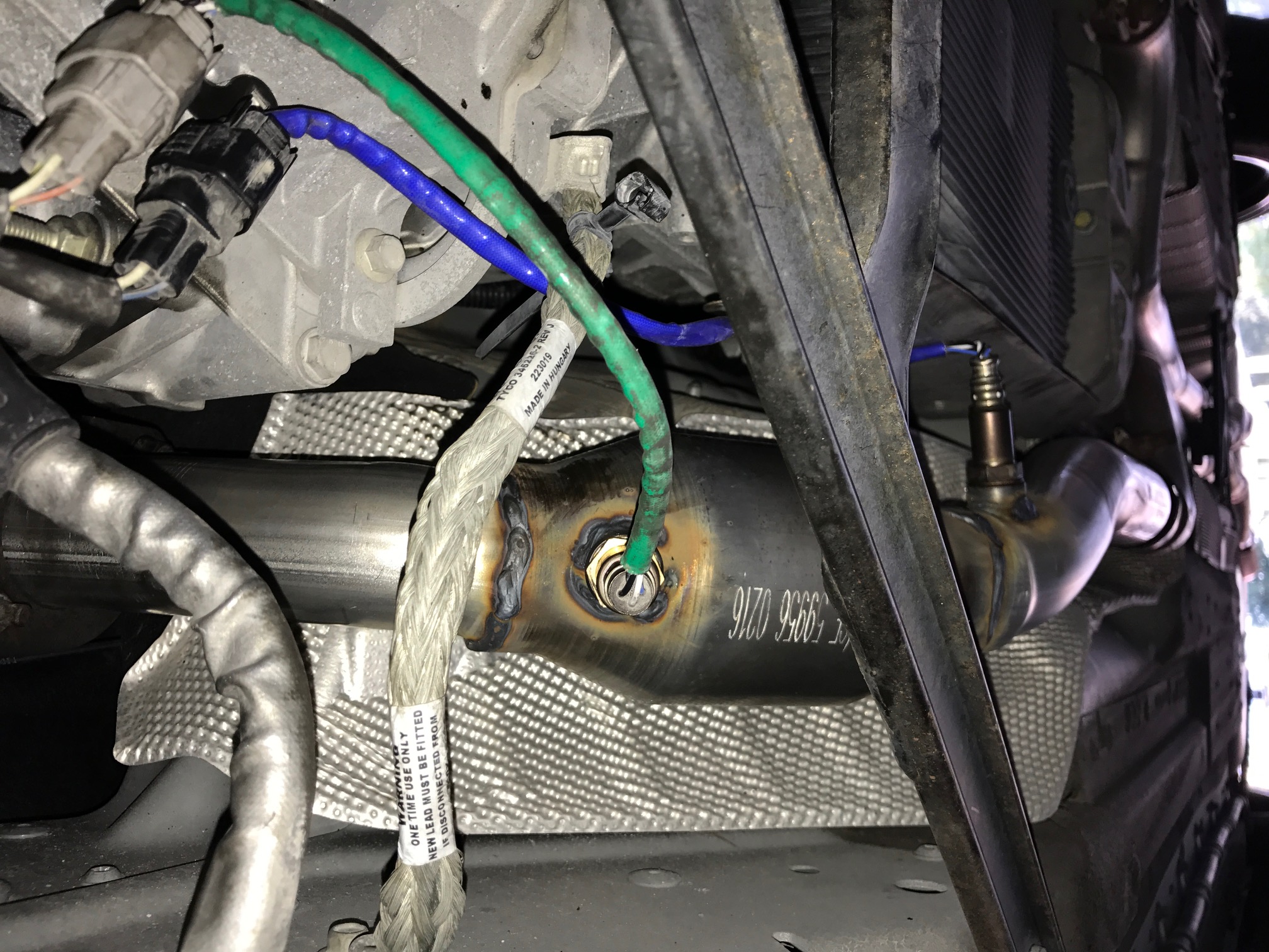

Got mine installed today. Not sure how I feel about them yet. Do feel a little more power. Will dyno to see if what difference they made. The exhaust note does not sound any different, just louder, especially the rasp. Keep in mind I have the factory rear box, larger custom tips, resonators removed and replaced with X-pipe and fuse 19 pulled. Going to try putting the fuse back in sometime in the next few weeks to see what, if any, difference that makes. Noise level at cruising speed seems no different, but the slightest touch of the throttle lights up the sound and at WOT it is brutal.

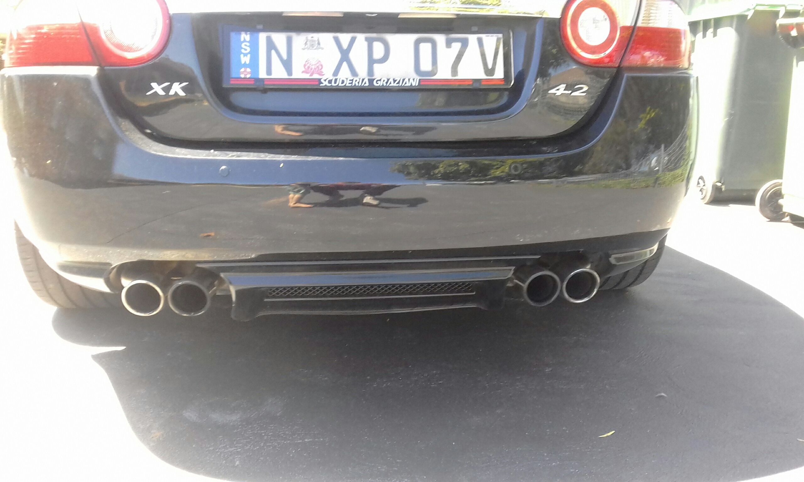

Good job jahummer
Your not wrong with x pipe and fuse pulled the noise is absolutely brutal
At moment I've got the two inner pipes going and shut the exhaust valves on the outer two
For me the sound is just about spot on .
