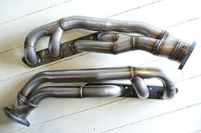

If only Badcat had merged cyl number 2 with 6 and 4 with 8 this would have been a perfect exhaust upgrade for us.
Attached Thumbnails HighFlow Cats 4.2/5.0-photo228.jpg
