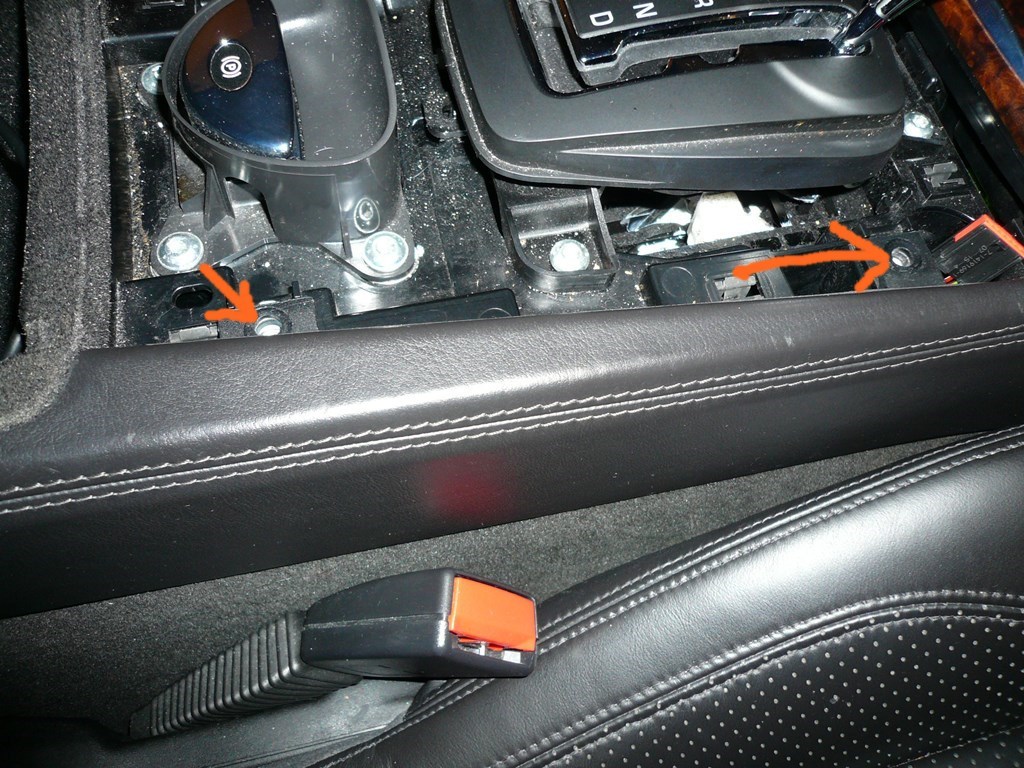

Remove the wood carefully around the shift select. I recommend plastic pry bars. Remove the little vertical black plastic trim just behind the ashtray. Remove the side leather covers on each side of the console removing these bolts:

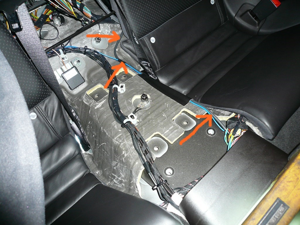

Now remove all the panels you'd remove to take out the battery. Also remove the left (drivers side in the US) inside panel.
Now the fun begins. I installed the HKS camp2 behind the back seat using 2 sided foam tape and a zip tie:

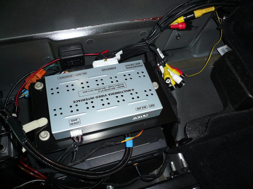

I installed the GVIF on top of the DVD stack with double sided foam tape:

Run the harness back to the Camp2:

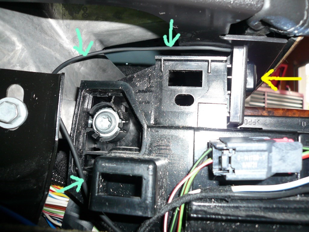

Now you have a few more wires to run. The screen switcher from the GVIF and the sensor for the HKS remote. This is where you use that little plastic trim piece behind the ashtray. Using a dremel make a couple of reliefs for wires on each side.

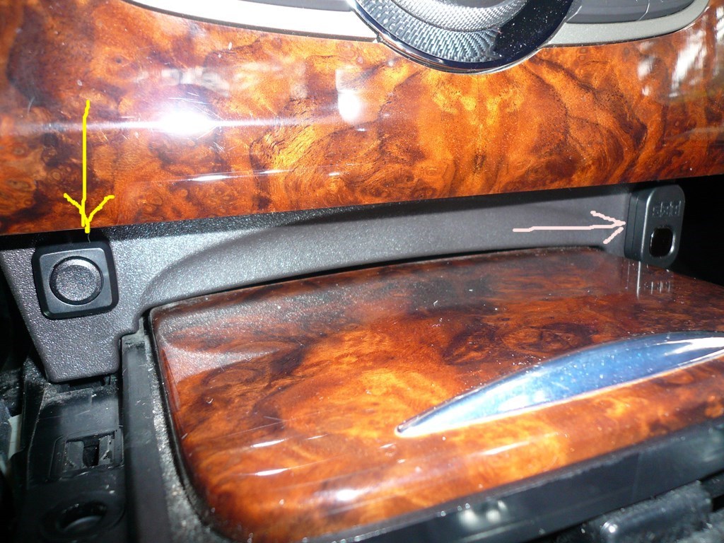

I mounted the switch on the driver side and the remote sensor on the other with foam tape. IMPORTANT: I later had to rotate the HKS sensor because it hit the shifter wood trim. Mount it horizontal!
Run the wires back to the respective box. One to the GVIF and the other to the HKS. Yellow arrow is the switch and the other is the wire. Same on both sides.Name:  P1030208_zpsumlnm6od.jpg

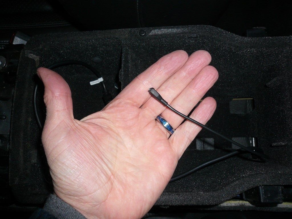

One more wire to run from the front is the remote sensor for the GVIF. I put it in the center console because once it's set up you're done with it.

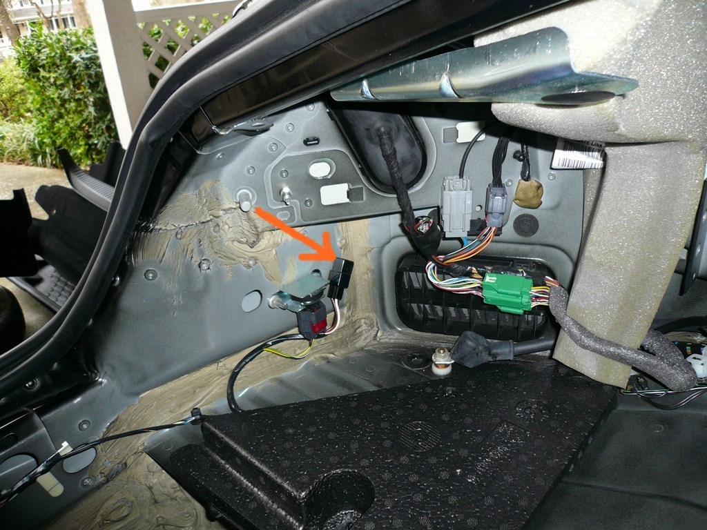

Now it's time to move to the trunk/hatch area. In the left side back corner you should find a dead end plug. This is an optional power accessory plug. This little jewel is switched power!!!
Again thanks to WhiteXKR, he told me about this!

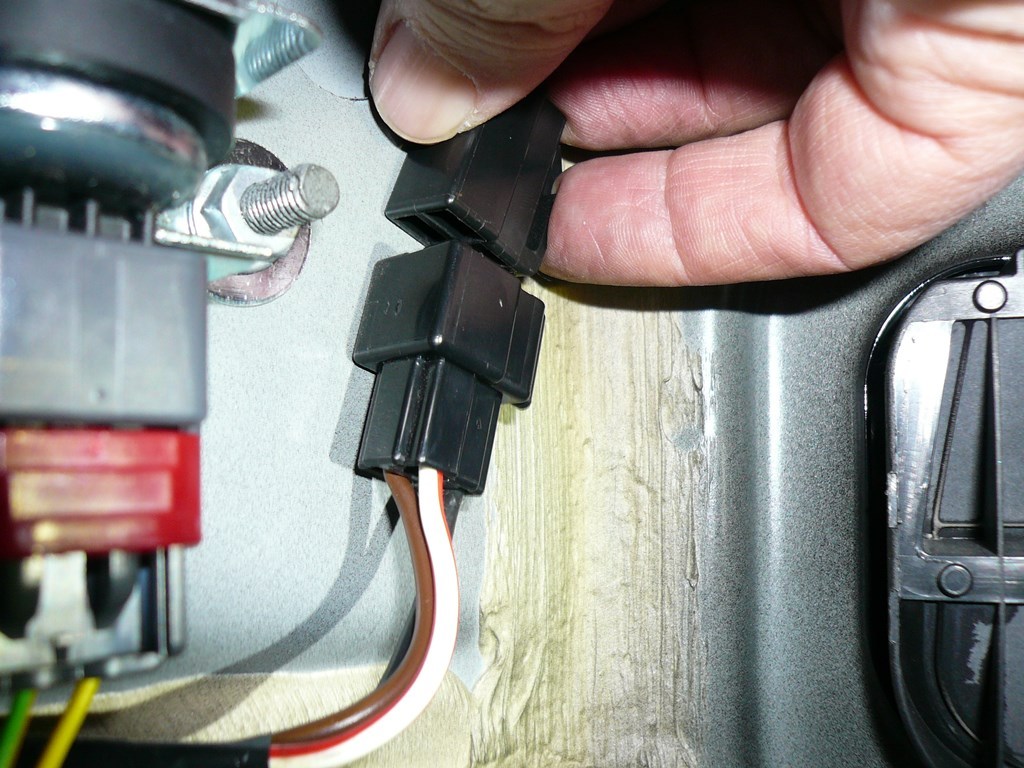

Remove the empty female plug.

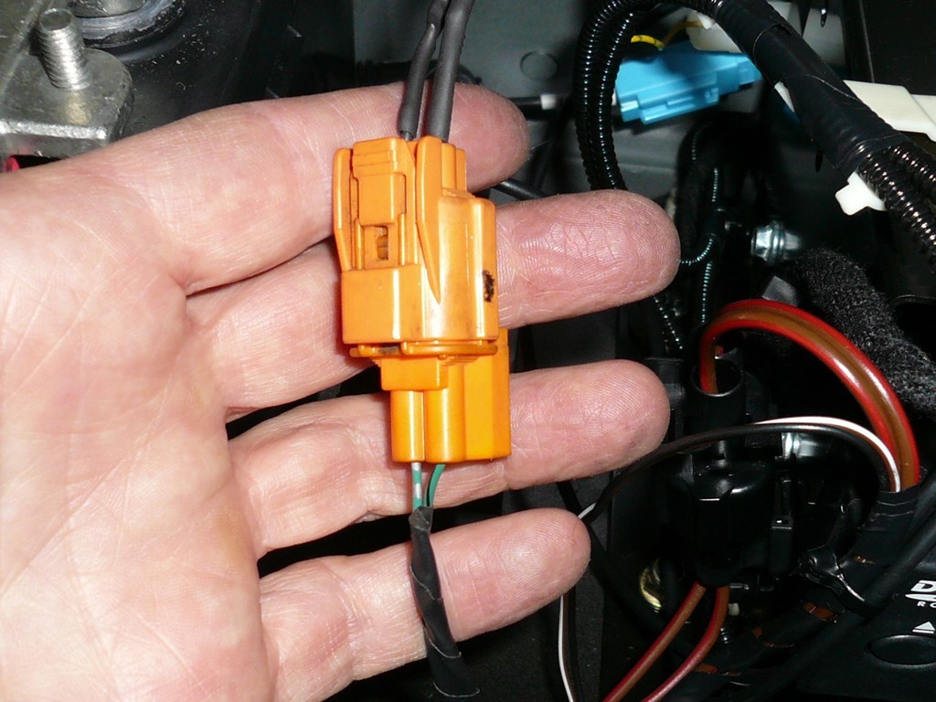

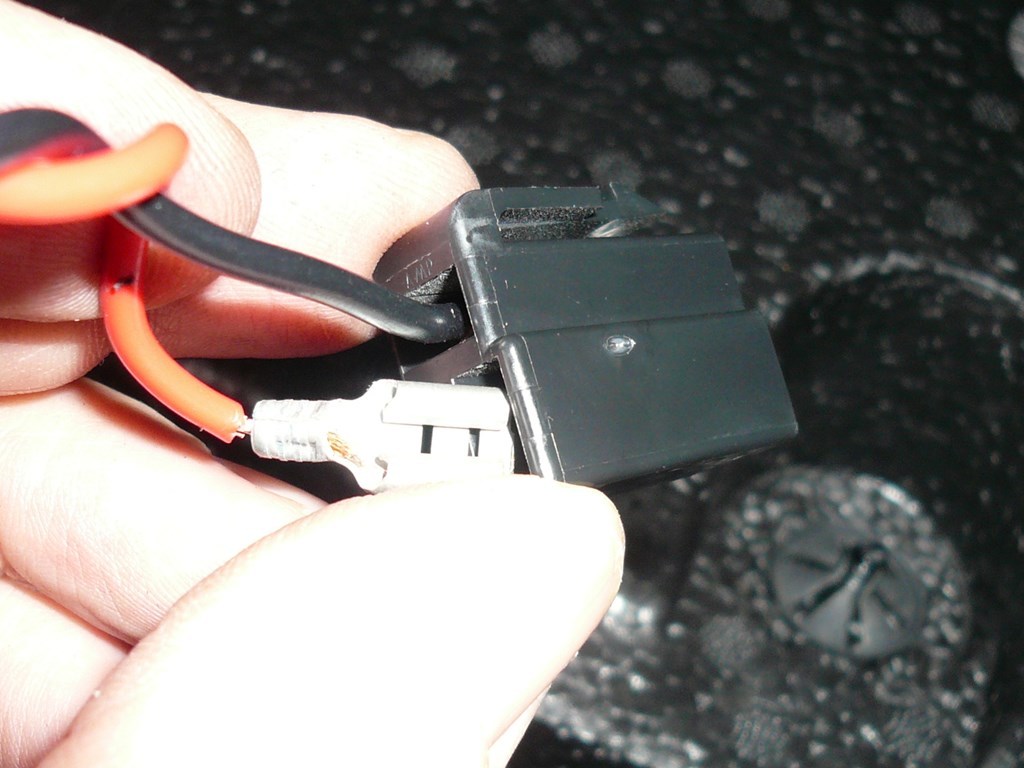

Unshielded 1/4 inch female connectors fit perfectly! Now you have two options. You can install the connectors to go to a sub fuse panel of your liking. Use this option if you plan a backup camera or other accessories in the future. Switched power is scarce in this car. Or you can just connect +12v and ground wires and run it straight to the GVIF area which is what I did. Either way you get power.
Empty plug:

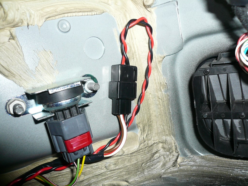

The white/red is hot and the black is ground so install the wires like so...
Orange arrow is ground, red is hot.

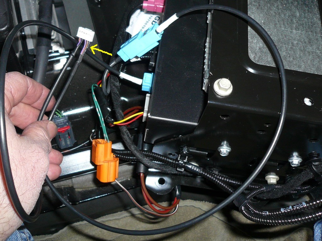

Plug in and run to the GVIF area:
Red and black twisted wire is the supply...

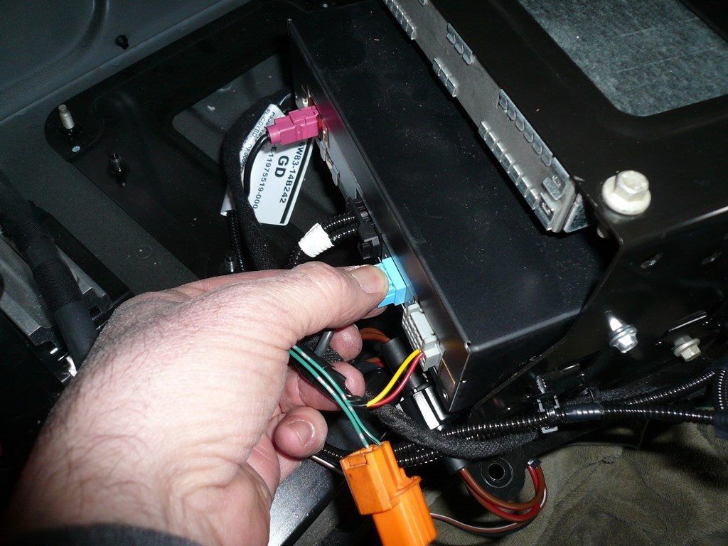

Unplug the blue plug on the DVD and install your modified cable:
How you connect your power and ground to the HKS and the GVIF is up to you. I used simple push/pull connectors. Connect the remaining wires to the GVIF. Remote sensor, video in, GVIF and power/ground through the attached fuse box. Select the dip switches to ignore the other inputs as necessary. If you use, say, input 1 only have that one "on". I didn't use the audio portion of the Camp2. Do not touch the canbus!
IMPORTANT: Dip switches 5 and 6 need to be: 5-ON 6-OFF for the XKR.
Attachment 155450
Attachment 155451
