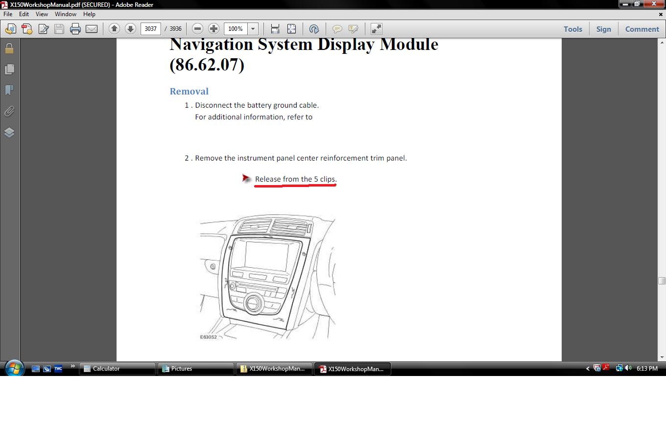

Old Sep 16, 2013 | 06:17 PM
Hailers's Avatar
Joined: Aug 2012
Posts: 379
Likes: 98
From: FORT WORTH TX
See jpg
