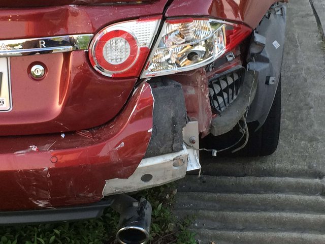

So my car was in a wreck today. After, I got a warning that the top was not latched. So I pushed the button to latch the top, no change. I pushed it the other way to see if the top would function. The back windows went down, then nothing. Tried to put them back up, but nothing.
I'd like to get the windows back up in case of rain. How can I trick the car and put them up?

Are you seeing anything on the message center screen? Since the rear is where the damage is it could be the trunk not or indicating it is closed or the luggage shade not in position. After my accident I had to push the top storage cover down to cycle the top since the body was a little bent.
My point is that it is probably something at the rear that is out of position because of damage.

The top will not operate if the boot is unlatched (except for rear window down, which you discovered). I suspect, looking at the damaged area, that the boot is not latching properly.
The rear window relays are contained inside the top control module and not accessible without significant interior disassembly.
I think a tarp is your best bet.

Looks like the strike has wracked the top and it can no longer make up the latch switches. Make sure the appraiser knows this fault is present when they run the numbers that will be included.

The top was up when I was hit. The top latches are still closed. Maybe it is the boot, but it does open and close, so it is not that bad. The rest of the top seems to be in great shape. Its a mystery to me.

I assume you can open the boot up . Did you check to make sure the to cover is in place. Also can you force the trunk closed so it latches.

I did check the cover. It seems OK. The boot does latch and unlatch, opens and closes.
