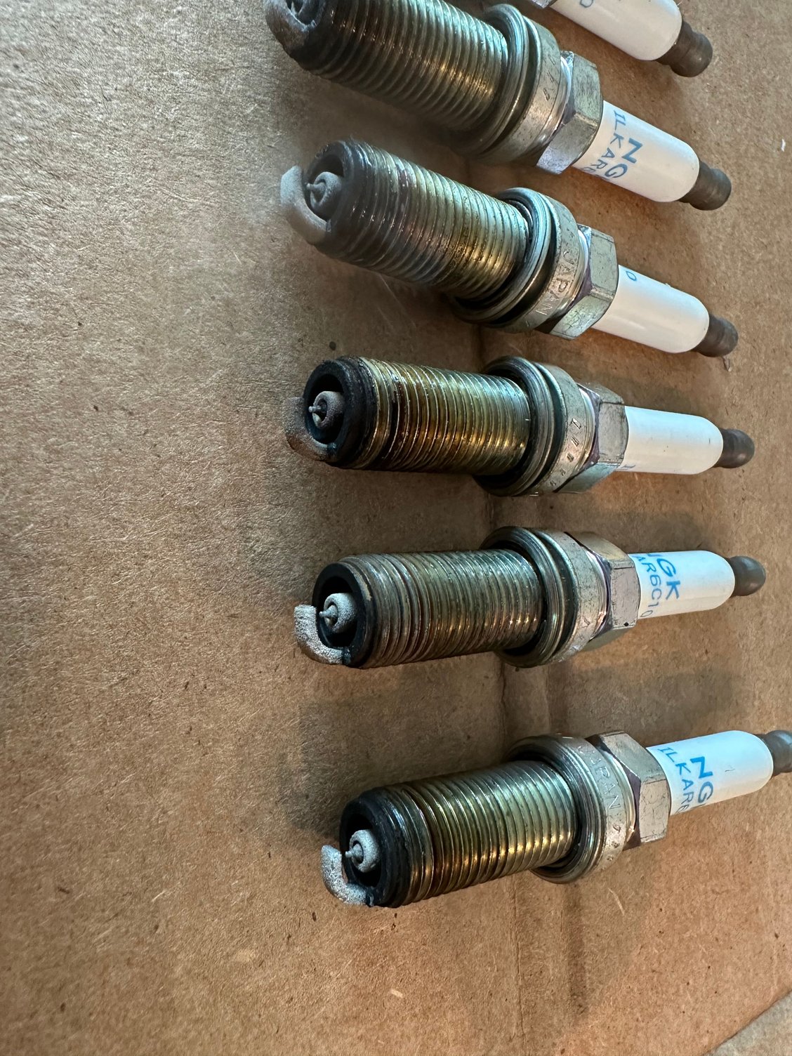

Set of new spark plugs. Start with easy and cheap.
Old Nov 3, 2025 | 11:14 PM
Street cat's Avatar
Joined: Jan 2025
Posts: 95
Likes: 47
Done recently - didn’t make a difference unfortunately
Plugs actually looked ok i think, just a bit old

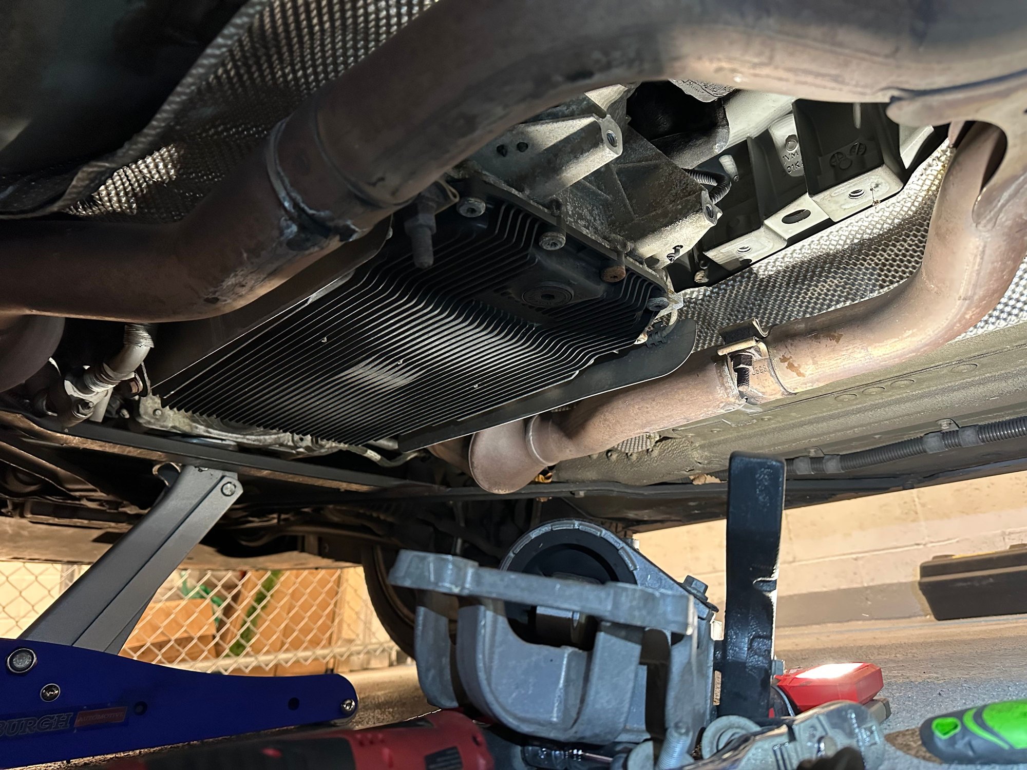

SOLVED THE ISSUE
worn transmission mount!!
old one was sagging about 1 inch and bottoming out on the metal so likely transmitting vibrations
popped a new one it and now it’s smooth as butter
