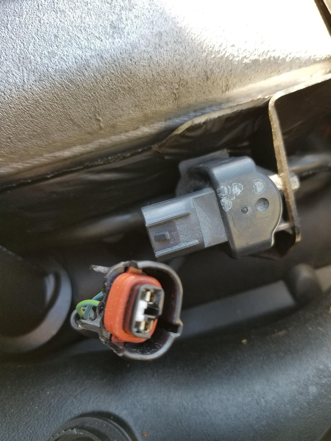

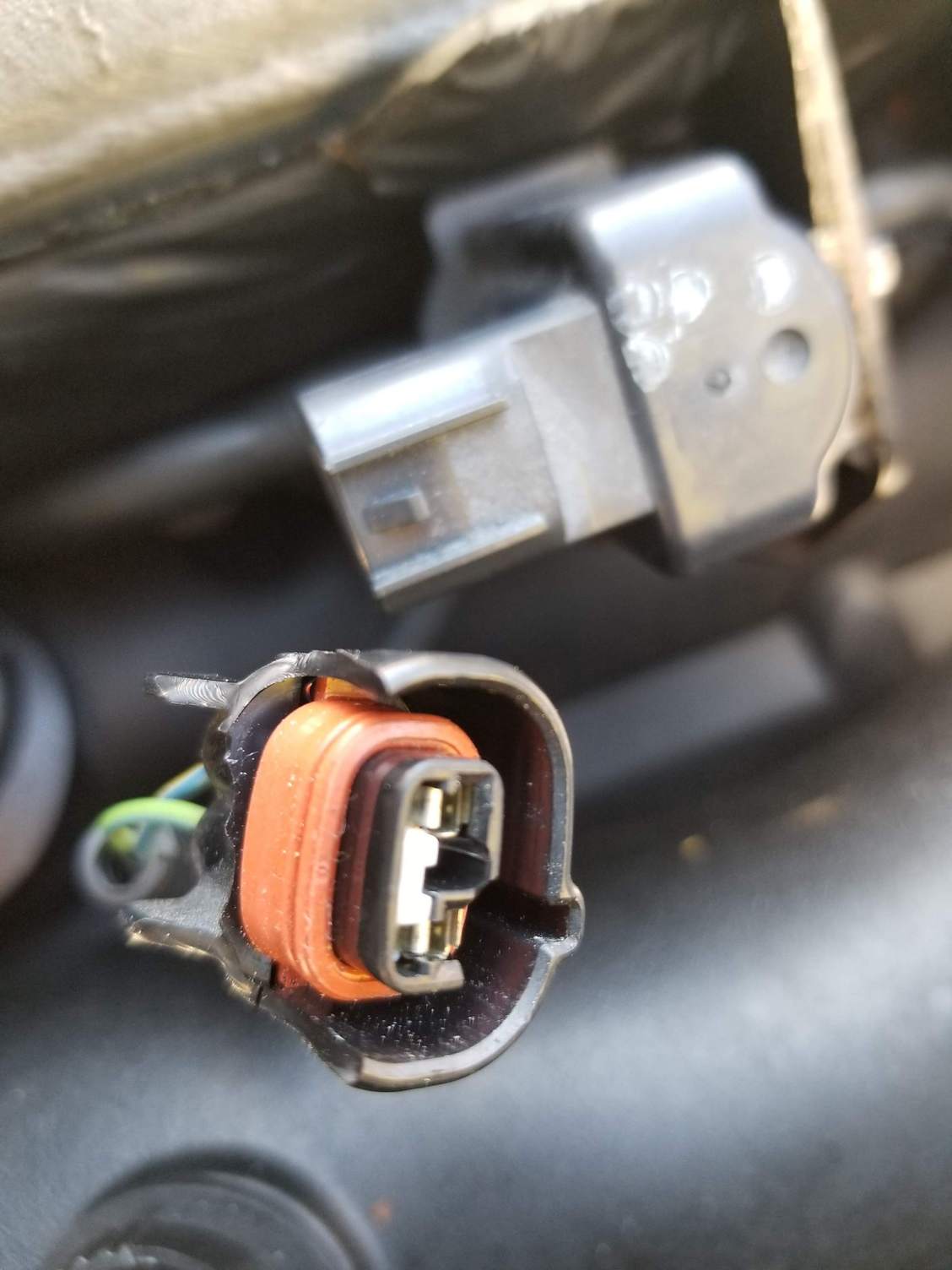

Can anyone identify the gizmo located above the left side valve cover that has a tube or hose running through it. Maybe a valve or sensor with a tube connected on opposite sides and a terminal connector with two wires. It appears to be an air line or breather hose. I really need to replace the terminal which has crumbled apparently due to exposure to heat. See photos.
I've searched online parts vendors, parts diagrams, the service manual, electrical guide, and electrical connector references. Does anyone know what this part is or what electrical connector would fit it??

If anyone cares...the gizmo is the Vapor Canister Purge Solenoid Valve - 4H23-9C915-AB which Jaguar calls the
Purge Control Valve - Jaguar (AJ810271)
As a result of the terminal connector crumbling further into many little parts I was able to remove it and inspect it. The connector housing has 11156 on it.
https://www.toyotapartsdeal.com/oem/...980-11156.html
