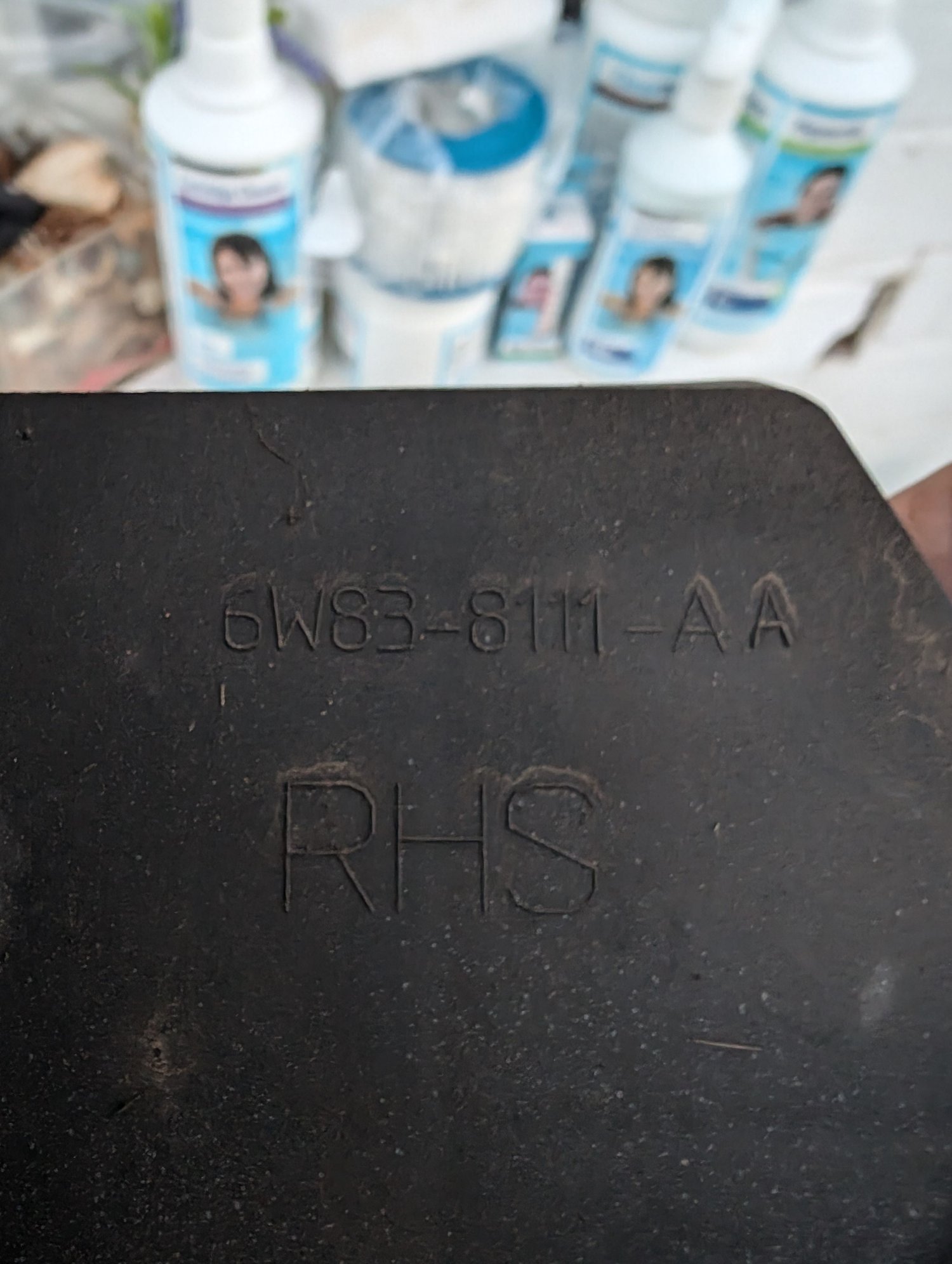

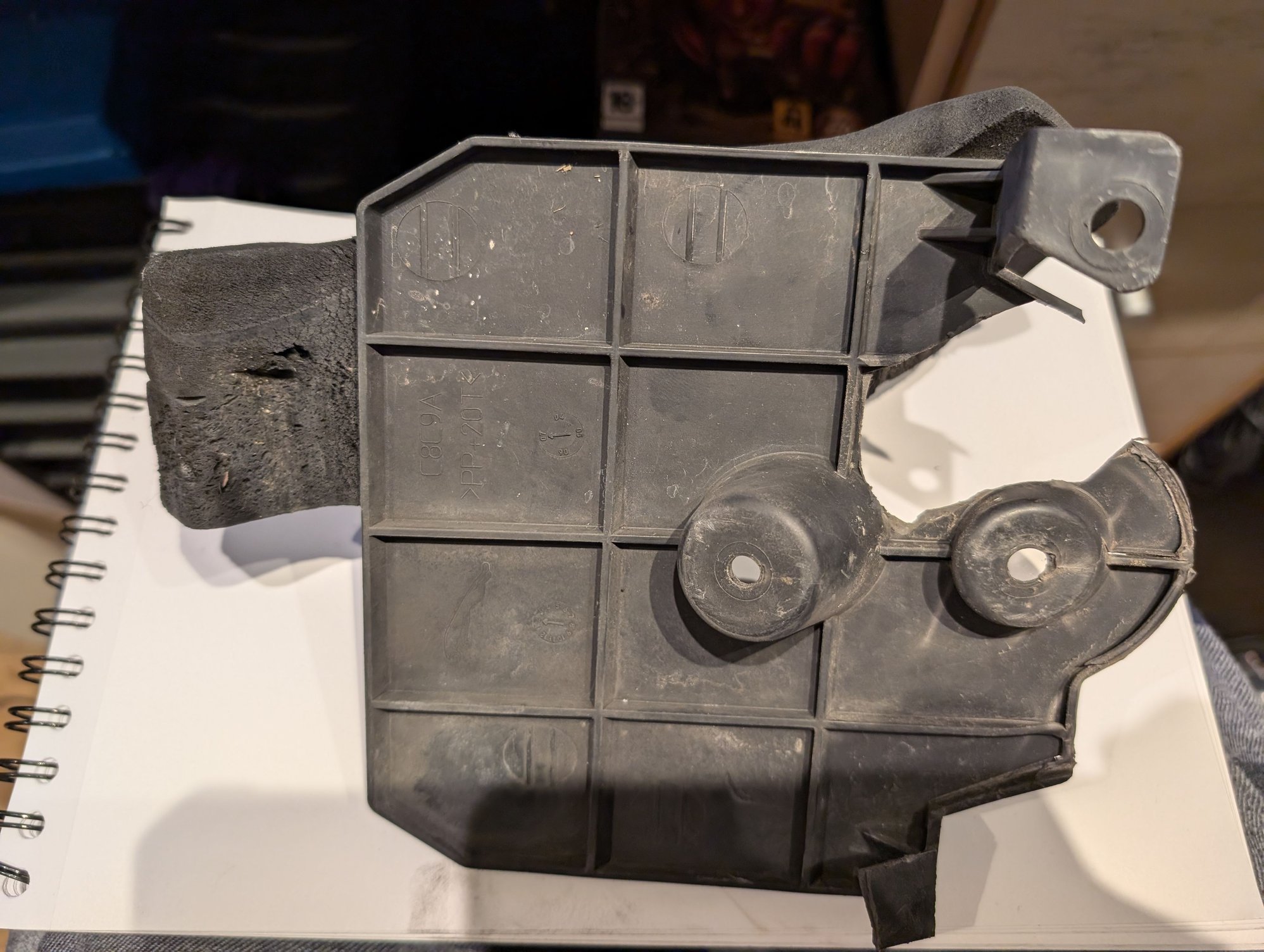

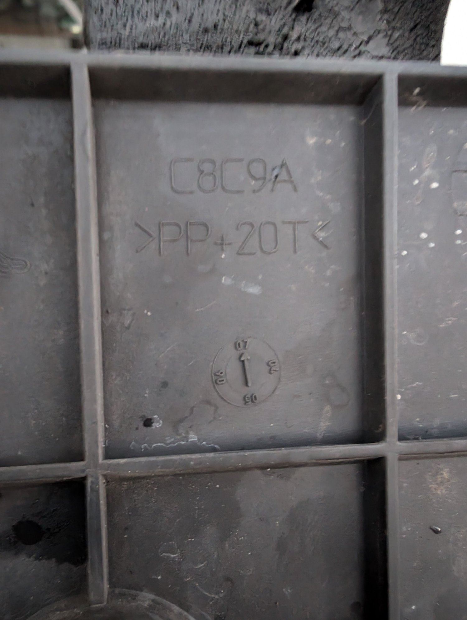

I took the front bumper off today to check a few things and cables. When I took it off two plastic parts came off, I assume they are normally bolted down but I cannot see where. Also they are damaged and I want to replace them. There is a part number however, I am unable to locate them in jpart.
Can anyone help me out on this? I have the one side photos as reference.it shows a part number of C8C9A this is the right hand side the left is mirrored.

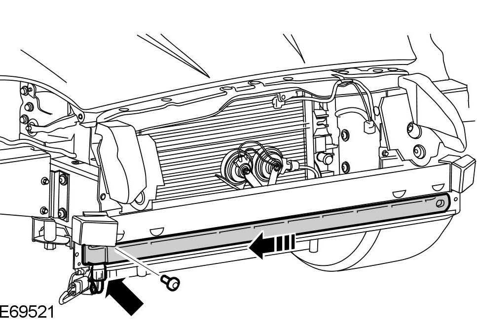

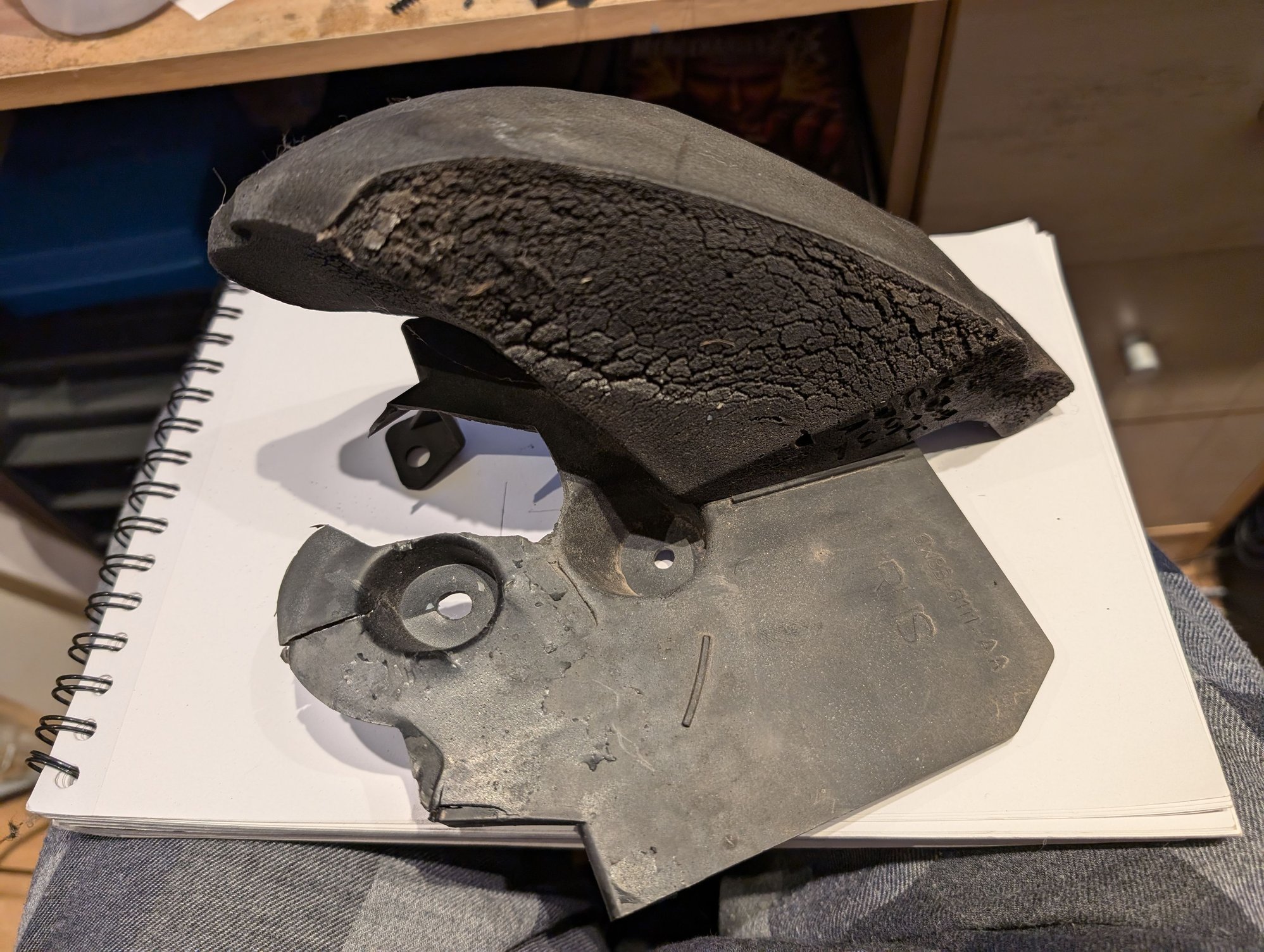

I did find this pic on the forum, are these the same as the two foam parts that are each side just under the edges of the bonnet next to the lights? These look different to my ones though.

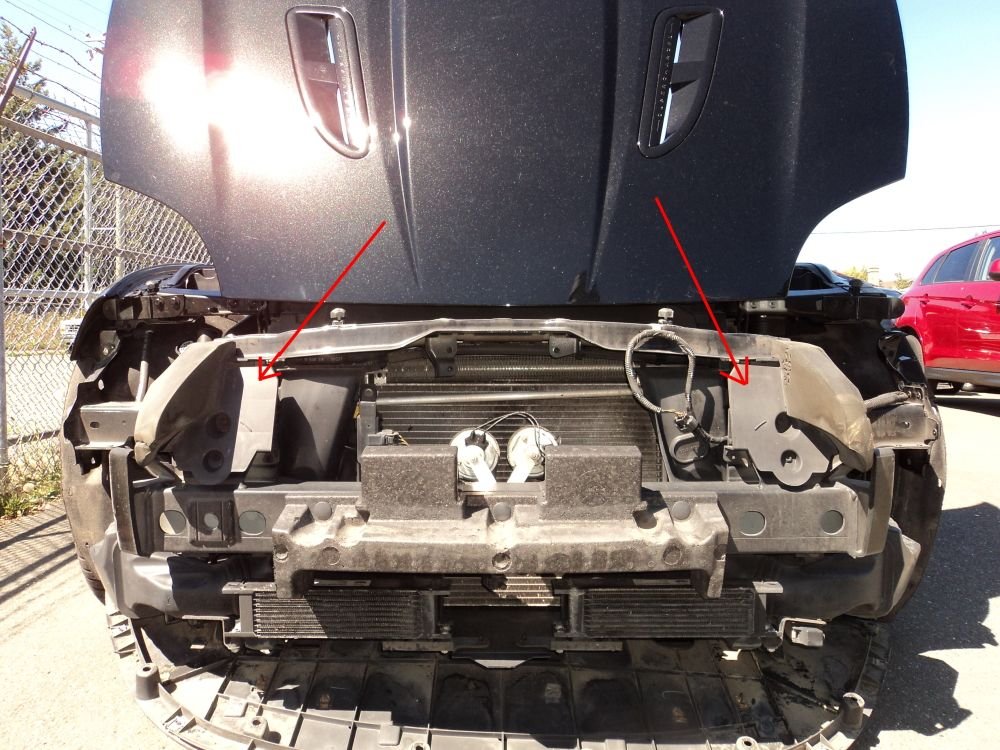

They look like the pieces arrowed here on my 2009:
This car is a 2011-2014, totally different animal on the front end>
@McJag222 posted a good picture for your year.

@Unclebuck Appears @McJag222 nailed it!

Another pic from the charm manual - 2009 - 2007 doesnay show much - no parts numbers to be found. If it was me I'd repair the parts with fibreglass mat and be done wiv it.

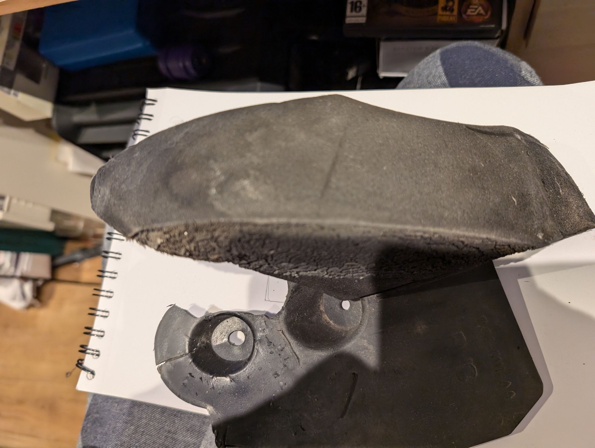

Many thanks both. I am looking at different laser scanners, now I have the large bed printer I can print things like this using carbon fibre reinforced filament. In the meantime I have done a repair on them as best I can.
Looks like the bumper has been off for a repair before and the body shop just couldn't be bothered to fit these back on properly.
The paint job was lazy and not done very well either, luckily the paint is the last thing I'm having done.

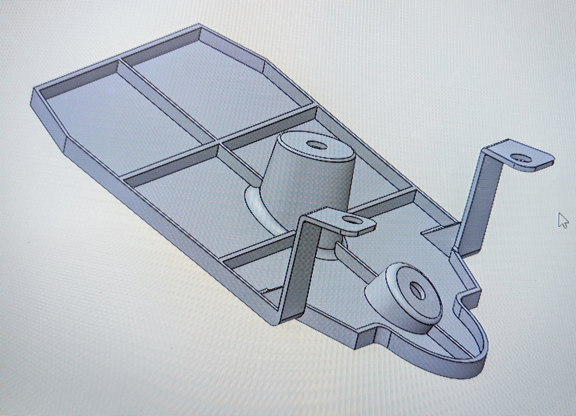

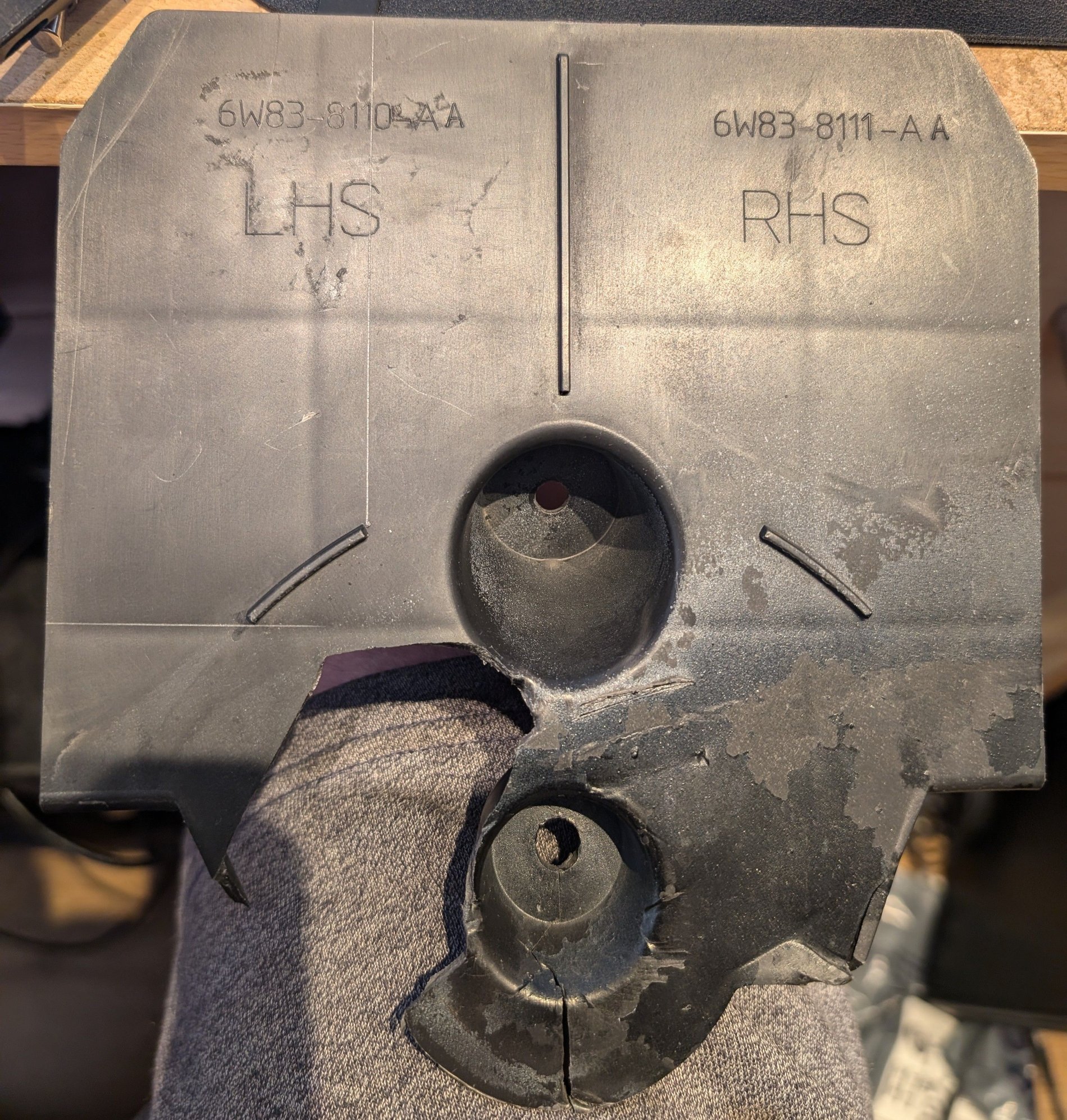

Been busy today, I decided to reverse engineer the part. It turns out it is a dual fitment part for the left and right hand side.
Just have to model the inner sections and I can run a test print. The foam is handed.
I just have to set the big printer up and run one off in the carbon fibre reinforced filament, if it fits then another one for the other side.

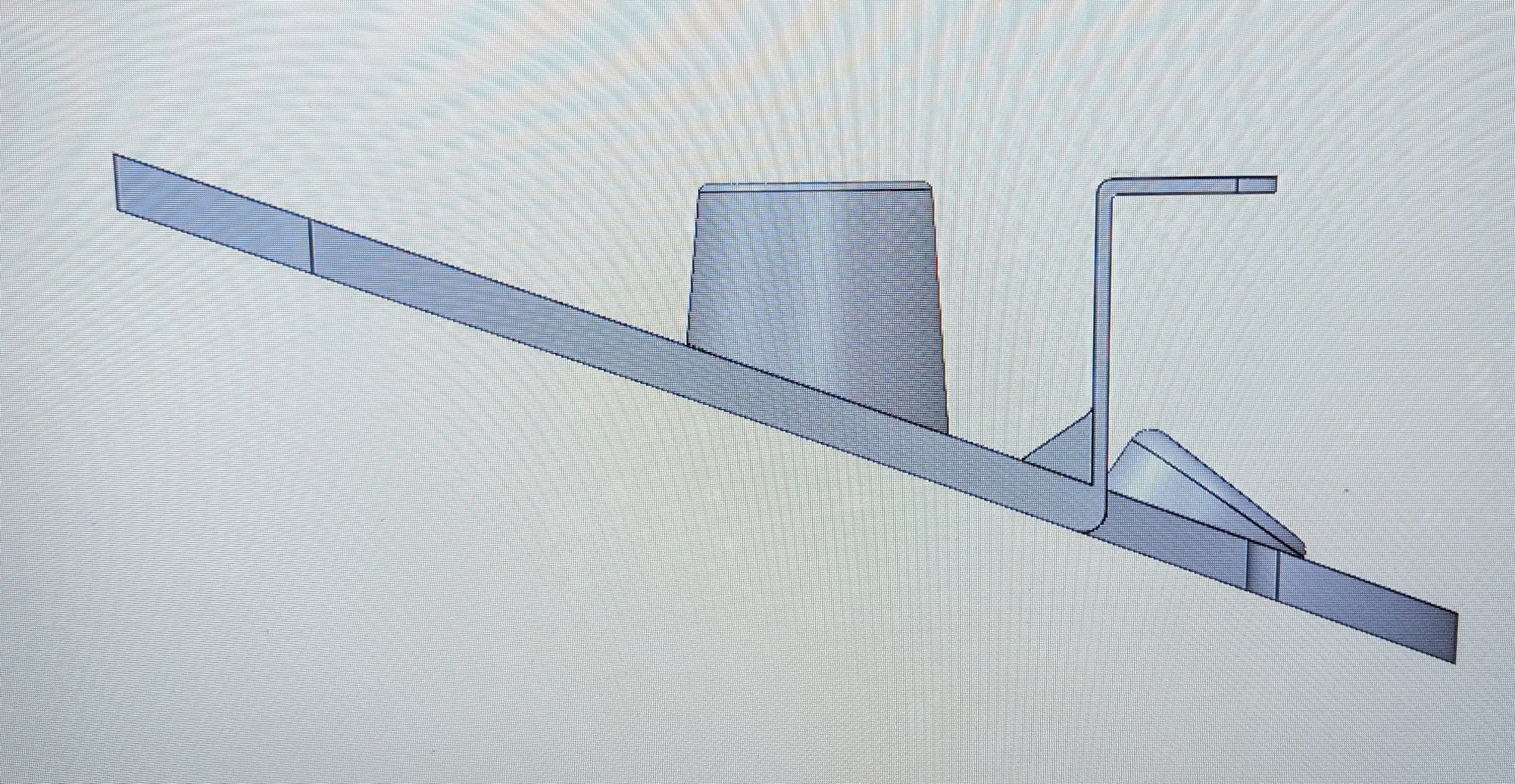

That's this bracket finished, I am going to run the test print off tonight and see how it fits tomorrow.

I dont have a laser scanner at the moment so this was done the old fashioned way, micrometers, calipers, and angle finder and engineers rulers

Thanks for the info, the 111aa number is the foam part number for that side as shown in my previous picture. Left hand is 8110-aa and 8111-aa is right handed foam.
