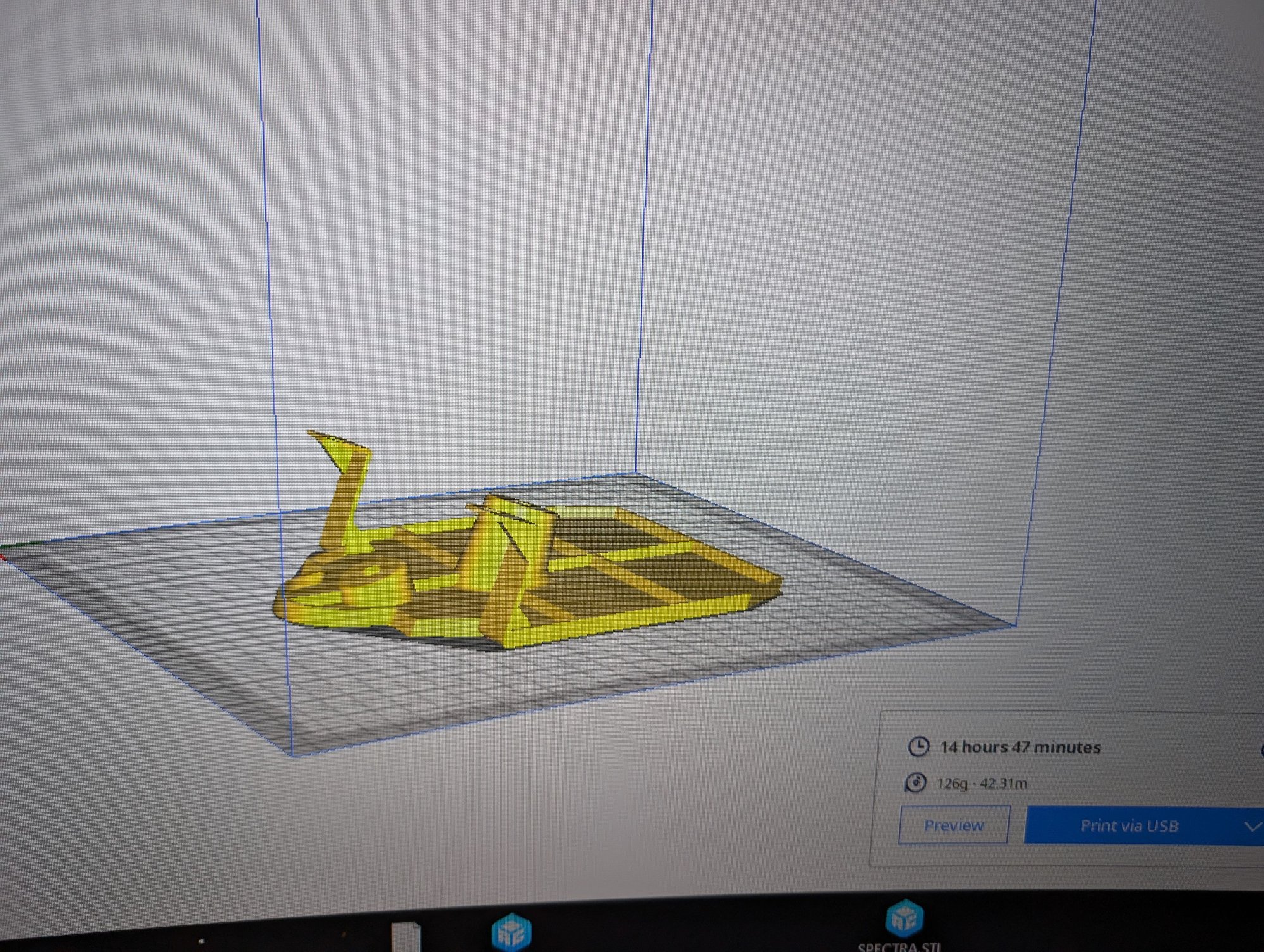

Tonight's the night!! The first print is running, 14 hours to go....
I am hoping all goes well if not at least I have something to check and adjust the printer against.
Going to be up and down tonight checking it over...
I really hope this goes well. I will update again once I have something to show. This print is the Pla-cf filament.

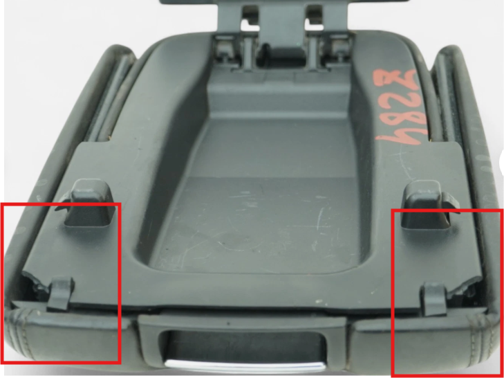

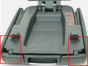

I'm hoping to talk you into printing the plastic cover under the armrest next.
There are maybe a dozen entire armrests for sale on ebay.
Every single one has these corners broken off which is indicative of the latch mechanism being toast.
I'd guess you'd make a killing on this as a side gig on ebay.

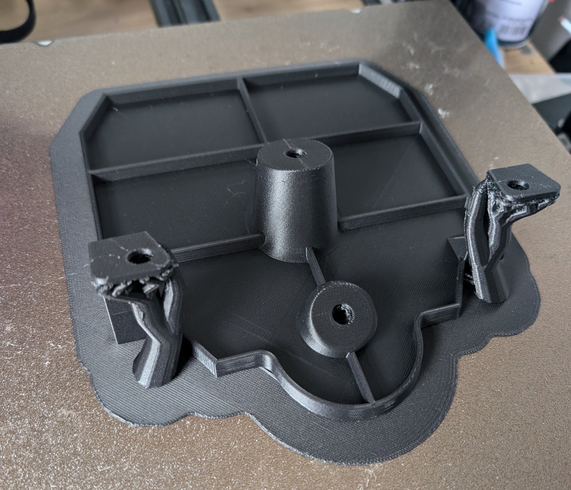

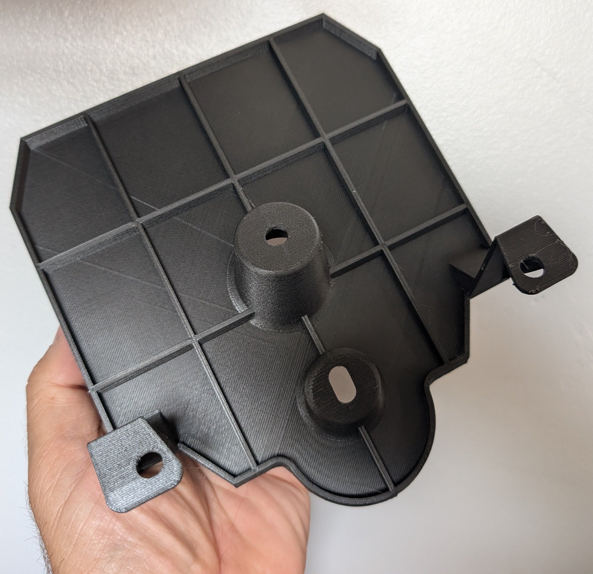

Left the print running overnight and checked on it this morning. All finished and it looks ok. I am going to strengthen the two arms a little and re- run it today. Will test fit it shortly.

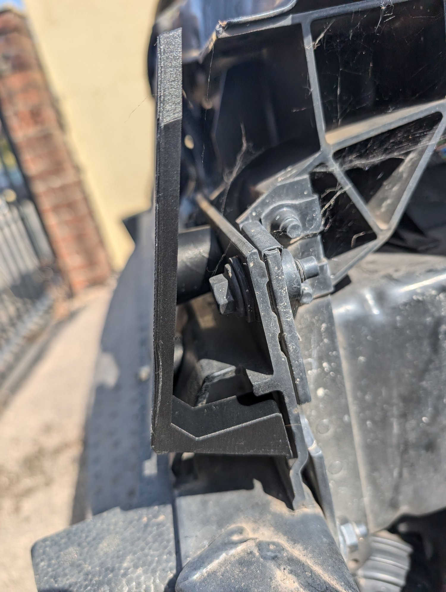

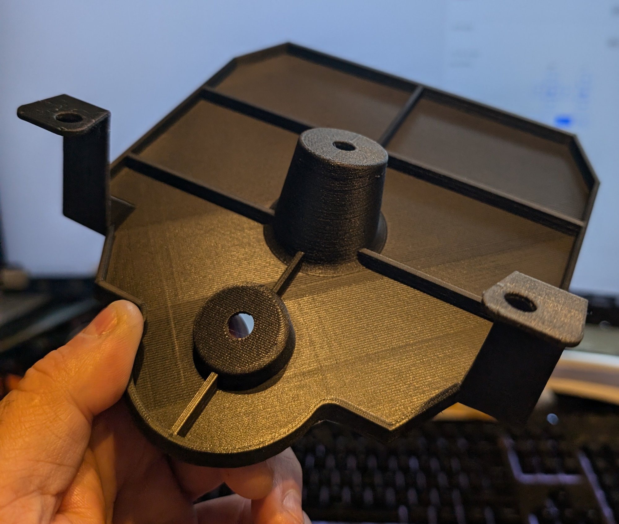

The small angles mount next to my thumb needed revising and the angle adjusting as this hole didnt line up it was around a half the diameter off center to the hole on the frame. I have adjusted it and the new one is printing at the moment, i also included the two ribs i forgot and also the base fillet radius at the modified lower mount, the arma are now reinforced also, I will check that tomorrow and if its good print the other one.
The original is Polypropylene with 20% talc so I will order some Polypropylene plain and with carbon fibre filament as its not expensive from Amazon it has a dimensional accuracy of +/- 0.03mm so it will be good enough for part prints.

Not a happy bunny tonight, just went to check the print and it had errored out two thirds of the way through and I couldn't continue the print.
Cleaned the build plate and set it off again. Grrrrrrr.

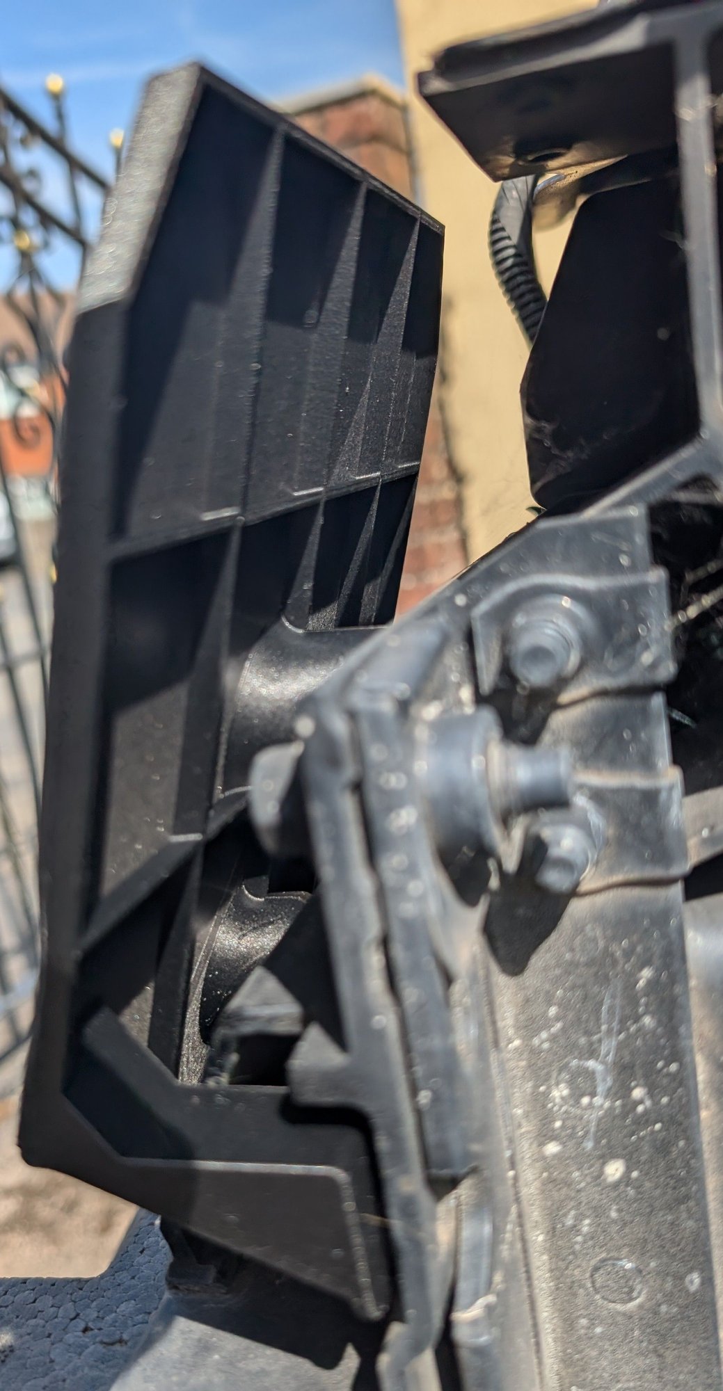

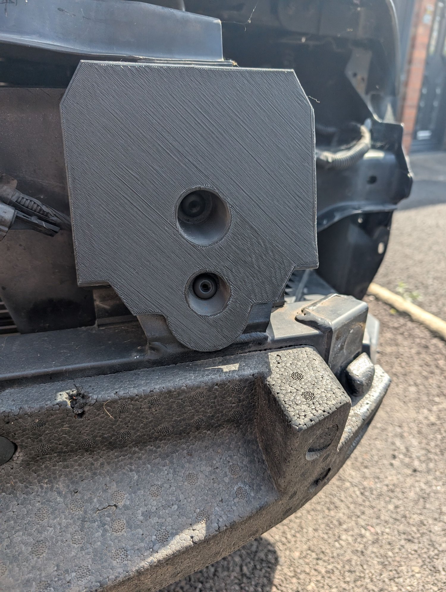

Print just finished, no issues and it fitted first time.
I need to find tune the printer nozzle distance to the build plate today and try a brim print method instead of the raft type to get a better initial surface finish. Other than that all is good.
The arms have been reinforced with a full length rib also.
My new filament arrives tomorrow so I will run the final two off then.

So I will run two of these in polypropylene tomorrow then fit them on the car ready for the nose cone.
All is good I am just a fussy old engineer!!
