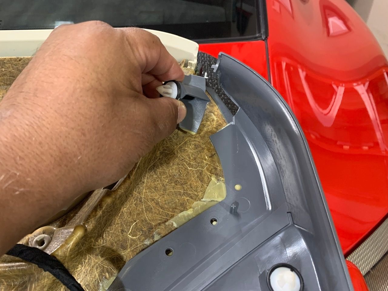

I’ve been having a rattle inside my driver door that’s been getting worse ever since I acquired my car a few months back. Finally decided to take the inner door panel off and have a look. I read up on a couple of good DIY go-bys on this forum as well as the relevant shop manual pages. I’ve removed similar panels on multiple other cars previously and have a full complement of plastic pry tools, etc., so I wasn’t expecting too much of a hassle. I figured I might break a few clips so I ordered a few replacement ones to be safe.
Well I was unprepared for just how brittle the plastic of the door was, and did not expect that the door panel was actually multiple separate pieces glued together with some sort of epoxy that was itself brittle and perished! I ended up with 4 pieces - the main door panel, a separate glued piece towards the front that itself broke in two, and another glued piece running along the top of the door panel. It’s honestly not a great design, because each of these subpanels have a set of clips that attach to the main door, so as the glue ages you end up breaking the bond between the panels rather than prising the whole assembly off the door in one piece.
Strangely enough none of the actual clips broke!
So the last couple of days have been spent painstakingly reassembling the door panel with a mix of superglue, plastic epoxy, and “dum dum” putty depending on the location. Finally got it all done and popped back in place - fortunately it all looks fine. I never did find a “smoking gun” that would’ve caused the rattle, so I applied dum dum in a few strategic locations and called it good.
On a short drive afterwards, the rattle seems to be better, but time will tell…
Edit: after further drives, the noise is still there, but muffled. It's the auditory equivalent of touch up paint - the anomaly can still be detected especially if you know it's there, but the impact is lessened so if you don't know it's there you may not detect it. Hopefully it doesn't get worse from here.
A few pics:
The panel in process of being re-glued showing the two main separate sub-panels outlined in blue, and how each of these have clip locations outlined in green.
The forward panel showing how it had separated due to aged glue, and also how the plastic itself cracked in two in one location.
Dum dum applied to a few locations that might have been the cause of the rattle.

Hans, "crackling" could indeed be a description of the rattle noise I was hearing. It was definitely a sharp "plasticky" noise and not a mechanical sounding rattle. As I stated, inside the door panel I couldn't find one specific obvious source of the noise, but instead there were several possible candidate locations that I attempted to dampen with the dum dum putty. (Which, BTW is a type of non-hardening caulk that is great for this sort of thing - highly recommended that all have a supply of this stuff on hand!)
Regarding the cost, it's hard to evaluate dealer costs vs. DIY if you have to put a value on your own time. It must have taken me the best part of 2-1/2 days to carefully repair and re-assemble the door. If I put a value on my time of $200/hour (as I would have to pay at a Jaguar dealership) then you can see the costs rapidly spiraling up. Buying a "ready to go" panel from Jaguar would have cut my labor time way back.

Sean, I do remember. I did not intentionally separate the pieces of the door panel (door card) - they basically fell apart as I was prising off the panel from the door shell. There are clips that hold the panel / card to the shell all around the circumference. Along the bottom and front/back sides these are plastic male pins on the panel that fit into round holes in the shell - along the top they are metal clips on the shell that fit into elongated slots on the panel / card. The point is that these various pins and slots on the panel are not all on a single piece - instead there are 3 pieces that are glued together. So when I tried to remove the panel as one entity, basically the large bottom part came unglued from the top and forward parts that remained clipped to the door shell. I had to prise these off separately and then glue them all together again before clipping back to the door shell.
i hope this helps.
