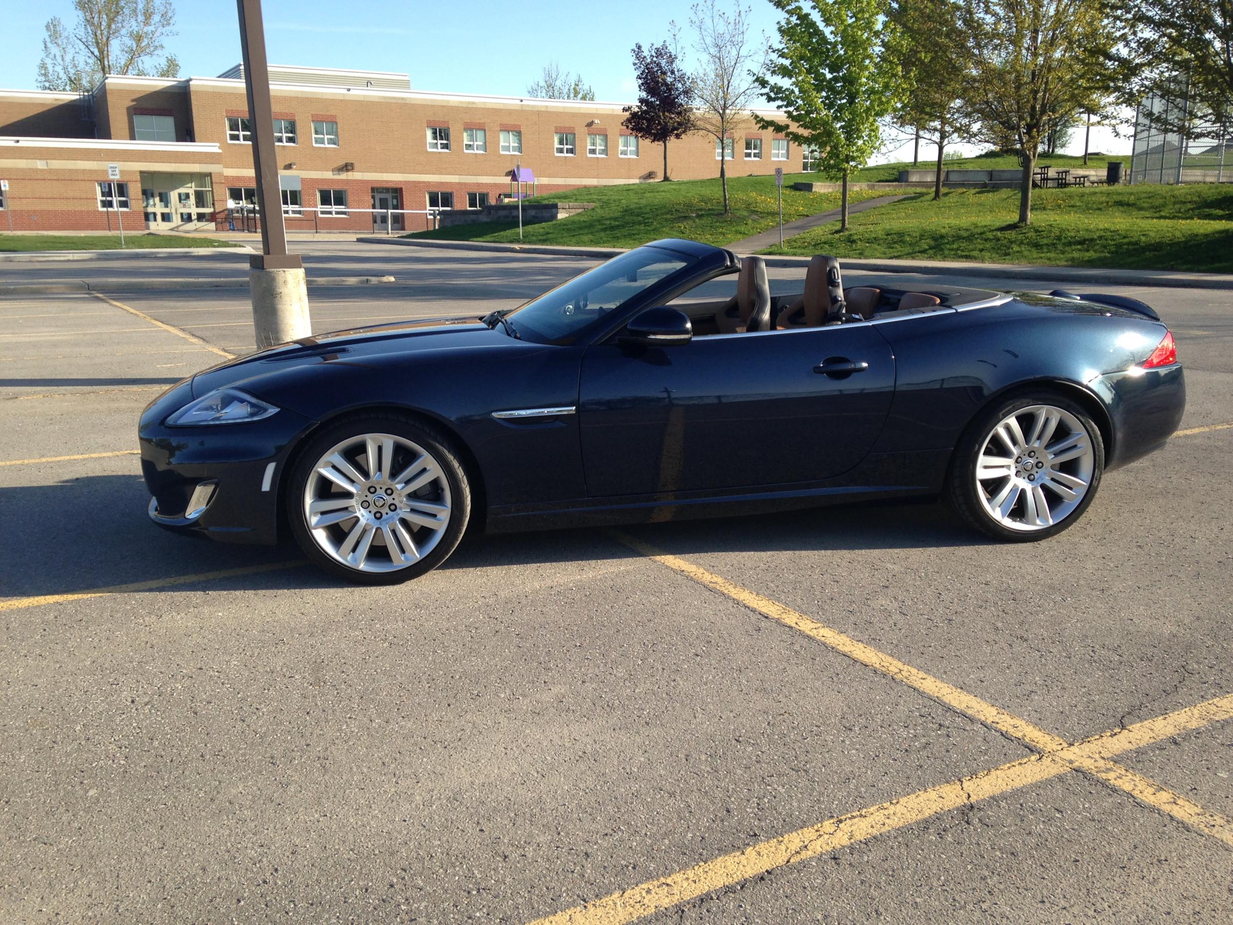

My dealer in Toronto installed mine for $90. Surprised they are trying to hose you THAT badly. Maybe try another dealer?
End result well worth it!
