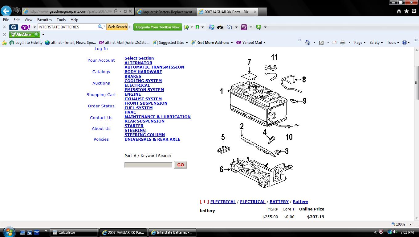

The jpg below came from INTERSTATE BATTERIES site, so I assume they mean what they say about your Mega-Tron Plus battery.
Second jpg is off the Gaudin Jaguar site. Seems a reasonable price for a battery IF you didn't have to ship it.
