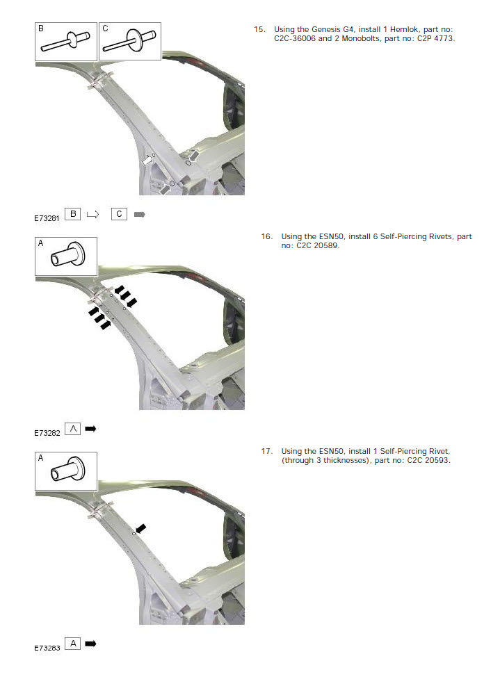

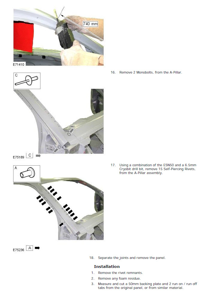

Here is the repair procedure for the Outside A Pillar Panel.
I assume your tech has the Jaguar approved repair tools? They recommend either an ENS50 self piercing rivet gun (about $7500 USD) or the much cheaper Avdel Genesis nG4. If you need one of these tools, I have the Avdel Genesis nG4 rivet gun that I purchased to repair my car and am now willing to sell.
Good luck with the repairs

Hi! Thanks for sending repair procedure and photos through - much appreciated and certainly saved me tonnes of headache. My A Pillar Post has a hairline crack and I'm making a case for weld repair which is common sense. My repair certifier is insisting on taking it to an authorised Jag repairer who in turn insists on using brand new parts only (pointless in repairing in that case). As for the rivet gun, how much are you looking at getting for it? My independent panel shop says they can source it locally but wouldnt mind knowing my 2nd option as a backup?
