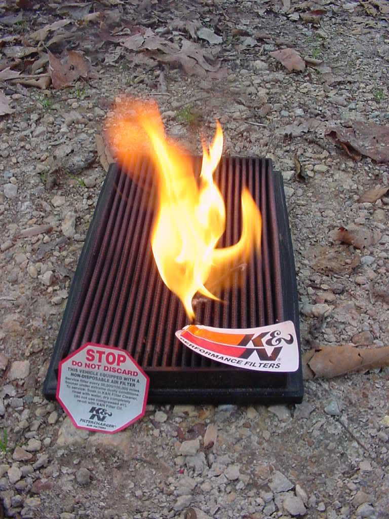

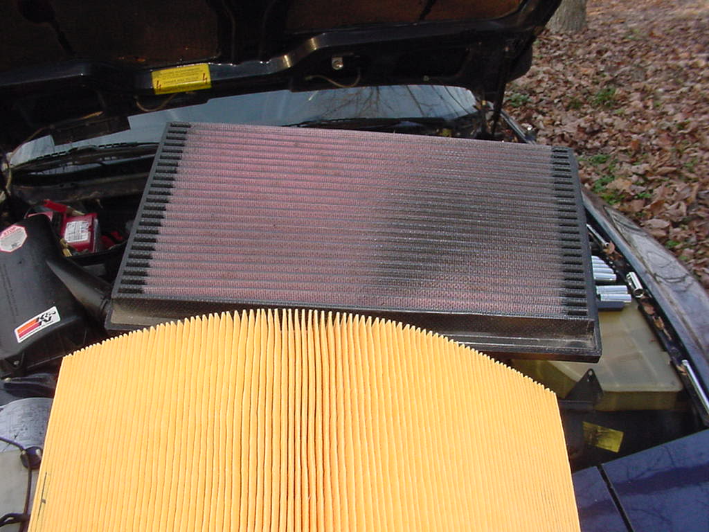

"DO NOT WASTE YOUR MONEY on a fancy race-boy AIR FILTER and think for one minute you are increasing the performance of the car. It is a total waste of money and you run the risk of the oil needed to make the K&N work half way good on your MAF system, causing so many problems in some of the Porsche cars, that the REPUTABLE and HONEST top-of-the-line vendors quit selling them (they were causing all kinds of problems with the MAF system).
I speak from experience, having wasted my own money, and having experienced the problems. Therefore I burned mine I was so disgusted.
I found the paper filter to work just fine, note how many long additional filter square inches of pleats the paper filter actually has. K&N claims a square inch of their filter flows more air and it does, with more dirt too. However, if you add up the additional filter area of the paper filter, you get the same amount of air passing into the motor and a heck of a lot better filtration.
Unfortunately I bought two of these filters for two of my 3 Porsche cars, before I got the message from Wally Plumley, ex NASA engineer and present day Porsche 928 expert. I'm just trying to pass it on, because I think the K&N is a rip-off and I do not condone their marketing message. On race engines that have been punched up to double their original horsepower, then yes that may be a situation where the original equipment air box and filter system is challenged, but certainly not on a stock or near stock automobile.
Technically there may be a nano-bit of additional horses on some motors, but this is hardly a performance enhancement. If the K&N marketing still has you as a believer, then go ahead and BUY ONE, it is your money, your decison, and your car.................and then when you do buy one, place a little dab of grease or something inside your air box to see what it catches by getting through the fancy filter you just bought."
