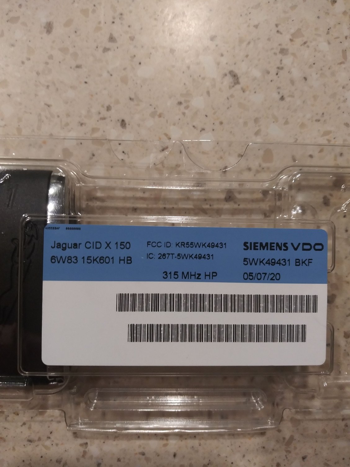

Not sure if the attached will help anyone else in the future in terms of part numbers. Yesterday i had a new fob programmed and the whole process of divorcing my current fob and re-programming took 15 minutes, i went to a JLR Indy shop (Bacchus British) in Dublin, CA. Excellent service.
For reference my XKR is a very early 07...
