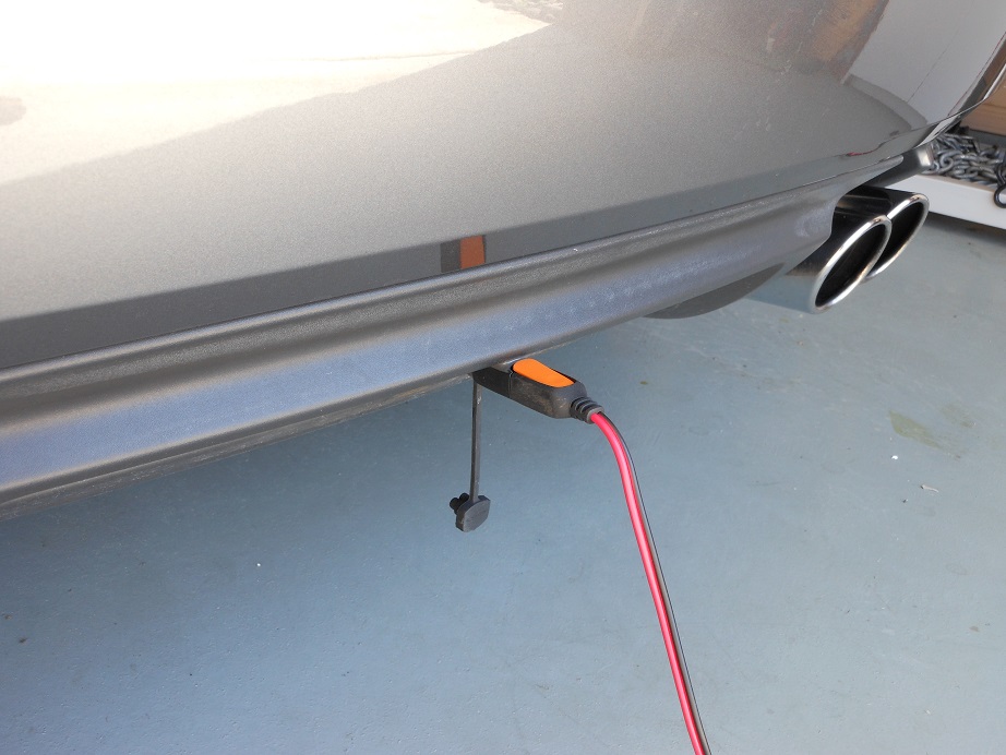

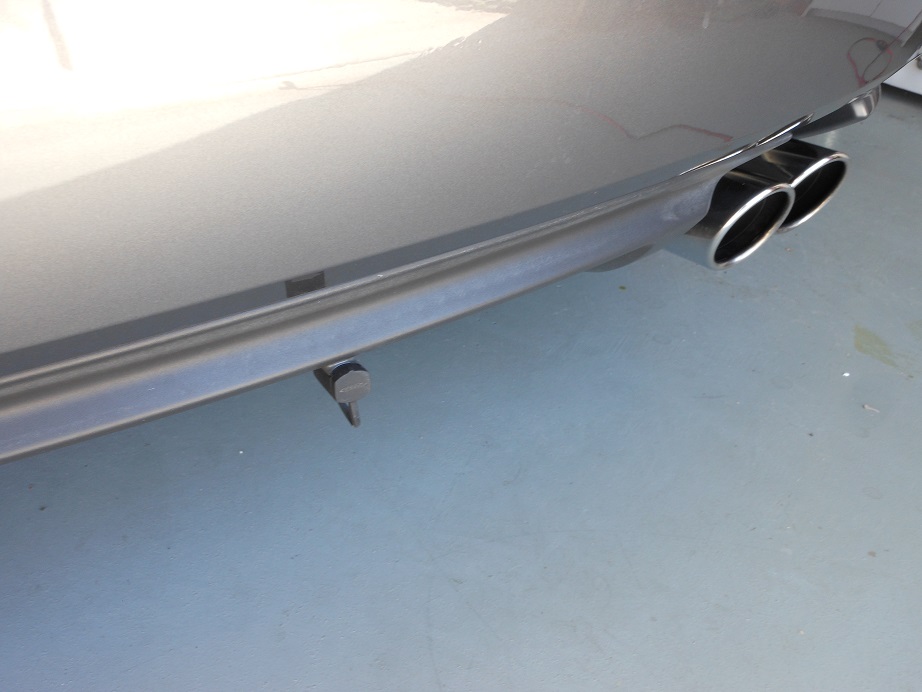

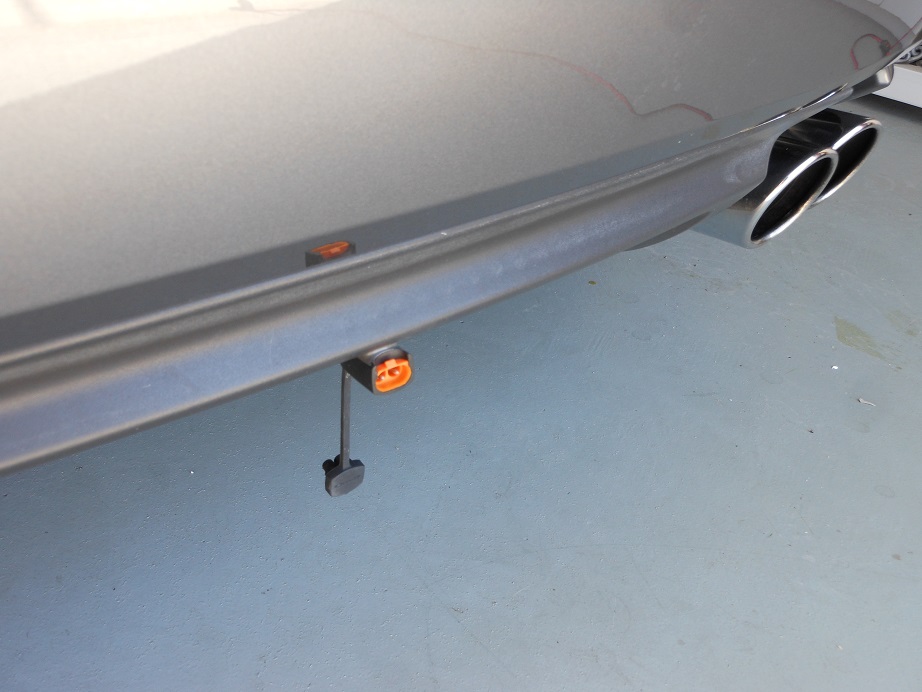

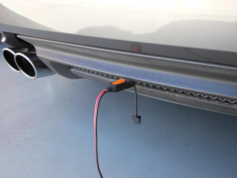

It costs around $70 to buy a Ctek charger and a Ctek comfort cord. It takes no more than 15 minutes to install the comfort cord in your XK. then you plug in the battery tender/charger just like a lamp or any low wattage appliance.
After installation it takes maybe 10-20 seconds to hook up or unplug the Ctek. That's what I did and do, and I have NEVER had an issue. Sometimes one has to make an allowance to get what one wants. So, if you want to drive an XK or an XKR (2010-2015 MY) make that allowance, it is a small price to pay for great enjoyment.
Easy connection to the battery inside the trunk and easy to connect without even opening the trunk lid. Takes 5-10 seconds to connect as mentioned. CTEK is a fast connect plug.
The images below is the set up on my 2009 XKR Portfolio Edition.
Click image once to enlarge, click again for full screen.
